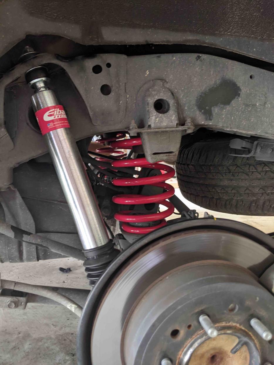

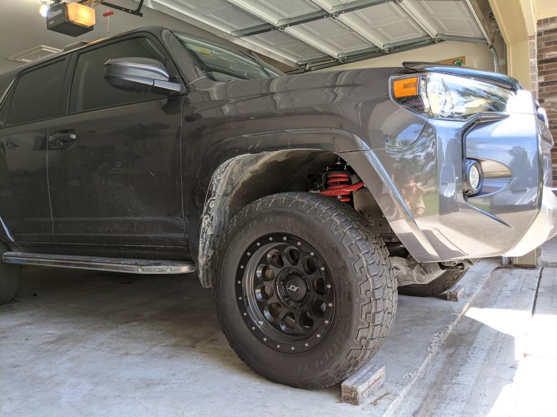

Well, I got everything installed over the weekend. Thanks, Mike for all the help and communication!
UCA: JBA UCAs
Shocks: Eibach Pro
Coils: Dobinsons C59-302 & C59-505

Looks good man!! Let us know how the ride quality is with those Eibach's. I haven't seen much feedback on that combo you're running yet.

Hey, another Eibach/dobinsons guy! How do you like it? Yours looks a bit taller in the front than mine. I went with 302/325’s.
I've got a very similar setup to you (302 w/725 rear coil) and I feel the same way - I think it's really just the height you gain with the x25 rear coils vs the 505's. My front measurements are right around the 2.5" but I gained 2.25" in the rear - so no rake lost.
Thinking I'll be raising my front end up to about 3/3.25" when I get a free weekend day (perks of the IMS shocks).
Anyone run 302's with 599's (1"-1.25") on the back? Of the pictures I've seen with the 302/505 combo, its too much rake for my liking. My vehicle has no extra weight.
Many guys are. For minimal rake, that setup would work well.
