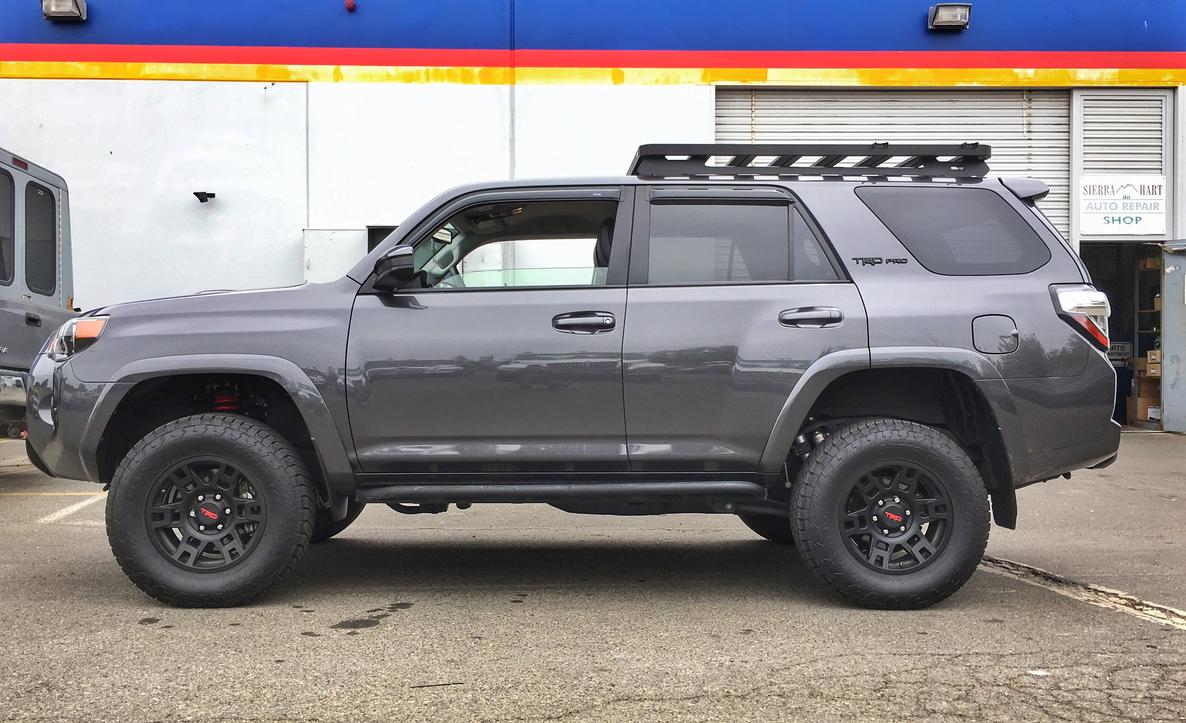

Hey guys. Got my stuff installed this morning. In a hurry at the moment (on my way to a beer Olympics haha) but I wanted to give some quick photos. I'll post more with before and after measurements tomorrow.
Just install C59-505 - Stock rear end load, 1.25 to 1.5" lift. 405/405mm, 17mm wire, 220LB **NEW COIL** with Toytec 2" front lift kit for TRD PRO. I'll take another picture once the coils are settled and once I get my new tires. Overall the the coils rides really well.

Just install C59-505 - Stock rear end load, 1.25 to 1.5" lift. 405/405mm, 17mm wire, 220LB **NEW COIL** with Toytec 2" lift kit for TRD PRO. I'll take another picture once the coils are settled and once I get my new tires. Overall the the coils rides really well.
Nice bro! I was debating on putting the Toytec 2" for a while. Since I put SSO bumper and wrinch, I've lost .25". But I just recently purchased RRT and awning. I hope it will level out if I put the 2" Toytec.

Not sure if you've done this or not, but having gone through numerous iterations of suspension on different vehicles I'd recommend weighing your gear and added vehicle weight to determine what kind of loaded/unloaded weight you're carrying. This will help vendors get you the correct coil for your build.
Just to make sure I'm understating this correctly, these pictures are showing your truck with effectively about 3.25-3.5" of lift? Or am I adding numbers when I shouldn't be...

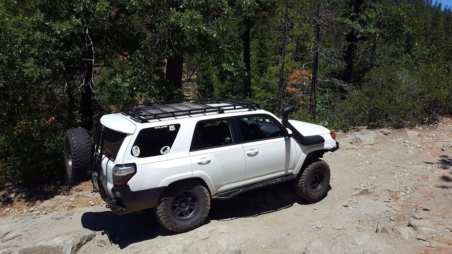

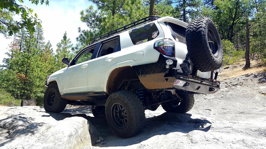

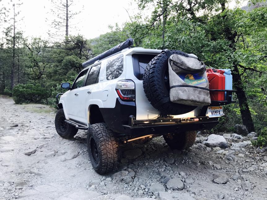

I struck up a conversation with the guys at the Dobinsons booth at Overland Expo West and talked to them about some rear springs. I had the Metal Tech long Travel HD springs, but they just were not holding up to all the weight, even unloaded, that my 4Runner was carrying. I went back and forth with Mike trying to decide on the right spring to carry the added weight and have the flex for the long travel rear. After some time, Mike suggested that the C59-677V should be what I need. I ordered directly through Dobinsons and they arrived quickly. Just got the new springs installed last week and tested them out yesterday.
Overall, I am very happy, the MT springs would bottom out and I would be hitting the bump stops just going down the road unloaded. The new springs were much more firm and I never hit the bump stops going down the road. They even carried some additional weight and a utility trailer (empty) with no issues. Offroad, they worked awesome. They flexed well.

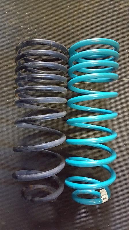

Comparison of the Metal Tech HD to the Dobinsons. Same number of coils but different spacing. The Dobinsons look like they are designed for the heavier load.
Some trail and flex pics
Sourgrass Trail

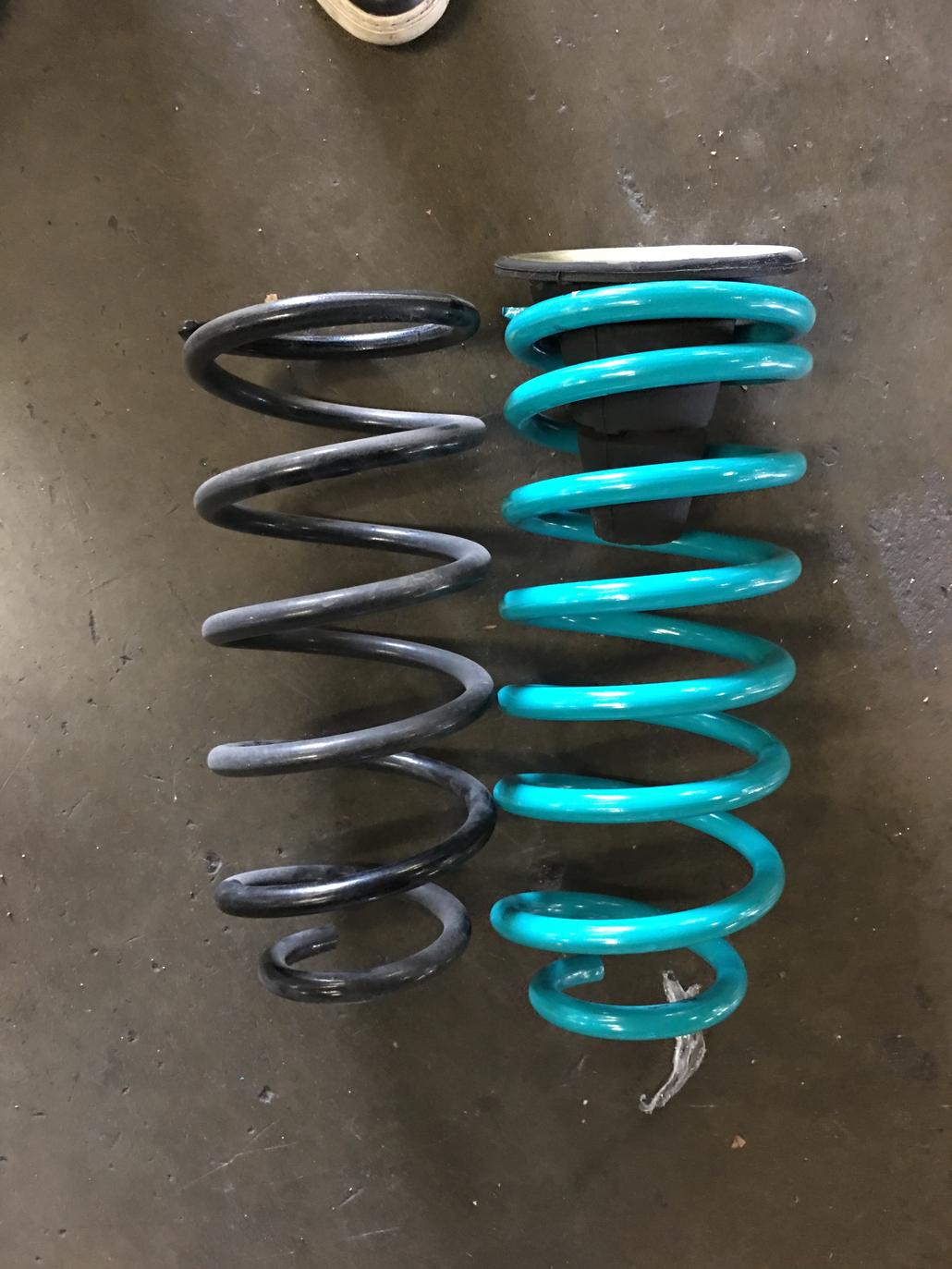

I was there two weeks ago.. looking at your rig is like looking at a mirror haha. Running Dobi rear coils too. Which spring rates are those? I had Mike order me a super heavy set for all the weight I carry, I forget the part # though. They're good for around 750lbd of cargo.

Nice. I am always up the Hwy. 4 corridor. Still waiting for the high sierra to thaw out. Feel free to hit me up if you're up there.
I believe the springs I have are the spring rate below yours.
