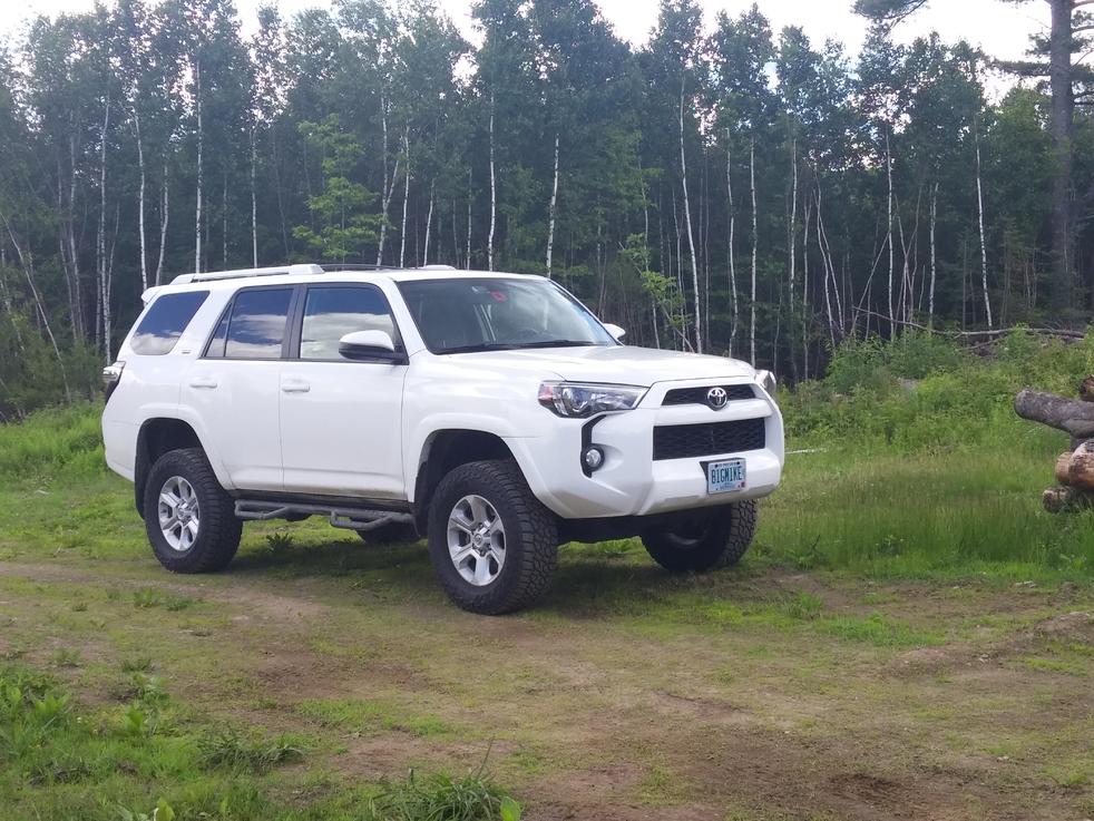

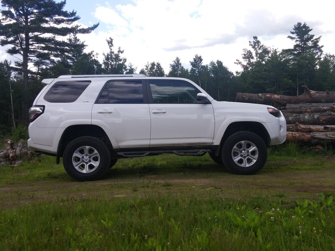

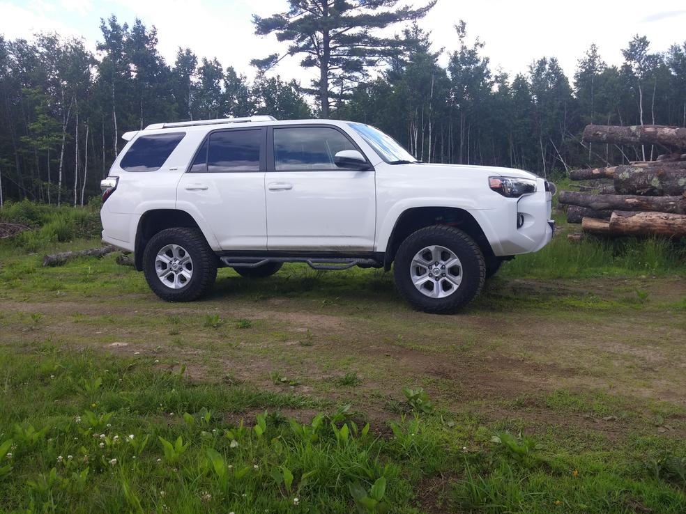

After a busy boat selling season, I was finally able to get out in the woods and get some pictures. I have had this suspension installed for about 4 months now with roughly 5000 miles on it, and I have to say I am loving it. I travel 45 miles a day, six days a week, on an interstate where the average speed is 80 MPH. This suspension set-up rides like stock but takes out some of the nose dive, and handles corners much better. I can now weave in and out of the traffic with out the body rolling as much. My only regret is not going with the 3 inch coil for the front. Not sure exactly how much lift I got from the 302 because I forgot to measure before the install. If any of you have stock measurements from an SR5 maybe you can tell me. From the center of the hub to the bottom of the fender I get about 22.5 inches on the front on both driver and passenger side. The rear is kind of strange with 24.5 on the drivers side and 24.25 on the Passenger side. Would have though that would be reversed with no trim packer.

It's looking good. Within 1/4" (from memory) is within factory spec for left to right variance. My driver's side is also taller than the passenger side. I haven't done the "trick the KDSS system" trick yet to get the piston to retract a little on the driver's side.

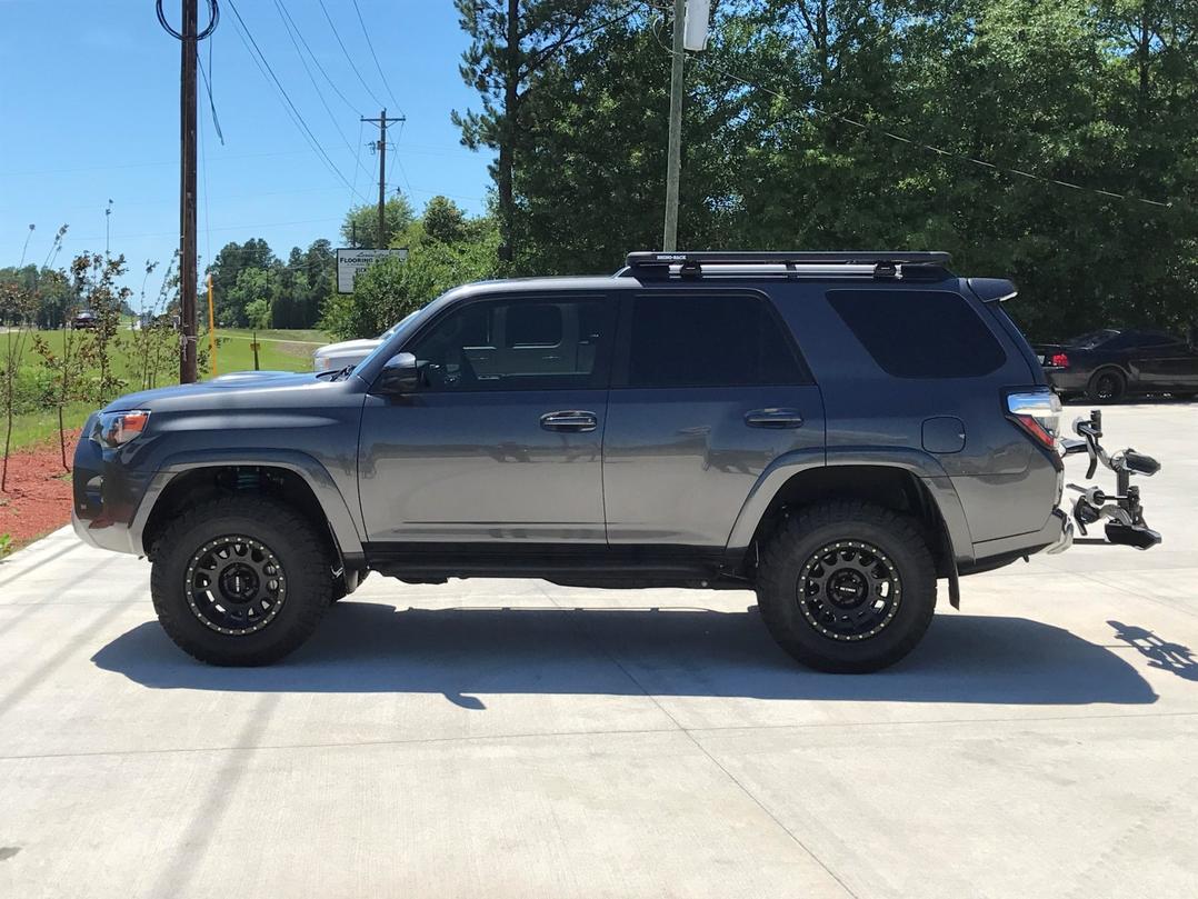

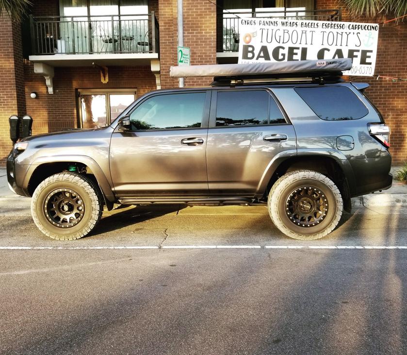

I just received these photos from a customer today.
He has C59-300 on the front and C59-599 on the rear.
