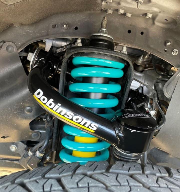

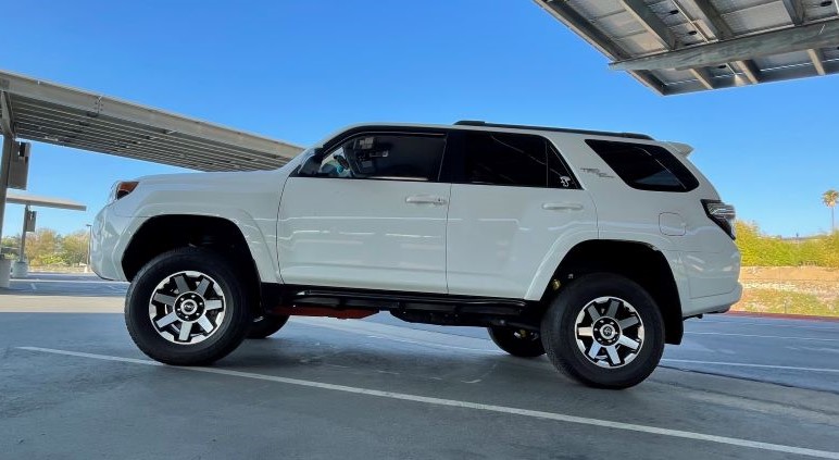

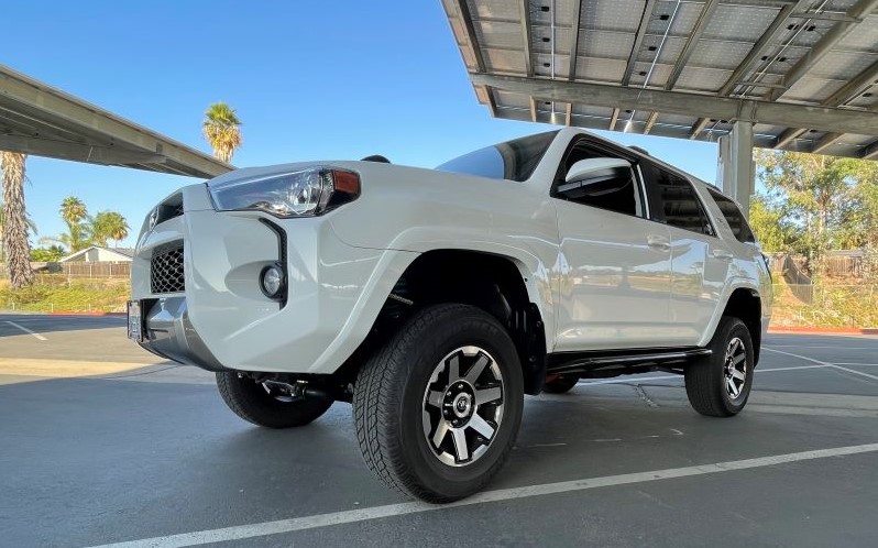

Dobinson kit installed
Front
C59-354 coils
GS59-700 struts
Treaty oak spacer
Dobinson UCA's
Rear
C59-329 coils
GS59-701 shocks
Treaty oak spacers
Tires are 265/70R17's, planning on going up to 275's, I think.
Even without the requisite weight this setup is rated for, the ride is very comfortable. Skids and sliders already installed. Planning on a full bumper/winch up front and victory rear bumper with rago fab shelf, gear plate and various gear bags in the rear.
Can't say enough about Mike's customer service answering all my questions and the quick shipping.
