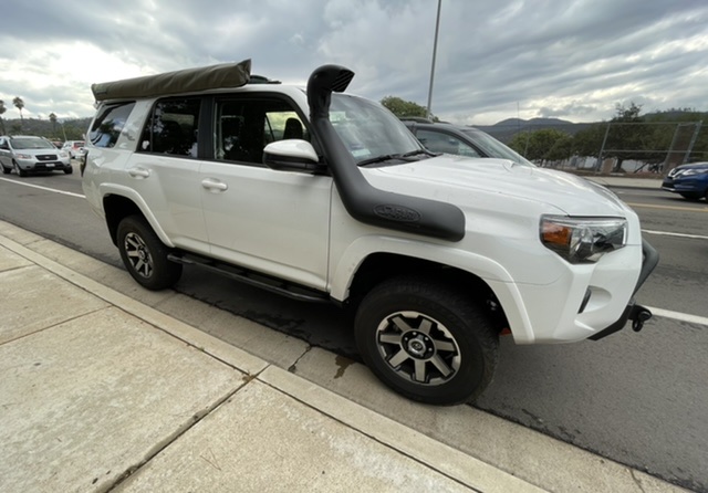

Logged a good amount of break-in miles on my setup so far. (Specs posted in post 2953)
Loving the ride quality with winch/bumper up front. Not much constant weight in the rear yet but even “unloaded”, it’s very comfy.
Going to be slinging some BFG KO2’s on it soon.

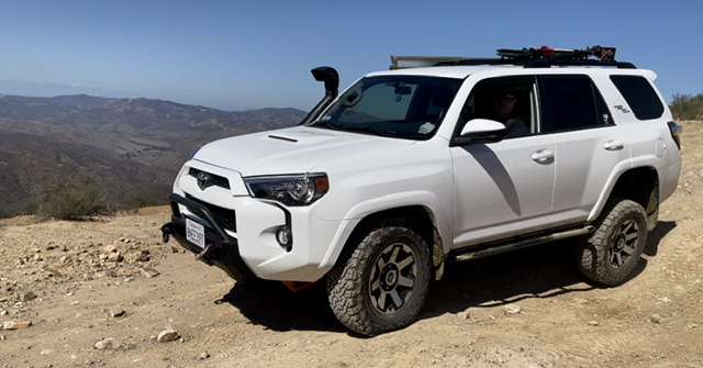

:) First trail ride was a success. Got some really nice flex out of the rear. Also the front with proper weight added was uber comfy. Rear was a bit chattery over corrugations, but once we add a couple hundred more lbs/kg, it’ll be golden.
