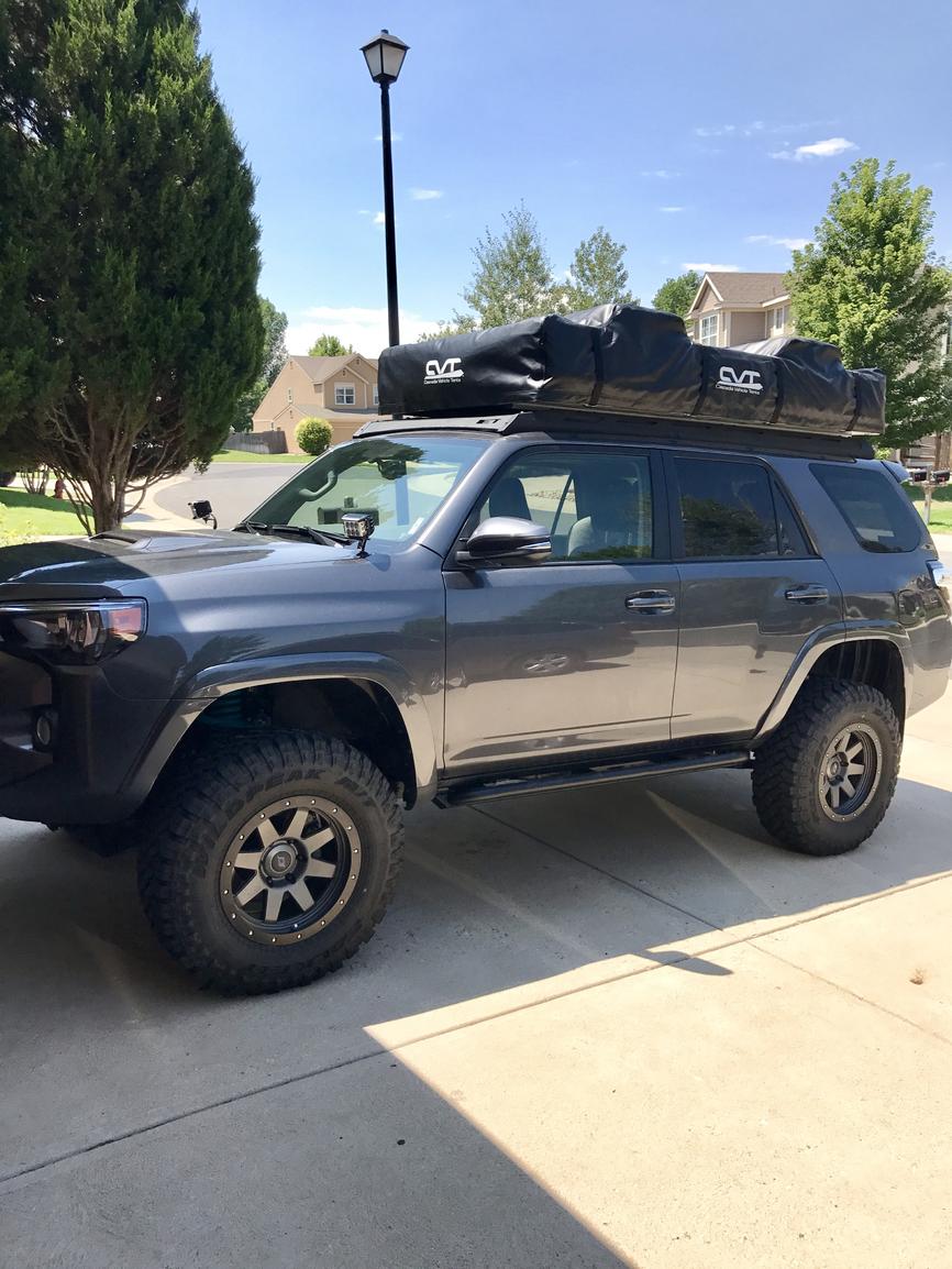

Still loving my Dobinsons set up!! No complaints at all.

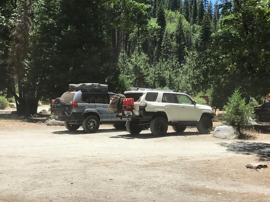

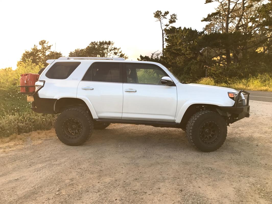

So I don't have a shot of it fully loaded, my brother needed my tent and my fridge broke so the last trip I took was with a cooler and a cot+awning combo. This is a good 250lbs lighter than my normal trip load but it hardly sagged.
My "unloaded" weight is the armor, two full fuel cans, and a minimally stocked fridge; with this the springs maintain a good forward rake which I prefer. Without the fuel cans and fridge the rear sits very high.
For reference, the GX in the background is on the same size tires (285/70/17) with OME mediums. He's got a small drawer system in back but otherwise minimal gear inside. Other shot is unloaded.
I do still have the 677V's if anyone wants to buy them off me for a fair price, they're sitting in my garage collecting dust.
