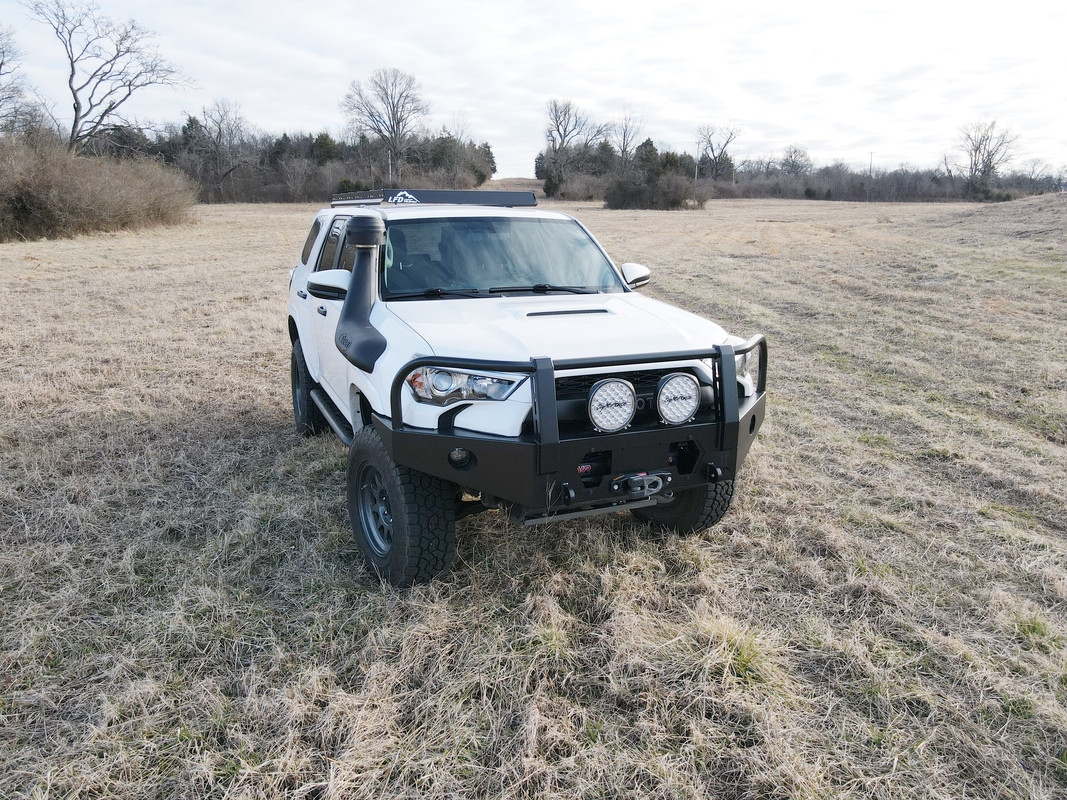

I just wanted to say I appreciate Mike's responses and information available on this forum. It helped my in my decision to refresh my 2011 4Runner Limited 4WD with new suspension/wheels/tires. It completely transformed my 4R in terms of handling and comfort. No more brake nose diving, much more controlled over large bumps/uneven terrain, and it still retains near factory level comfort when cruising around. Looks better too! I'm very happy and recommend Dobinsons/Exit Offroad/Mike to anyone, especially if you're debating switching out your XREAS.
I used 300 coils front, 599 coils rear. I have third row seat option, there is still a slight rake (rear slightly higher than front). We were able to get all alignment in green (within spec) and it drives perfect. Toyo AT3 265/70/17 tires installed at the moment. Identical matching tire/wheel fits in spare tire area perfectly. The stock tire size gives me good MPG (around 20-22 highway), and good acceleration due to the tire/wheel combo being about 7 pounds LIGHTER (per wheel/tire) than stock. (Toyo at3 this size/rating weighs 39lbs, wheel weighs 24lbs). Good MPGs, good city driving performance (acceleration/braking), more than enough traction for my needs. I'm happy.

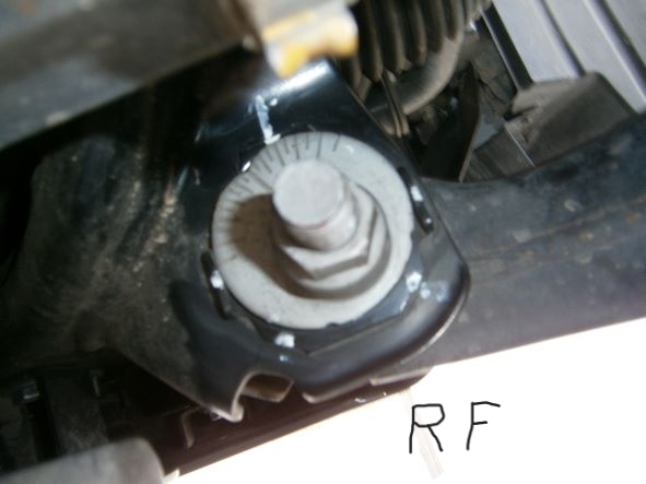

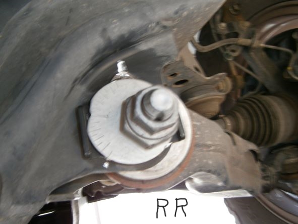

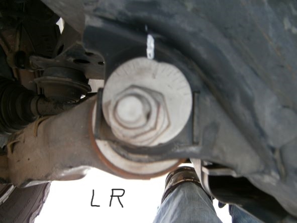

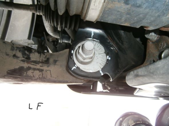

A while back I wrote on the forum about lifting a 2011 4runner SR5 1.5 inches using Dobinsons springs and shocks purchased from Mike (#3047). The tires are stock size and I planned to keep them that way. I listed the alignment numbers for caster and they were less than 0.5 degrees. I did not think the alignment shop knew what they were doing for lifted vehicles. I asked around and found another shop that people sent their lifted vehicles to and had that shop do an alignment.
The before numbers: min factory max
L 1.8 caster R 1.3 2.9 4.4
L 1.3 camber R 1.1 -1.3 0.2
L 0.85 toe R 1.10 0.0 0.1
After:
L 1.9 caster R 2.3
L -0.1 camber R -0.1
L 0.1 toe R 0.1
I took the vehicle out for a drive and when I was on the South side of the road the vehicle pulled to the left. When I went North the vehicle pulled right. I had to keep positive pressure on the steering wheel to go straight. I went a talked to the alignment person and he said that if I brought it in he would take a look at it. I mentioned that I was thinking of putting in after market upper control arms (UCAs) due to the low caster numbers. He said not to do that since that would cause a whole bunch of other headaches for trying to align the vehicle. He also mentioned that since the vehicle was lifted he would not be able to get factory caster. Even though this shop was supposed to know how to align lifted vehicles his statement about upper control arms set off a red flag. This made me think that I was going to have trouble finding a good alignment shop. I was going down the same trail that others have gone on the forum. I felt I needed more caster than what was provided and I had to find a shop to do a good alignment. I put on SPC upper control arms. After installing those set at the zero setting I looked at the tires and noticed the camber was not good. I set the camber bolts for neutral/zero degrees camber. I took a level and put it on the tire and leveled it vertically with the adjustable ball joint. I figured toe would be out, though I did not want to adjust that before the alignment shop. I found a shop that was supposed to do good alignments on lifted vehicles about 50 miles away. It was a cold try. I did not have any referrals for trying the shop other than they said they do lifted vehicles the same as the second shop. Since it was a more populous town I decided to try it. I was a little concerned about driving that far without alignment. The T4R steering wheel was tilted to the right though it did not drive terrible.
The before alignment
L 4.5 caster R 4.0
L 0.5 camber R 0.3
L -0.75 toe R 0.0
I was surprised how close just putting in the UCAs and adjusting a little the numbers came out. That was providence.
The after numbers:
L 3.8 caster R 4.2
L -0.4 camber R -0.4
L 0.05 toe R 0.05
The alignment tech wanted to adjust for road crown. I asked the tech why he went with the caster at ~4.0 and he said it was better. I requested about 3.2-3.5. The tech took the vehicle out for a road test a couple times. The drive home after alignment was uneventful. The vehicle seems to steer well. I wanted close to factory specs due to the possibility of towing and did not want to deal with unknown floaty steering. So for a summation the T4R rides a little stiffer after the lift which is good. It is not as spongy. It took three tries to get a good alignment and more money than expected, though I got there. Since on the forum I read one did not need to do UCAs and I was not planning on it to save money, UCAs I think will be a good choice as time goes by. So try to check out shops as well as possible asking anyone you know and look for trucks at the shop. The last shop had trucks going there and was word of mouth recommended, though 50 miles away. If I had known UCAs would have helped I might have initially lifted 2 inches (maybe not either since I was concerned about cv axle wear and other suspension components). My off roading is going to be Moab, some Telluride trails, not looking at a rock crawler. This is a daily driver. Hopefully all this helps someone. I have included pictures of the camber bolt settings.
If someone wants to answer I do have questions about the camber bolt settings. I was wondering if I had set the SPCs on C setting which would provide 3 degrees of caster, instead of D setting which is 2 degrees of caster (neutral setting) if that would have brought the camber bolt setting back from being maxed out? Could the alignment guy have adjusted camber using the ball joint to help the max setting of the camber bolts? Is there an issue of wear for the camber bolts to be at almost max?
What someone might comment on is why caster of 4 is better than 3.2-3.5 numbers.
