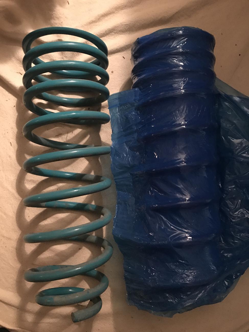

hey mike, emailed you a question last week but I'll just ask here...are the 675V rear coils side specific? Do they have a 15mm difference in height like the other coils?
Thanks!
Thanks!
Sorry man, we had some email server problems last week and a bunch didn't come through apparently. The coil tags will say LH and RH is they are side specific on them. I'll check the guide tomorrow to see if those are even or not. I'm pretty sure those are and only the KDSS coils are offset.
Edit: Those C59-675V are equal height. Each of the coils would say a LH or RH if they are side specific, and if not, they would have identical tags on them.

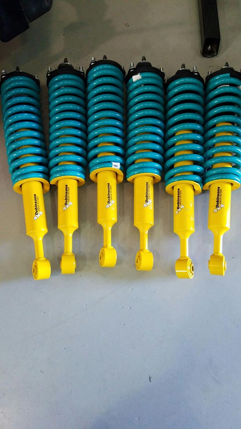

Did someone say they needed their struts assembled?? Busy morning...

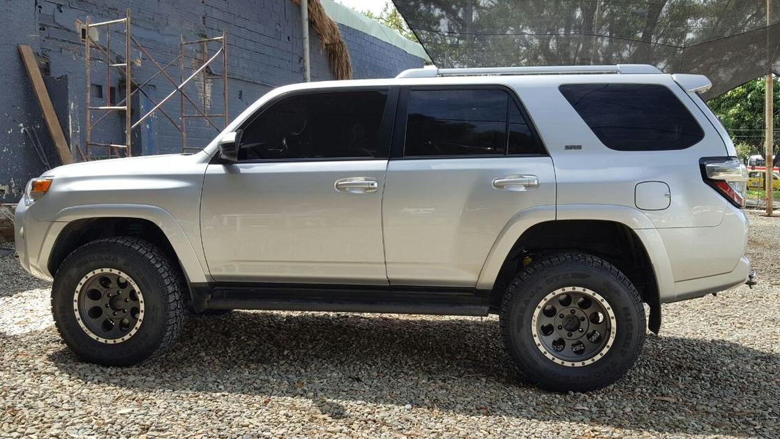

A customer from out of the country sent this in this morning.
It has these parts installed:
C59-300
GS59-700
C59-325
GS59-701
