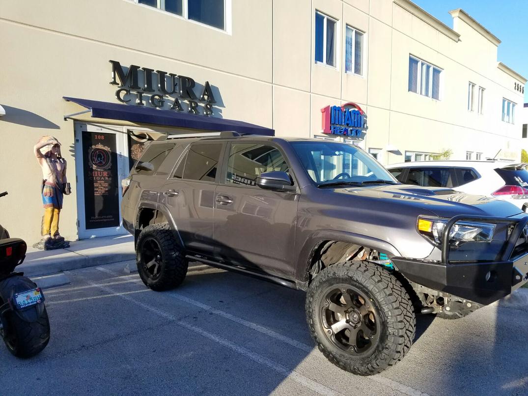

New wheels and tires are now on my KDSS Trail
Wheels are 18 x 9" Fuel Beast
Tires are 285/65R18 Nitto Ridge Grappler
