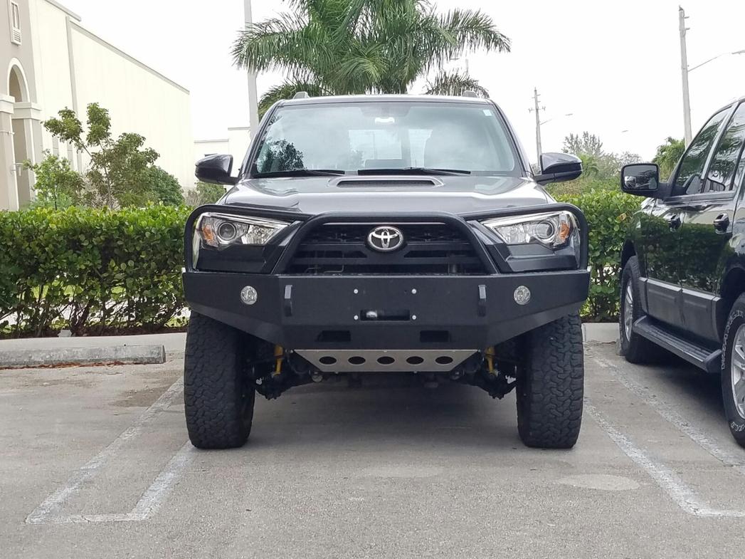

Here is a TRD Pro from Boca Raton, FL
He has these Dobinsons parts installed:
C59-314
GS59-700
C59-325
GS59-701
SC59-001 (strut caps)

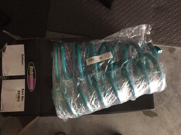

I made some changes to my own 5th gen Trail this weekend. I changed out the OME 90010 and 2887's for Dobinsons GS59-574 struts and C59-314 med/heavy load 2" coils to give 3" of lift, and a little more travel.
Doing the trick of removing the lower ball joint makes the whole process really fast, especially considering that I already had the Total Chaos UCA's installed. I had some fun wrestling around with the KDSS front sway bar, but that was to be expected.
Here's how it looks now. I'm waiting for it to settle another day or 2 before I take photos of the front to rear. I was able to remove my lean too, as the original owner had the trim packer installed on the driver side, which is incorrect.
I've only put 50 miles on it so far, but the shock valving is definitely better. The GS59-574 struts have softer valving than the 700 struts, and I can feel it a lot on the road. The suspension is now soaking up the little bumps on the road a lot better, especially on the concrete bridges and their gaps all over here in Miami. It will be a while before I can take it offroad, but the onroad handling and ride is greatly improved. Also, our 314 coils that I installed are near identical spring rate to the OME 2887 coils, but the shocks have made a big ride difference here.

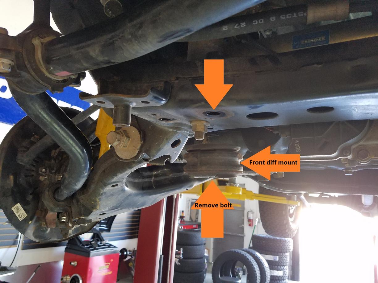

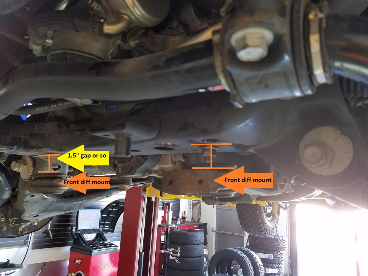

Then after that was done, another 10 mins was added to add the Dobinsons diff drop kit. I removed all my ARB skid plates before working on the suspension as I didn't plan to keep them on. Too many rattles as they weren't installed properly either and were missing some hardware. I'm looking at other skid plate options now, but will probably have a local shop make me exactly what I need to work with the KDSS and the diff drop kit.

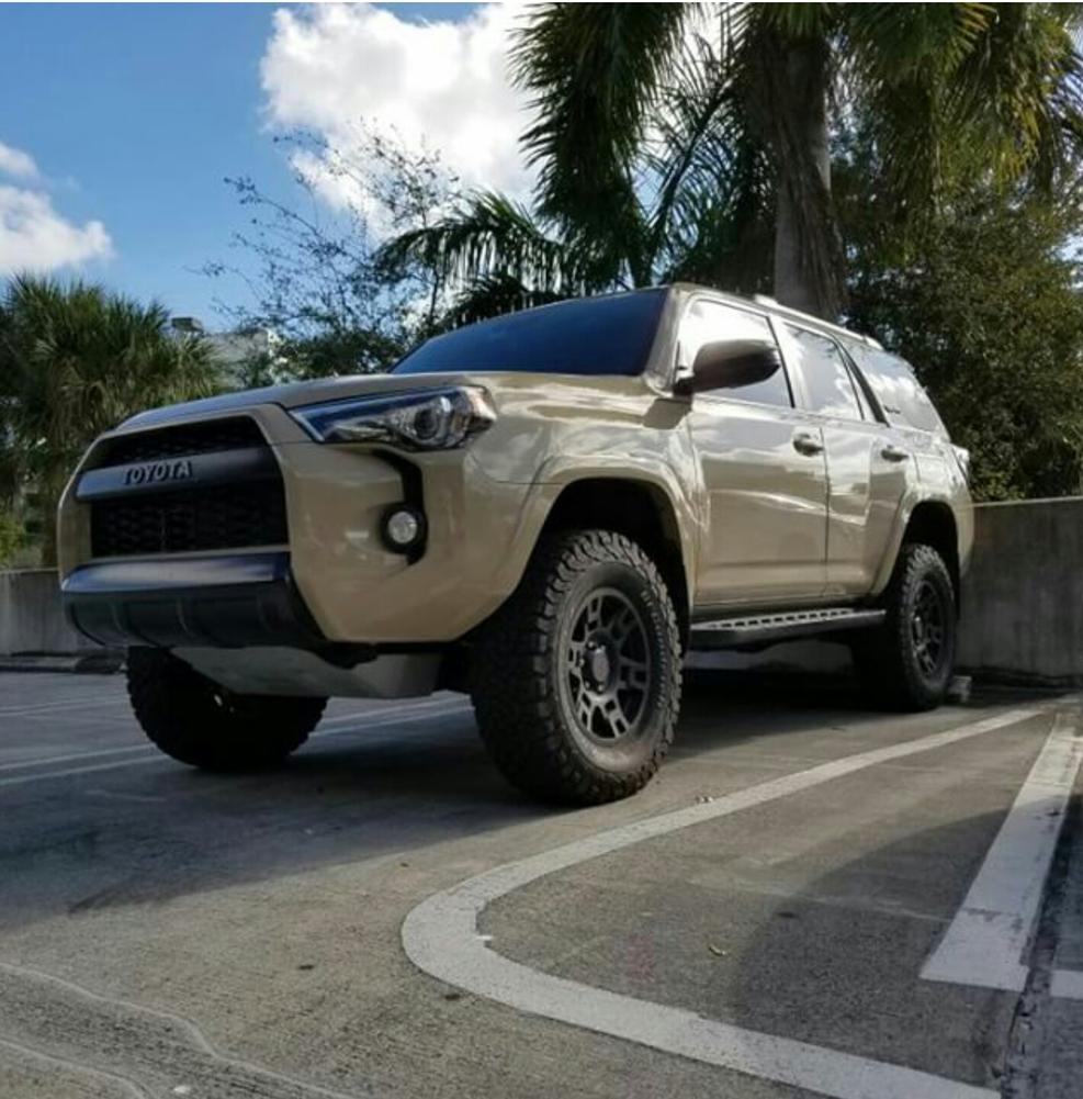

Thanks man. Here's a shot from right now, but the ground isn't level, so it doesn't look right from front to rear in this parking lot. I'll get some more pics up soon. Changing out the wheels and tires this week as well, so it will look a whole lot different here shortly!!

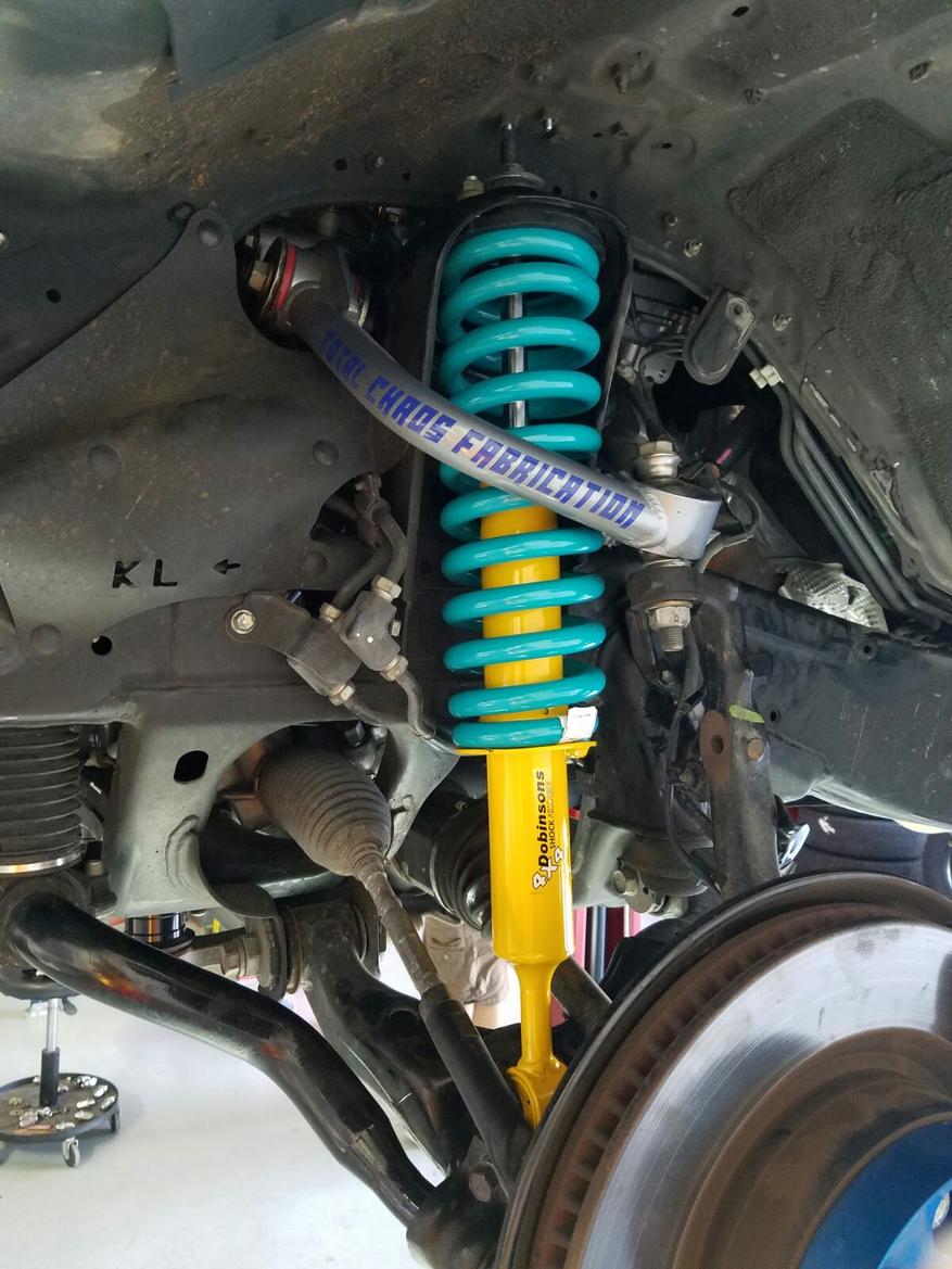

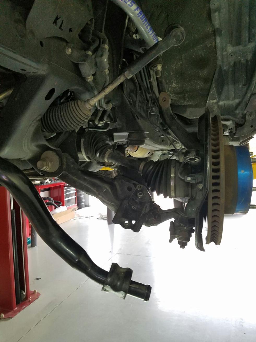

I also wanted to share the installation procedure, as there seems to be a lot of different ways to change out the front strut assemblies. Mine has KDSS and here are the steps that I used to change out the front.
1. Lift car in the air with your buddies 2-post hoist :rockon:
2. Remove the wheels of course and a front skid plate if you have one.

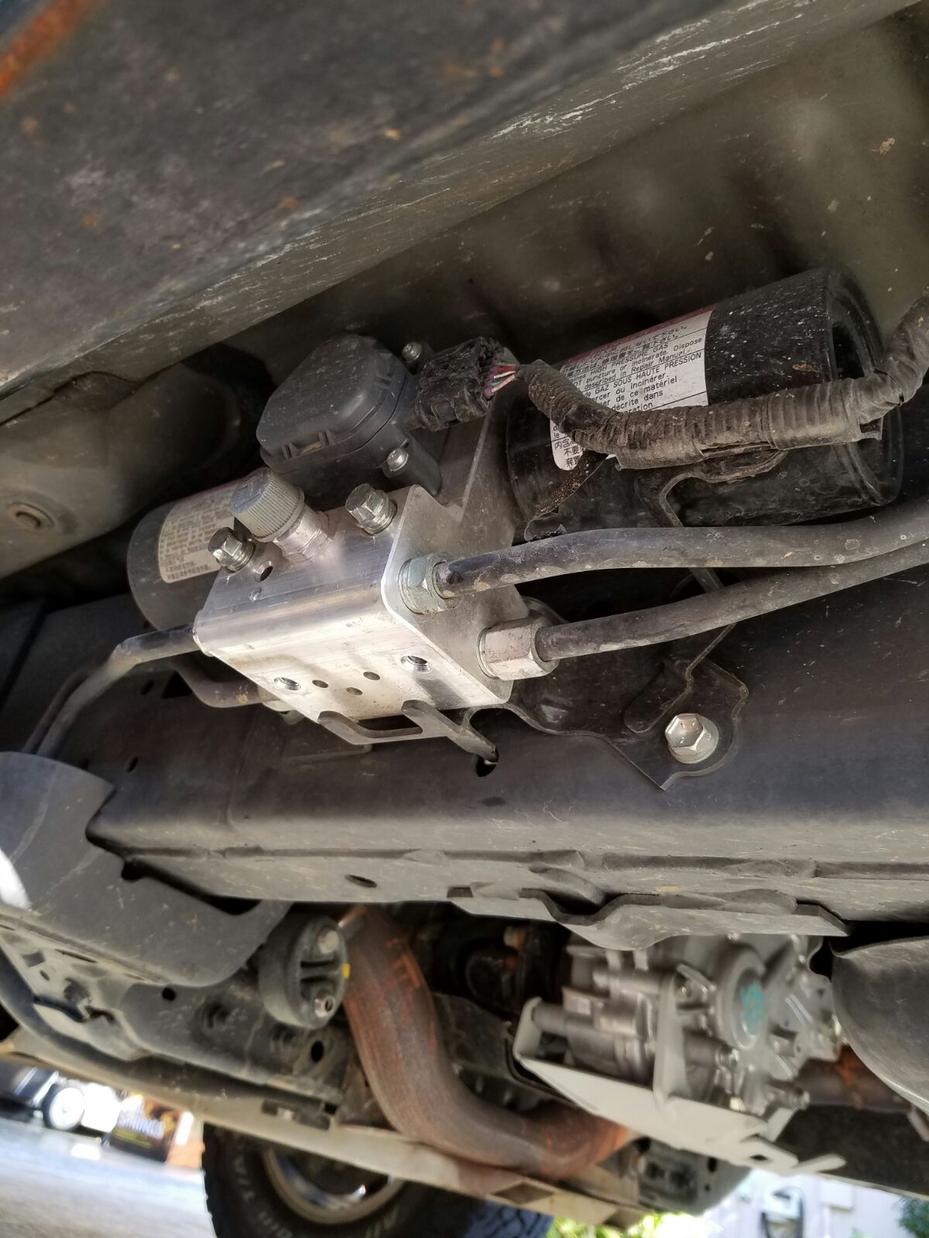

3. Remove KDSS valve protecting plate located under the driver's seat.
4. Mark the 2 x 10mm bolt heads to set a starting point.
5. Undo each of the 2 bolts by 3 full turns ONLY. This relieves the pressure on the sway bar system so that they can be manipulated without too much difficulty during the process.
6. Support sway bar under the piston end, remove bolts from the fixed end of the sway bar mount. Lower the pressure of the sway bar a bit, then remove sway bar from control arm ends on both sides.
7. Remove top 3 small nuts from the top hat.

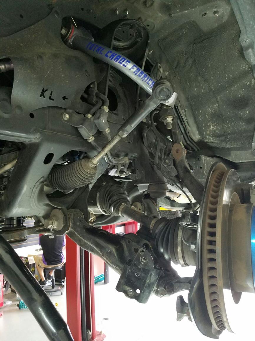

8. Remove cotter pin and nut from the steering tie rod end, and get that out of the way, then remove 2 x lower ball joint bolts.
9. Leave brakes, brake lines, and upper control arm all where it is. Maybe this just worked for me because I had the Total Chaos UCA installed already?
10. Undo and remove the bottom bolt holding the strut to the lower control arm.
11. With a buddy, one pushes down on the LCA (which is now free to swing down easily, and the other slides the strut assembly down and out towards the front of the vehicle. While pushing down the LCA, it can also help to push the brake and knuckle assembly upwards to gain clearance for the coil spring to come out from inside the UCA.
12. Struts are out, do with them as you will, then put them back in.
13. During reassembly, the sway bar mounts onto the control arms can be very tricky to get aligned, and to make things worse, the nuts that are welded into the mount can strip out without too much effort. Ask me how I know how.... :lalala:
14. Once everything is put back together, don't tighten the lower strut mounting bolt until the truck is on the tires and on the floor. Tightening that lower mounting bolt while in the air can preload the bushing and cause it to tear itself apart prematurely, a very common issue with Toyota IFS trucks. Tightening it on the floor at ride height allows it the bushing to be more "rested".
15. For KDSS people, now once the truck is on the ground and has set there for a few minutes, go back to the 2 x 10mm bolts and tighten them back up to where they were. Don't overtighten though since it's all aluminum. Then put the protective plate back on. The truck should sit level now left to right as long as you installed the coils on the correct side (taller coil goes onto the right side (US passenger side) and if you're using a trim packer in another brand, it also only goes on the right side. If you drive the truck without tightening those valves back up, expect to drive straight to the dealer for an expensive KDSS repair!!!
Anyway, that's the way I've pulled my front end apart 2 times now with no issues anywhere.

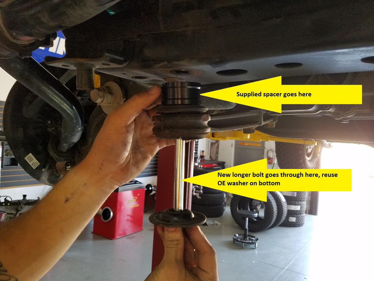

Also installed the diff drop kit as well.

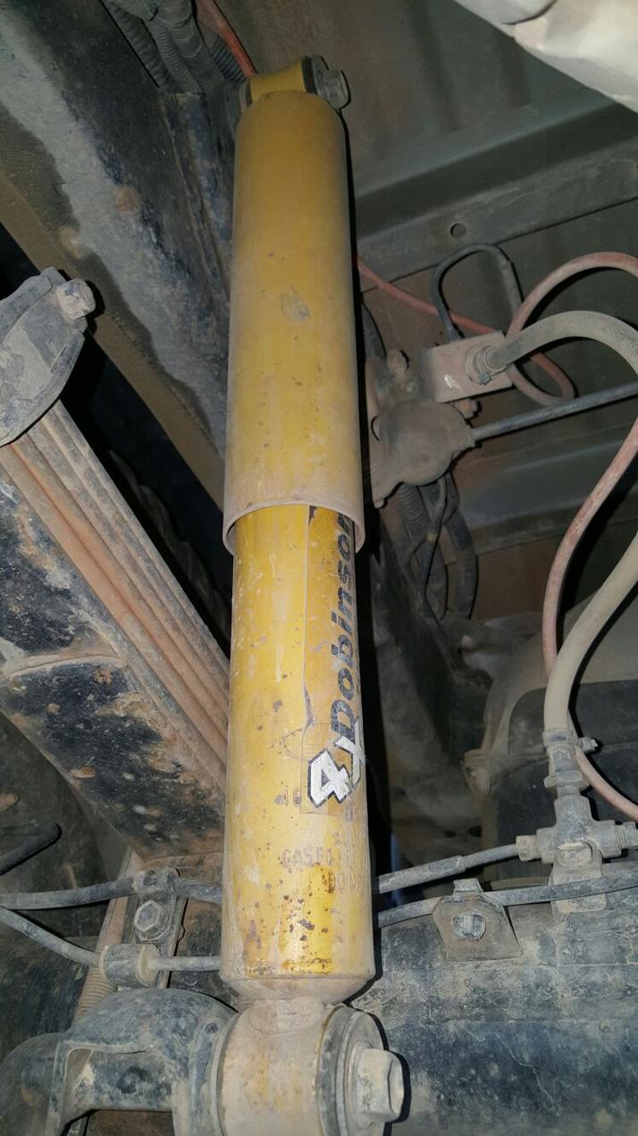

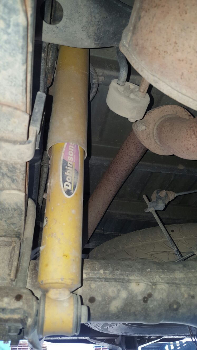

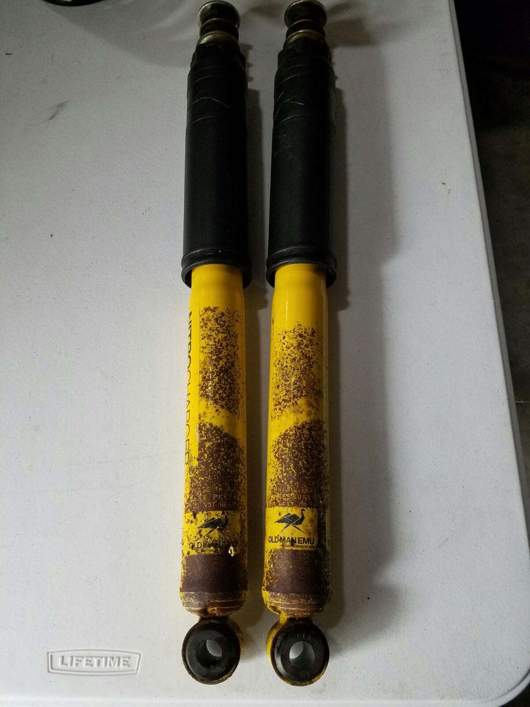

Here's 2 examples. First, the OME shocks I just took off the rear of my new-to-me 4runner I bought with these on there. These shocks were 2 years old. What this proved to me is that the stickers offer a lot of paint protection!! Maybe a thick clear wrap on the lower shock surface wouldn't be a bad idea before installation.
2nd, this is from one of the installers at our HQ in Rockhampton, Queensland, and they have been on for 4 years, and he has been to Cape York and back (very very tough offroad conditions), and you can see they're lasting very well. Those are on a Hilux.
I've asked for a more specific answer on the shocks, and their paint type and finish. I know the coil springs are shot peened with steel shot, washed in hot phosphate, then powdercoated immediately without any hands touching it. Then each coil is individually shrink wrapped, then wrapped together, then boxed, so the coils really show up like new. The other guys on here who have bought them already can tell you.
