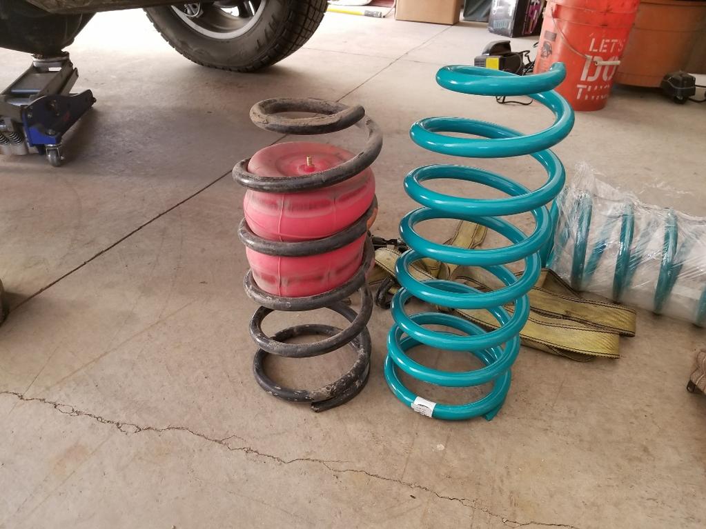

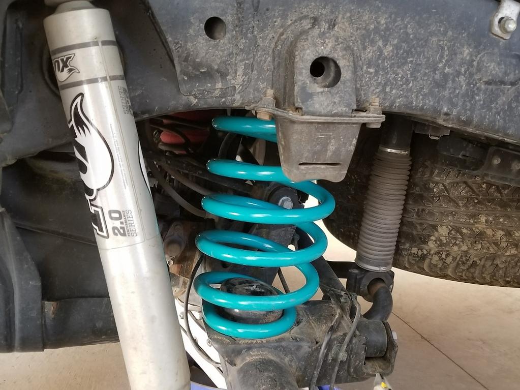

I installed a set of C59-725 rear coils in my '15 TEP yesterday. So far so good. Hard to make much comment on them other than that shipping was very quick, packaging was good enough - it's a box, and they were clearly labeled left/right. I do appreciate the thought given to matching left/right with KDSS so it sits level. I'm not sure if anyone else is doing this.
I replaced OEM coils with air springs. The ride is dramatically better. I'm not a huge fan of internal coil air springs for most use other than heavy loads. Unloaded it makes for a pretty jarring ride on rough terrain. It just makes the combined spring rate really firm. The taller coils with Fox 2.0 rear shocks seem to be a nice combination for ride quality.
I can't say much other than that. Sits pretty level side to side. I prefer roughly the factory rake, so they match pretty well with my front coilovers set to around 2 inches. I can take some measurements after letting them settle and work their way to the final seating on the perches after a few days.
Also FWIW - I removed the wheels and the shocks on one end, but nothing else to fit them into place. I used ratchet straps to compress them. It took about an hour including rotating tires at the same time since I had them off.
Obligatory pics...
Obligatory pics...

I usually have little or no weight in the back. I use the airbags for when I'm loaded with the camping gear and fridge or towing. I don't think I want to put them in the new springs though. I wish I had a better way to add some capacity on demand without ride quality issues unloaded. I ran gx460 rear air suspension for maybe a year and a half, but never really found the right balance of shock dampening so I pulled them out. Still have them. But the coil spring ride is better unloaded. Haven't done anything offroad or hauling with them yet.
