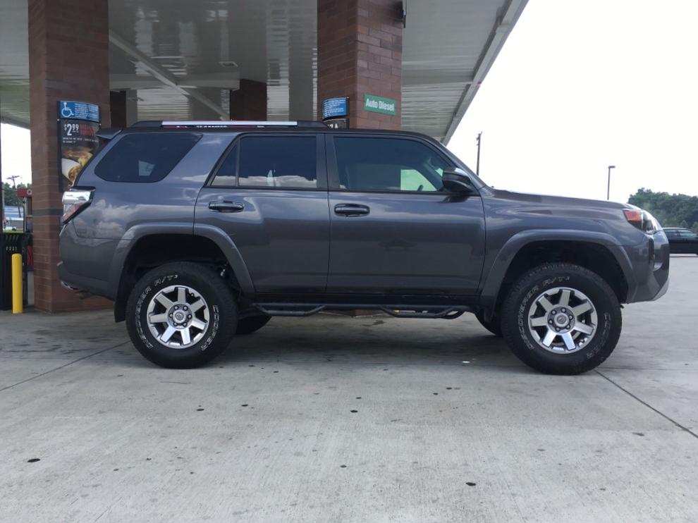

Here's the same coils installed on an empty truck, right after install so they hadn't settled yet.
So far so good. Took this pic the night before camping. So not fully loaded. Full time weight on car is just roof rack/fridge/sliders.
Loaded up the car for camping a week back. Def the reverse rake was gone when fully loaded. . Car was almost leveled with all the weight in the back and roof rack.
The ride is fine. I haven't really noticed anything different. I came from a really stuff suspension vehicle so currently rides perfect.
Front is all stock with stock tires.
Sent from my SM-G930T using Tapatalk

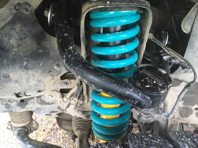

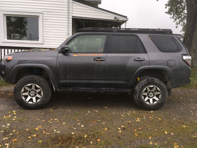

At the Overland Expo in Asheville I was able to pick up my suspension kit directly from Mike and had a good one hour talk with him. Very nice guy who stands complete behind his product and doesn't tell you sh..t. Back home in Ontario I installed the kit with a buddy which only took us 12h, hahaha. the biggest stopper was the KDSS system reinstallation. Everything else went fairly straight forward. I chose the following set up as I will have a dual swing rear bumper and a steel front bumper with winch.
C59-314 front coils
GS59-574 front shocks
C59-727 rear coils
GS59-701 rear shocks
UCAs and diff drop kit
The new right is of course stiffer and directer as before, but even with out the steel bumpers very comfortable. So I expect with the extra weight it will be even more smoother. I am very happy.

How much constant weight do you run in the back? I was thinking about picking up the same rear spring so i don't get a reverse rake when loaded up.
