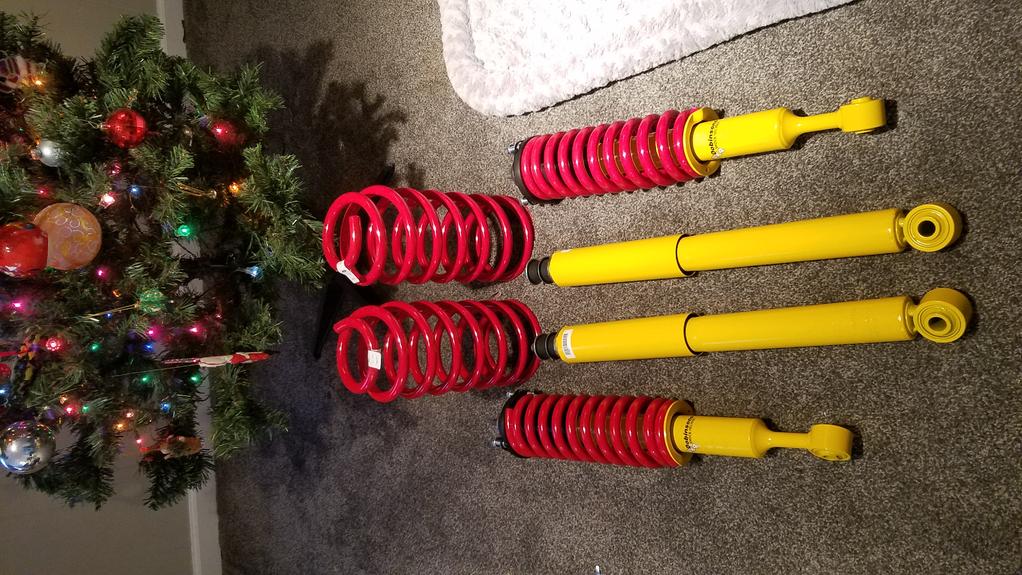

Due to popular demand and an amazing amount of requests, we have brought our most common 4Runner (and Toyota) coils to the US in 2 additional colors. Red and black. Now these part numbers are available (depending on stock) in classic Dobinsons Teal, TRD Red, and/or Black, depending on part number.
C59-300 (Teal, red or black)
C59-302 (Teal, red or black)
C59-314 (Teal, red or black)
C59-599 (Teal, red or black)
C59-505 (Teal, red or black)
C59-325 (Teal, red or black)
C59-327 (Teal, red or black)
C59-675V (Teal or black)
C59-677V (Teal or black)
C59-701V (Teal or black)
Of course, we would prefer to sell the teal for branding reasons, but so many of you this year have asked us for a color choice, so here you go!!
NOTE: the optional colors are not listed in the catalog, and are not sold on Amazon or Ebay. You have to contact me directly and let me know what you want. They're all the same price as usual. As usual, send me an email to [email protected]
Santa came early!

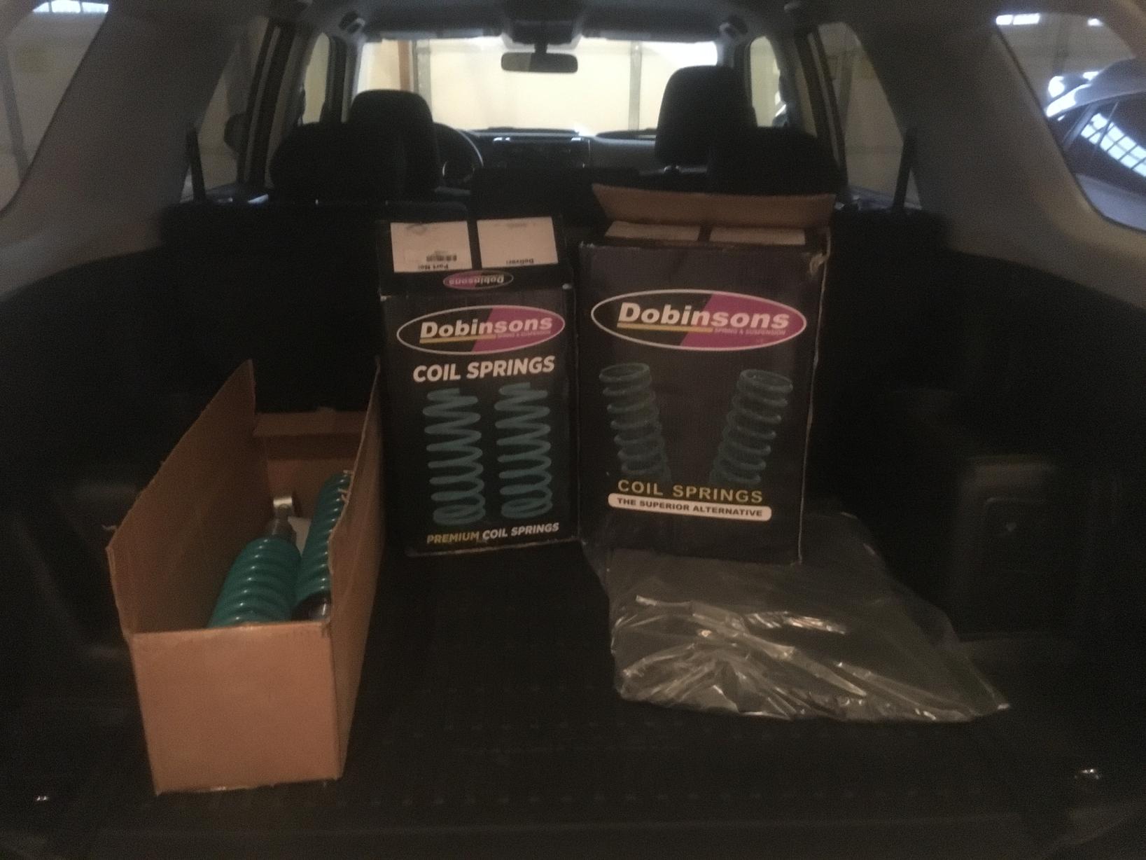

Got the Dobinsons C59-300 and C59-505 with a full set of Bilstein 5100's all ready to install tonight.

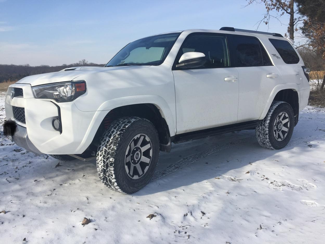

After install and alignment I gained 2" on all corners. So very very pleased with the spring and school combo and love the way it looks and rides!!

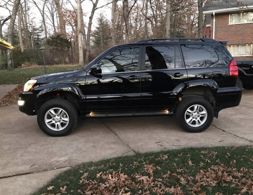

hey Mark! Kyle w/ TOO here
I know it doesn't help on your 4Runner but here's a GX with red coils I put together a few weeks ago.
It sounds like you guys are going to have a MINIMUM of 400lbs of added weight in the rear. Going with a heavy rear spring sounds like it might be beneficial to both of you.
The MRR sure is nice, i've really enjoyed having it. I have KDSS on my GX as well, the combination is bad to the bone. Corners are very flat and controlled, day to day ride is great, and the off road performance has been very good. You won't get a better value for an adjustable coilover setup. 10/10

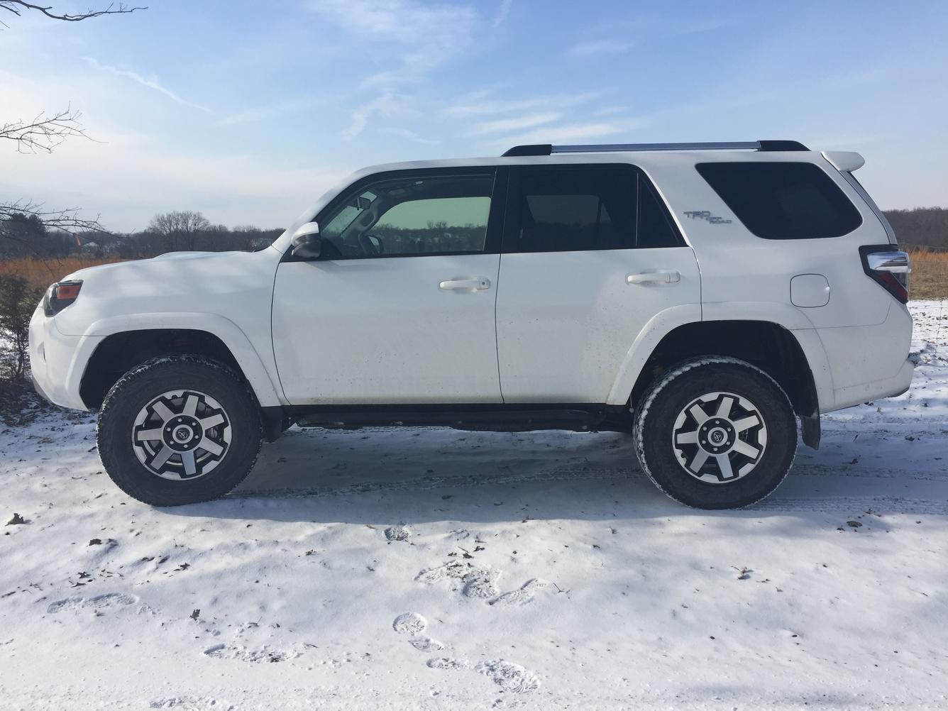

Thanks to Mike for helping get my 4Runner set up. I chose the C59-300 and C59-599 springs with Dobinsons shocks/struts. The height gain was a little more than the estimate from Dobinsons - but it worked out perfectly. Still a slight rake like I wanted. Similar to the ARB set up on my 2006 using medium springs. The nose dive is gone and it rides firm, but not harsh at all. This amount of lift keeps things simple - stock UCAs, easy on the CV joints and no stress on the brake lines. I Installed it over a weekend and didn’t need a spring compressor for the rear. The pictures show the truck with new stock size Cooper AT3s and RCI sliders (makes it look higher).
