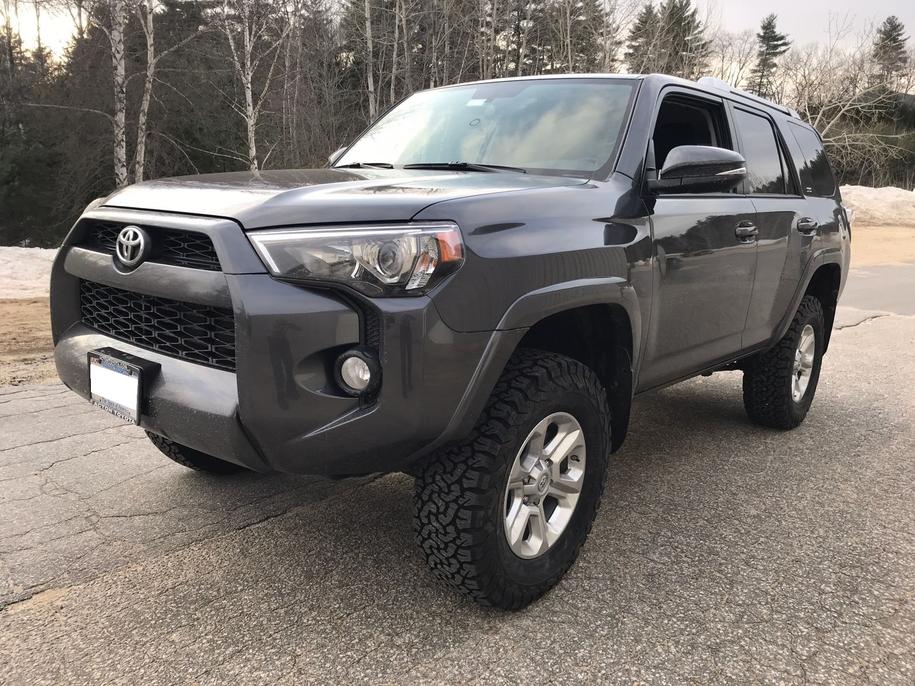

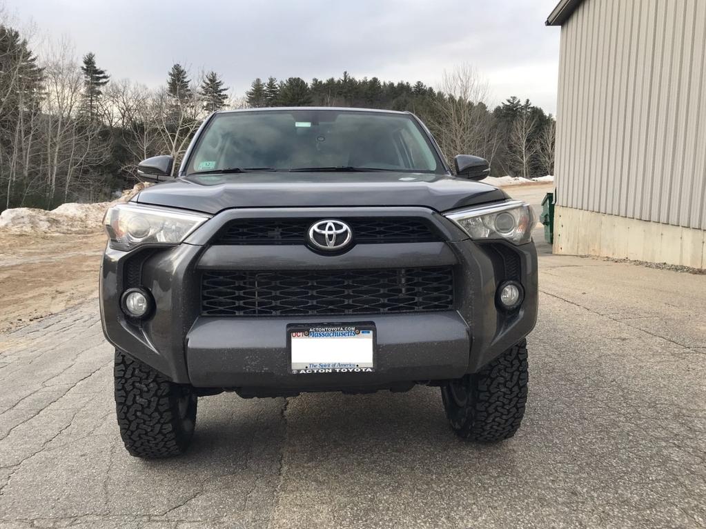

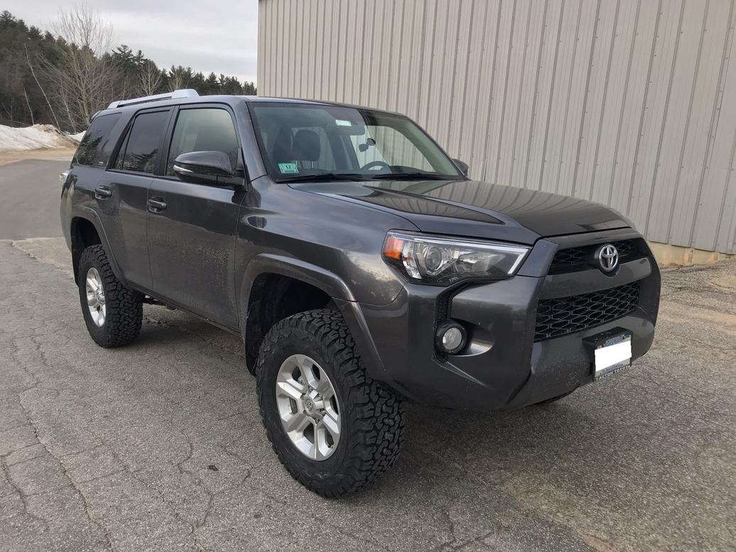

Our dealer up in New England (Bow, NH), Main Line Overland, just finished this 5th Gen yesterday.
Using these parts:
C59-302 - 2.5" front
GS59-700 - front struts
C59-505 - 1.5" rear
GS59-701 - rear shocks
If anyone of you guys are up that way, give Eric a shout, as they sell and do full installations as well.
