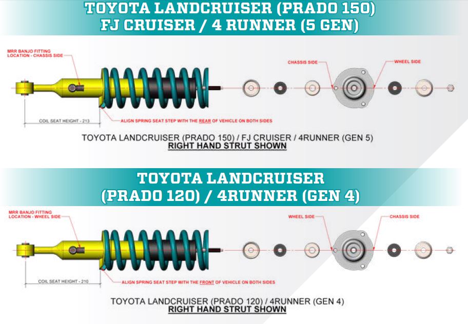

I should have posted this a long time ago!!!
This comes up almost daily now. Pay attention to the assembly sequence of washers (flat and locating), and the bushings, and then the step in the coil seat as well.

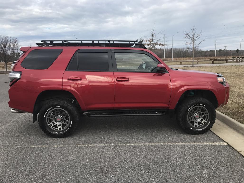

Finally, after the parts have been sitting in the garage for six months. Bilsteins set at zero. 302 and 505 coils. No pre or post measurements taken. Going to stuff some 285 KO2s with bronze FN Pro wheels.
That looks awesome, A bit confused reading the descriptions on the first page about the 302s, does it mean with a heavy load it sits at 2.0 and with no load its 2.5? Or are there a heavy and stock load version?
