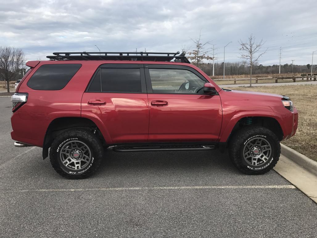

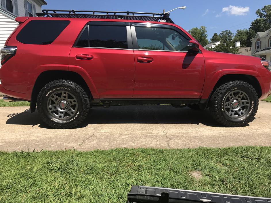

Finally, after the parts have been sitting in the garage for six months. Bilsteins set at zero. 302 and 505 coils. No pre or post measurements taken. Going to stuff some 285 KO2s with bronze FN Pro wheels.
That color combo of truck, wheels and tires looks so damn good!!!
