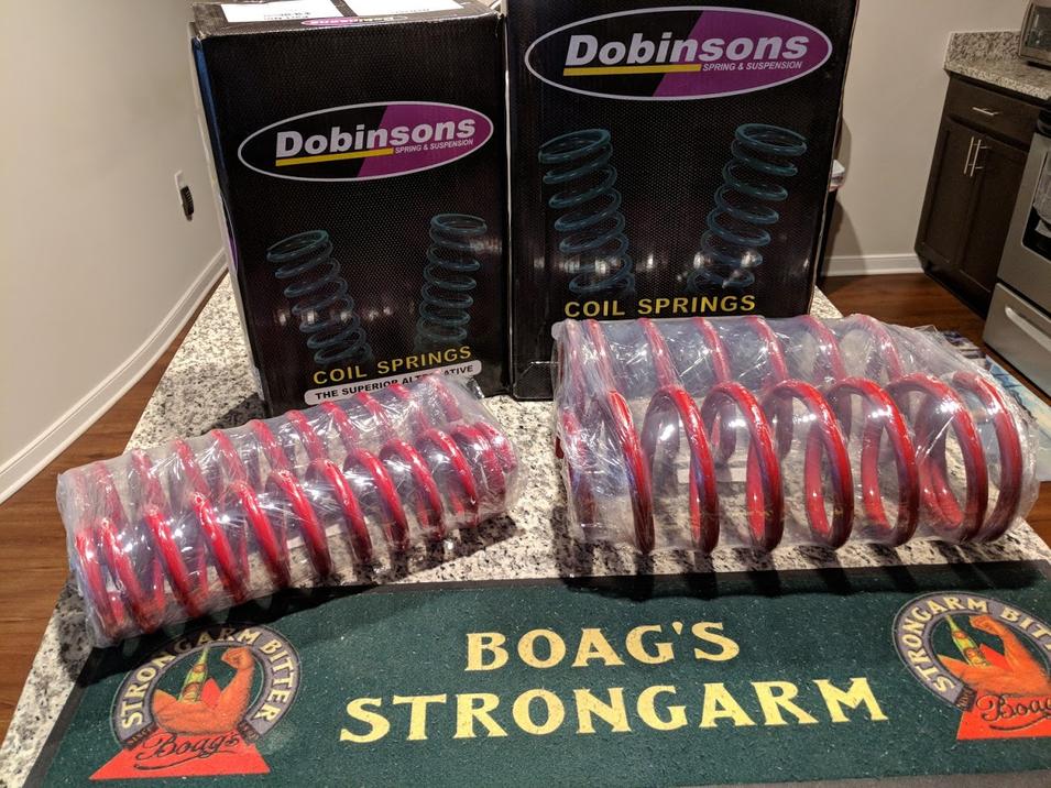

Came home to some Aussie goodness...
Thanks Mike!

Dammit!!! I've been looking for my Boag's bar mat everywhere!! Did I drop it into your box with the coils???
:becky:
One of my brothers lived in your homeland for a few years a while back, I guess I should have included my guard-kookaburra (stuffed toy, that is...) and rain stick in the pic as well.
Thought you might get a kick out of that pic...
They are red! [MENTION=172113]gdvan01[/MENTION] What springs are they (size and lbs)?
