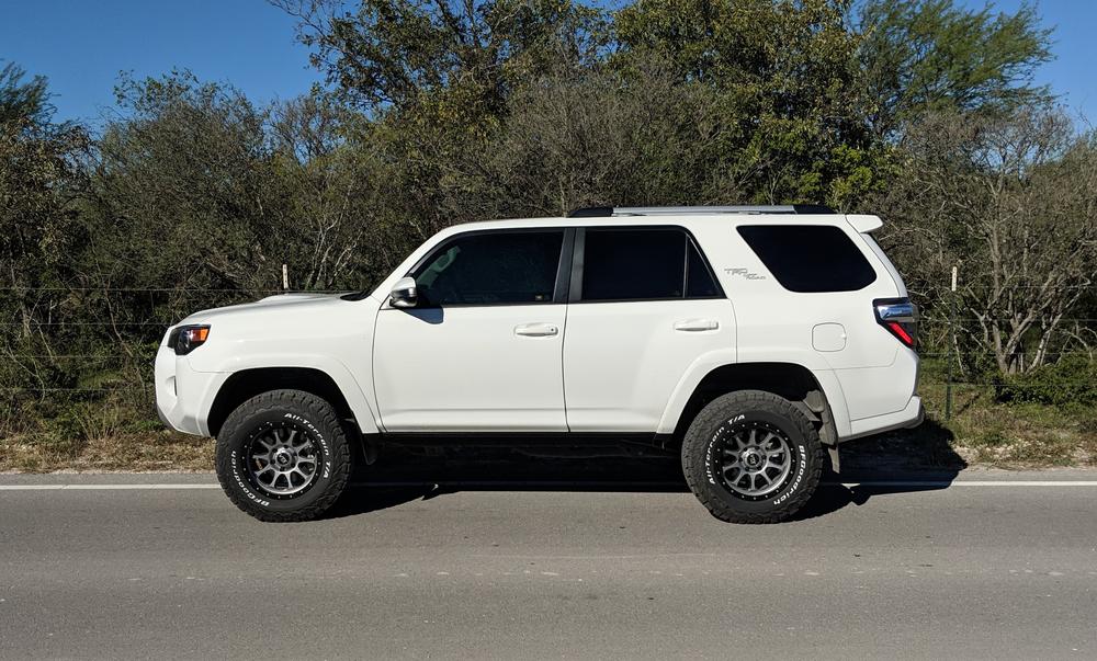

Hub to fender please. I have a sudden interest in these coils. thanks!
Pre: 19 3/4 left 19 3/4 right
Post: 21 3/4 left 21 3/4 right (with a full tank)
Basically 2”, no noticeable lean... With the 599's on the rear, there is still a slight rake, which I personally prefer.
Thanks for the measurements! Its crazy how you pretty much got 2in of lift when its advertised as a 1-1.25in lift. Truck looks great!

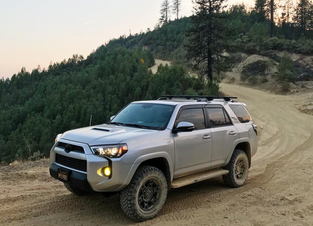

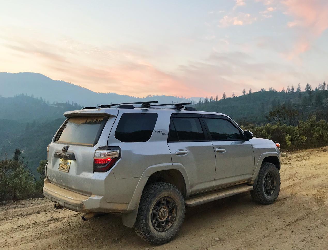

Just slapped a little lift kit on. So buttery, a single tear was shed. C59-300, C59-723, twin tubes front and back. Keeping about 100lb in the rear for a bit to help the springs settle.
Beautiful. What type of springs did you go with?
Nevermind. C59-723. Duh.
Looks good. Are you still running 265s? Also, did u go with the comfort shocks on the rear? If so do you recommend them with under 100 lbs in the back?
Anyone feel free to chime in. :wave:
Thanks mate. Tires are 275 ko2s and rear shocks are the softer ones, GS59-705. I’ve read the rear should settle by 0.25-0.5” so I’m helping this along with two dumbbells in the rear temporarily. But to answer your ques yes I recommend, setup is butter w unloaded rear as well
Awesome! Sounds like overall you are roughly 2” lifted over stock. Taking into account for a slightly taller tire and lift. Plus from what I read you get a bit of extra load carring capacity.

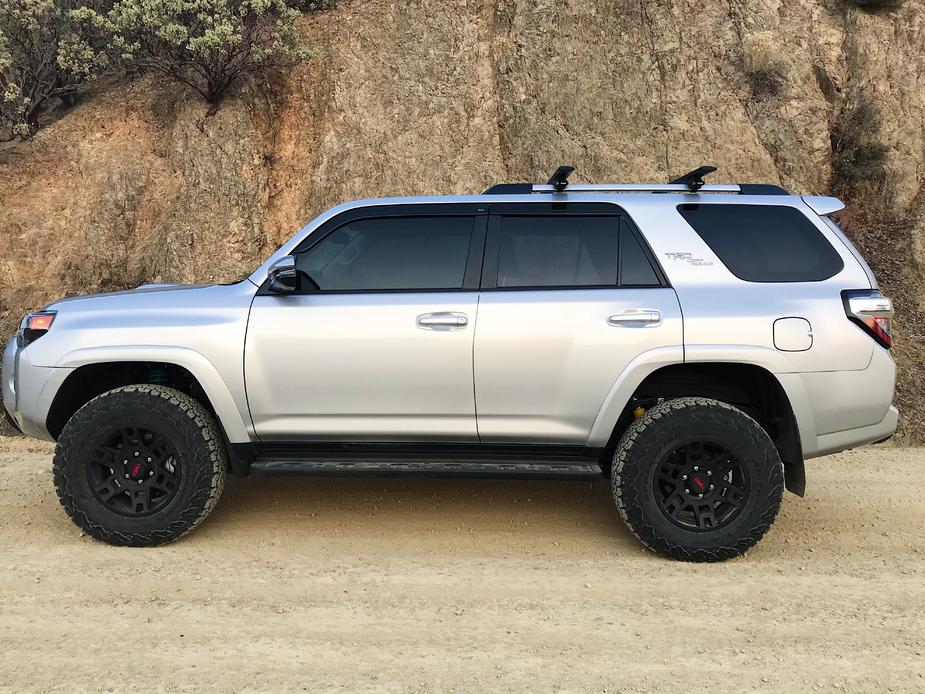

Just had the C59-300 & C59-599 installed. Front gained exactly 1.75" both sides as advertised. Rear got 1.875" & 1.625". It doesn't look terrible, but I was really hoping for only 1". The ride is great. I have them paired with 5100s. VTX wheels with stock size tires.
Anyone know if the top caps and hardware Dobinsons uses will take a top plate specer? Just incase i add a low pro and want to get my lift back.
Looks good. What clip setting on the front 5100s?
Got a similar more-than-advertised lift in the back with the 599's initially. Stick one or two of your stock tire/wheel's in the trunk for 500 miles. Got mine to settle to the advertised height.
