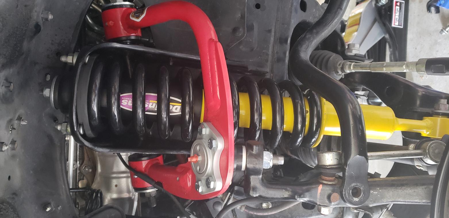

For those looking for pictures of a particular setup, here is mine.
GS59-700 Front Strut
C59-302 Front Spring (light)
GS59-701 Rear Shock
C59-325 Rear Spring (medium)
Rides much better than stock. Braking dive is less pronounced and the suspension does not get overwhelmed by rapid bumps like the stock suspension did.
FYI: Had the dealer align the truck after install. With stock UCAs, they were able to hit the acceptable range for Caster, but they were on the edge of it. Any higher than this and UCAs would be necessary.

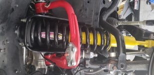

Just installed today with jba uca 302/325 f
265/70/17 Falkens

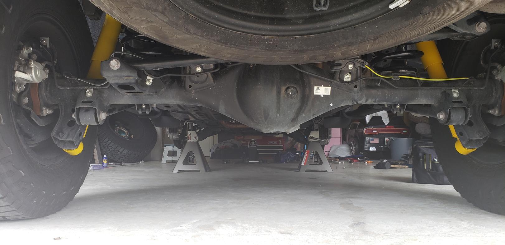

So after taking measurements post lift front is 22" both driver and pass, rear driver 24" rear pass 25".....is this normal for the rear? I'm running 325 rear springs and measurements are from center of the hub. Just installed the lift yesterday so hasn't settled yet.
