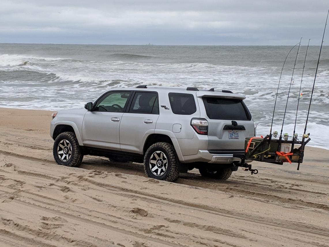

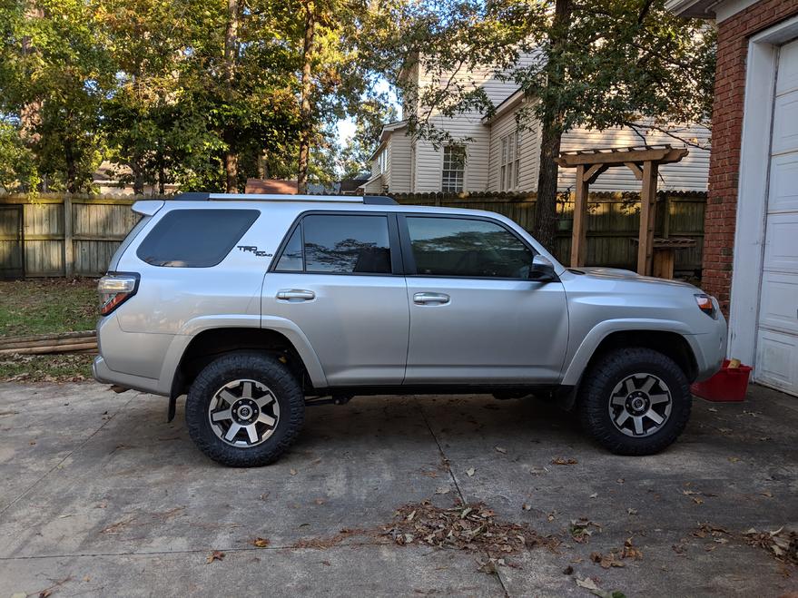

238 Front, 599 Rear (~ 1" lift front and rear)....265/70R17 Nitto Ridge Grapplers
The Dobinsons setup eliminated the brake dive and stiffened the cornering a little, not too much. Love this setup, highly recommend to anyone looking for a mild lift. Thanks Mike for all your help!!

I love the photo on the beach!!! The truck looks great in that environment

This looks great!!! it appears that you netted a little bit more than inch in the front. Do you have any measurements?
