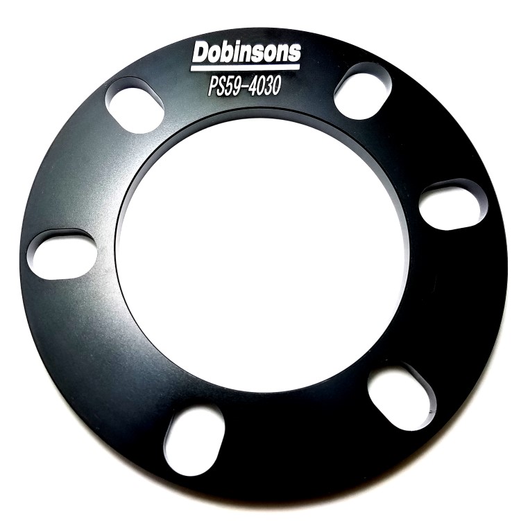

We finally received our Front Top Mount Strut Spacers into stock this week.
PS59-4030 - Single 1/4" machine alloy strut spacer, anodized black, suits almost all Toyota's from the 90's to current. Drilled with 2 bolt patterns to fit multiple vehicles. 4Runner 3rd, 4th, and 5th Gen. All Tacoma's 1998 to 2019. All GX470/460. All FJ Cruisers. Can be used to correct a vehicle lean if one exists, or to add one to both sides to add 1/2" lift.
$35 each
NOTE: In our experience with our suspension these aren't needed hardly ever on a 5th Gen, as they don't lean like 4th Gens and Tacoma's do.
