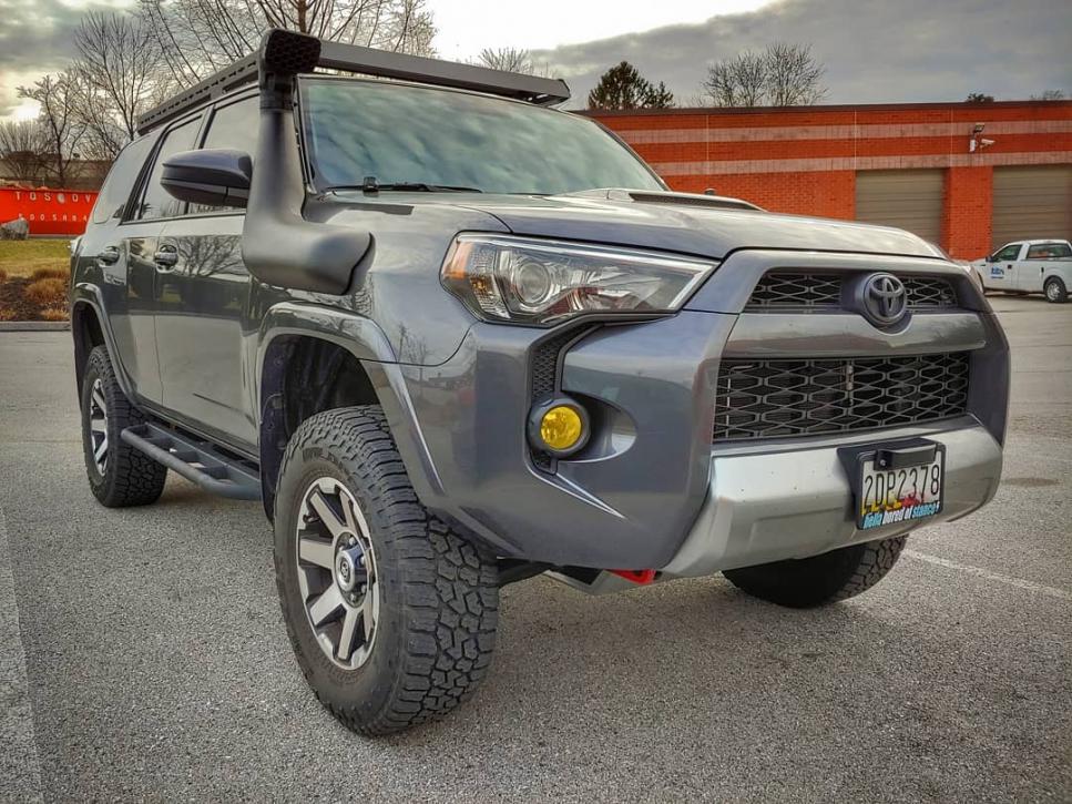

more pics after it settles (and with a better angle); but this is the 300/574 & 327/701 combo w/ 265/70/17s...
In addition to skids & sliders, other added weight is the LFD full steel roof rack, second battery/C4 Fab tray, rear storage w/ 4 front runner boxes, fridge, and fridge slide.

That looks really good!!!
