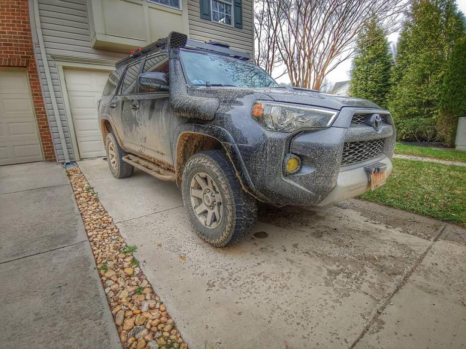

I have a similar setup, except I'm running 327/701's in the rear... Honestly I don't feel like the front yielded anywhere near 2.75", maybe closer to 2-2.25"? Then again maybe it's just a visual trick because I'm still on 265s and stock TRD-OR wheels.
It should be noted that I have a second battery, aluminum IFS/trans/t-case skids, and a handful of lbs of lights/electrical stuff further adding weight to the front; on the rear I probably carry just shy of 200lbs (rear storage/Front Runner boxes/fridge; steel roof rack; etc) in "daily" mode, and probably 300+lbs for camping/trips.
I'll definitely be going up to 302 (maybe 314?) when I do a slimline front bumper and synthetic rope winch; and if doing it again, probably would have gone with 325s in the rear (or maybe I just really need to get a steel rear bumper w/ swingouts to add more weight :P )
