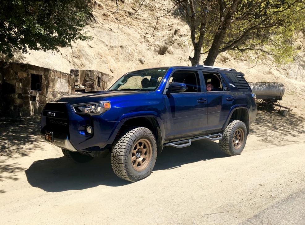

I'm pretty sure he's running the 700 struts, so less height, but also he's running a stock tire size, or close to it, so be careful when visually looking at these trucks with different combos of parts, as wheels and tires can easily change the appearance of "lift height" and just how full the fenders are.
Yep. My struts are the 700s with stock size tires.

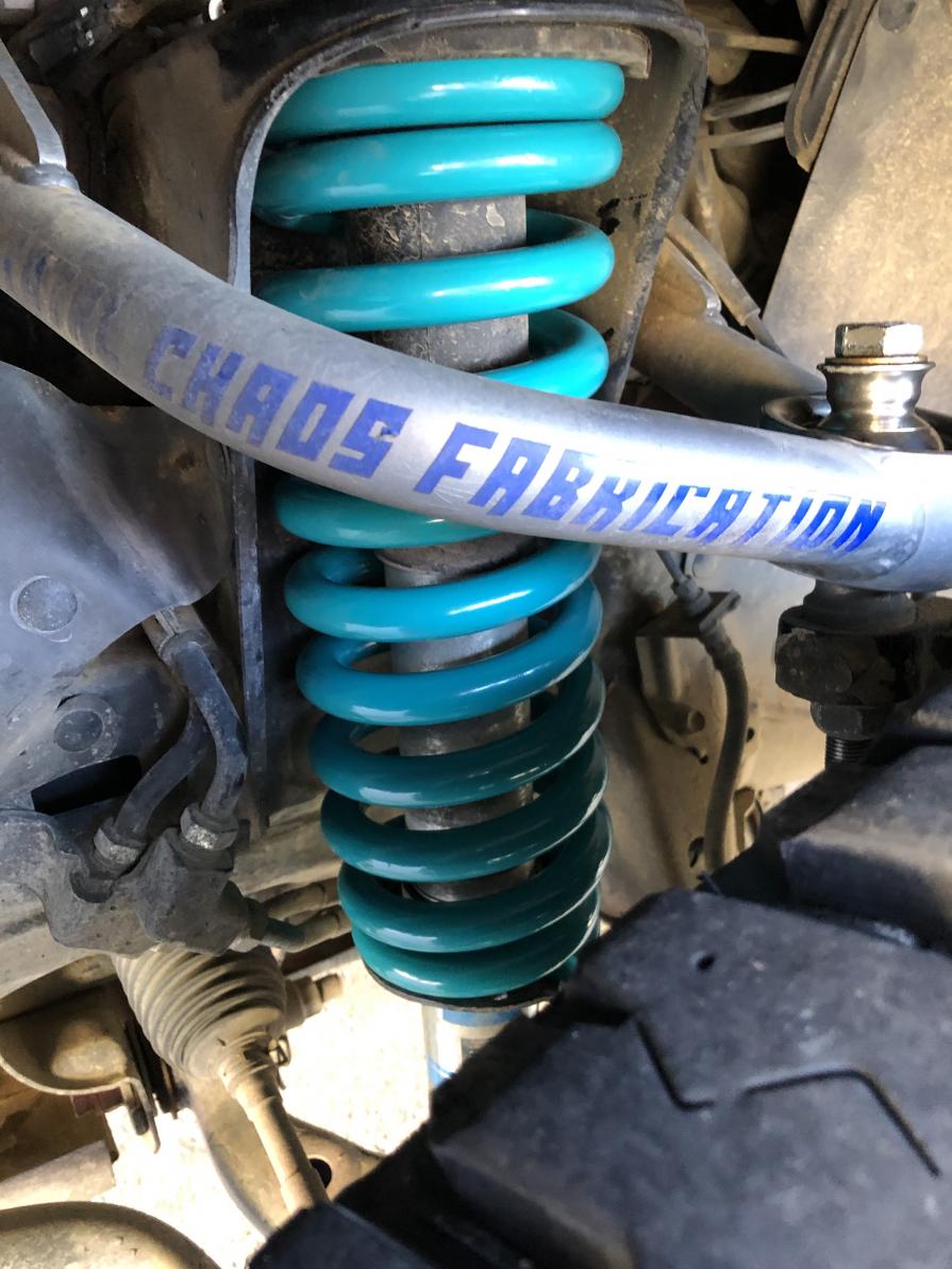

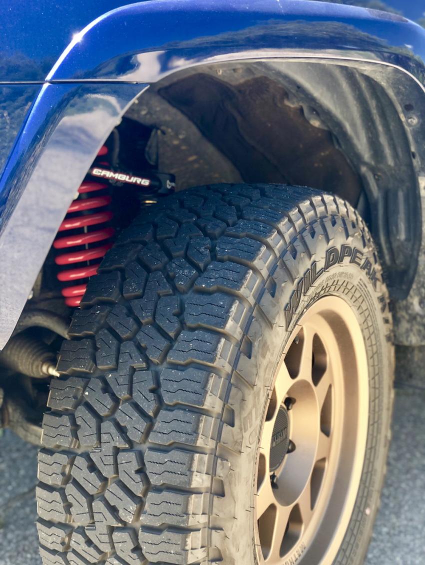

Went from C59-300R with 1/4” spacers to C59-314R front springs with no spacers...
I’m loving it!!!
C59-314 Front Springs
GS59-700 Front Struts
C59-325 Rear Springs
GS59-705 Rear Shocks
did you do a diff drop? How much of a lift did you get? The pic looks like you still have a little rake in the front.
No diff drop. I wanted to keep some of the rake since I load up a ton of stuff when we go out. I'll post some pics of us loaded up once I can get through the next two weekends. Overall lift up front was just over 2" (full steel skids bring it down a bit).
