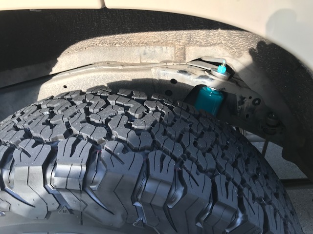

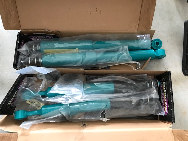

Should be doing my install this weekend. Got the yellow shocks and struts and my wife immediately said :puke: and to fix that issue. So since the cost was pretty much the same no matter the color I decided to match everything.

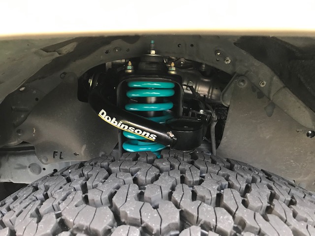

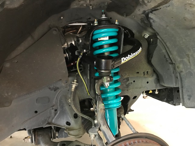

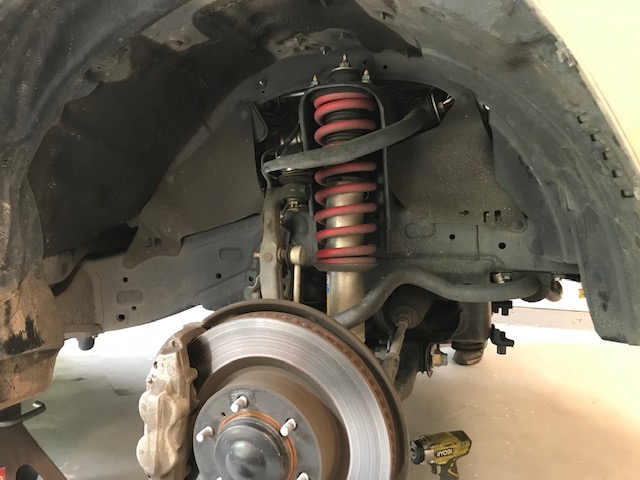

Install done.

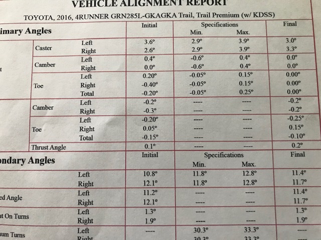

In reference to the Caster, drivers side adjusted to 4, passenger side wouldn't go any higher than what you see so they had to dial it back down. I was hoping to get 4 across the board, no luck at the shop I went to. May try another shop down the road.

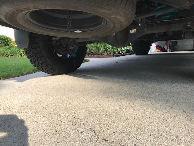

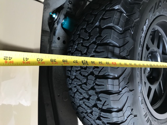

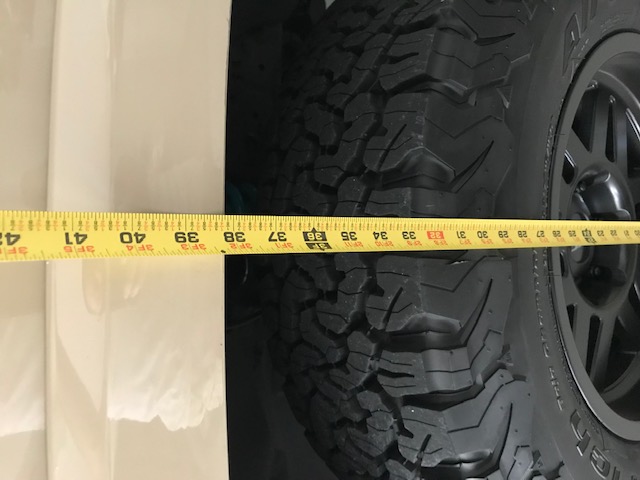

Immediate post install pic for height reference and passenger measurements at home. Drivers side is about 1/2 inch lower.

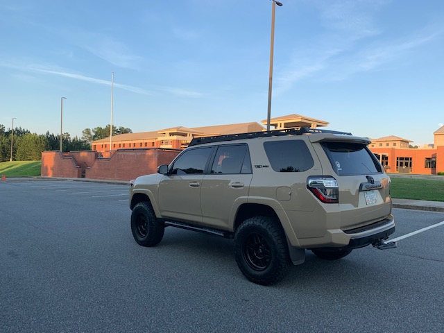

wanted to share some pics of my newly installed Dobinsons setup.
I am running:
C59-314 with GS59-700 in the front
C59-325 with GS59-701 in the rear
Super happy with the lift and ride quality!
