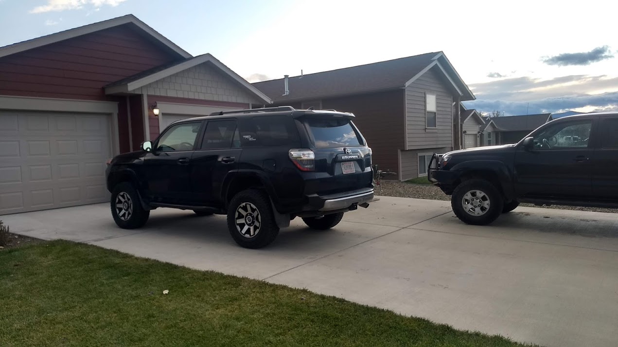

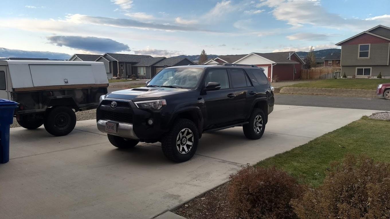

Here's the stance with Bilstein 5100s all around set at 1.75 front, and Dobinsons 1.25" lift rear springs(c59 599). Also the air lift 1000 air bags for the stock springs fit in the new Dobinsons springs.
Before and after
