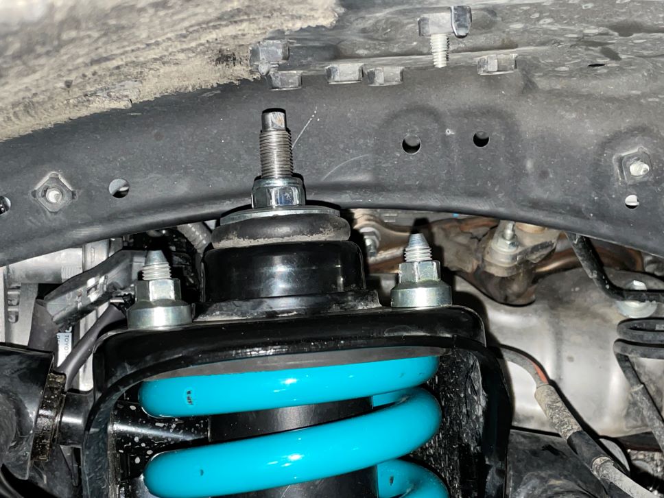

My friend and I installed a strut and spring for the front over the weekend.
I was going through a few sources. I thought there was a mention that you'd just bottom out on the top nut for the strut so there shouldn't be an issue with overtightening...
However, it looks like with the top bushing bulging, I either did that or used the wrong washer. Thoughts?

Could be the wrong top washer, as that end uses the bigger OD of the ones that come with it.

This is actually the look of it with the vehicle on the ground. I'll assume I had the two washer's backward then. The slightly larger one in the top hat and this smaller one on top.

The smaller washer will dig into the rubber if that's what's on top. You can relieve some turns on nut so it's not bulged out so bad, but definitely worth checking your work as it's not usually that bulged out

Thanks! All fixed up.
