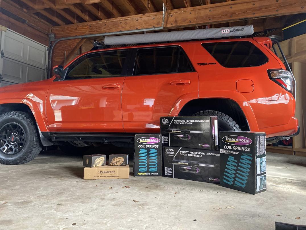

Placed order with Mike couple days ago. Everything shipped already.
Went with
Front Springs: C59-302 - 2.5" Lift Stock Load, 2" w/150LBS Added Load
Front Shocks: IMS59-50700
Rear Springs: C59-505 - Stock rear end, 1.5" lift
Rear Shocks: IMS59-50701
SPC UCAs - 25480
Treaty Oak Offroad - KDSS Spacer Kit
Went with
SPC UCAs - 25480
