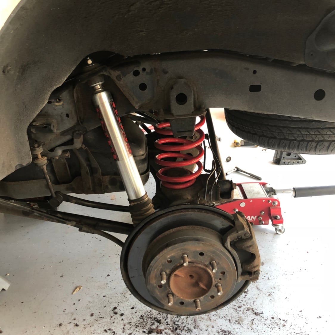

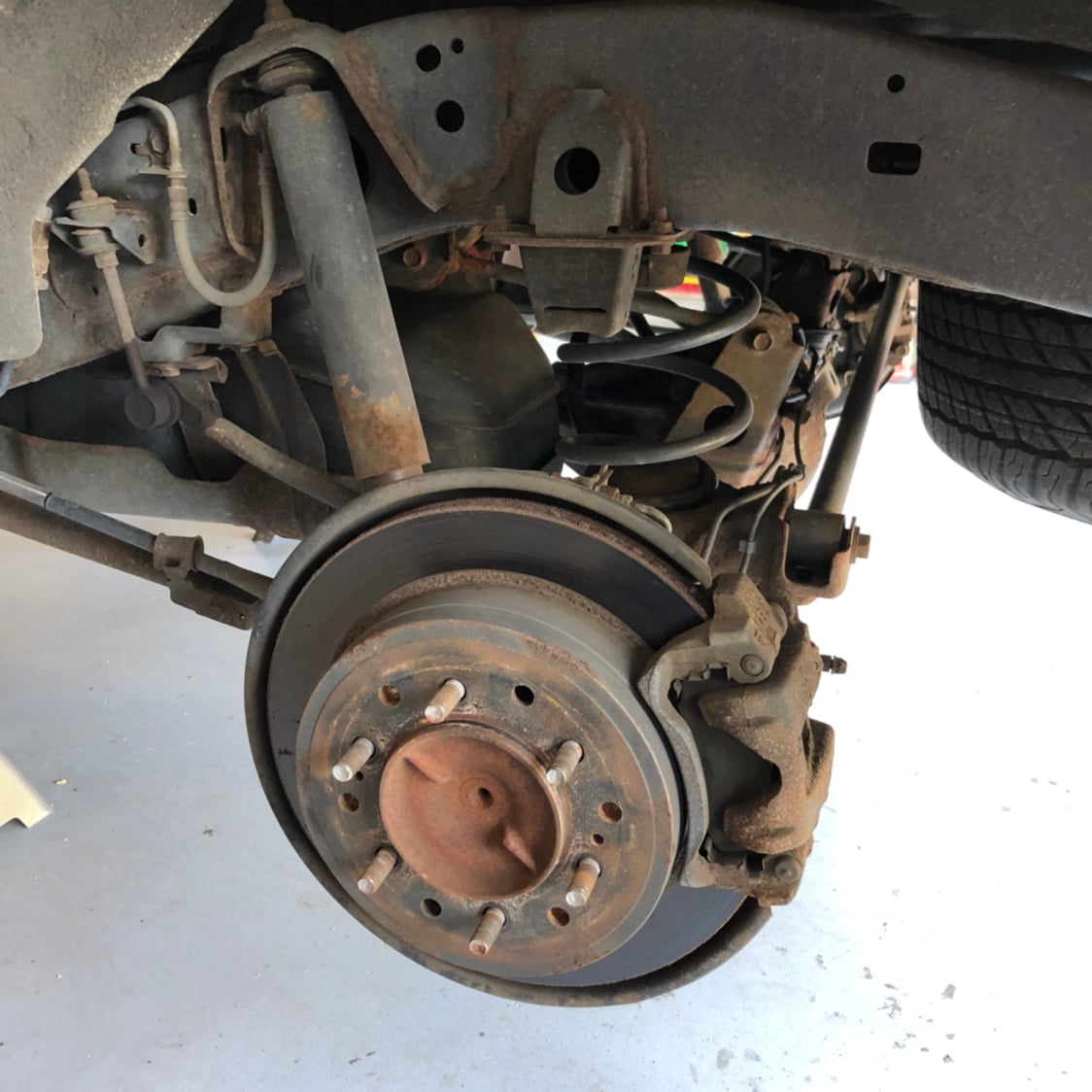

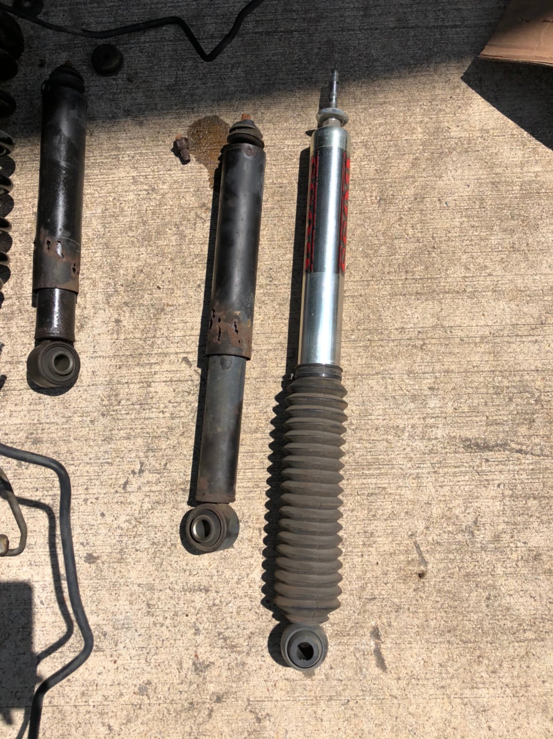

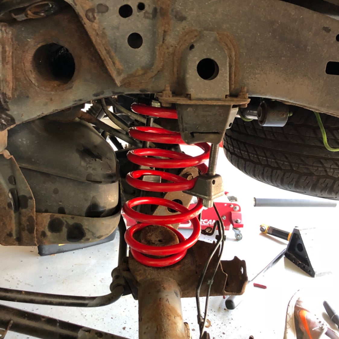

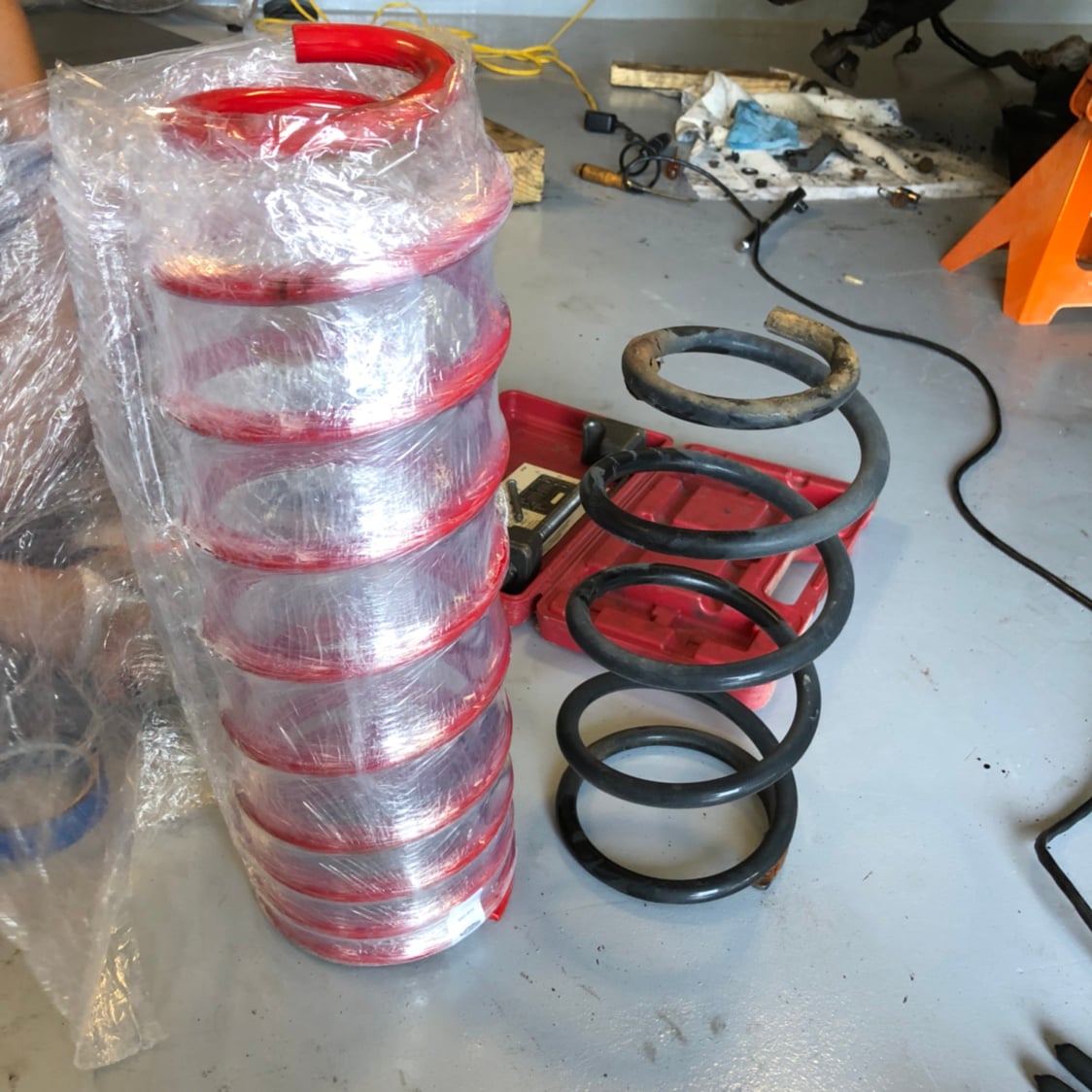

Finally did the install yesterday. Took a lot of finagling to get them to fit though seeing how much shorter the stock ones were lol. Unfortunately the compressors did mess with the finish a bit so I’ll have to touch them up a bit down the road.

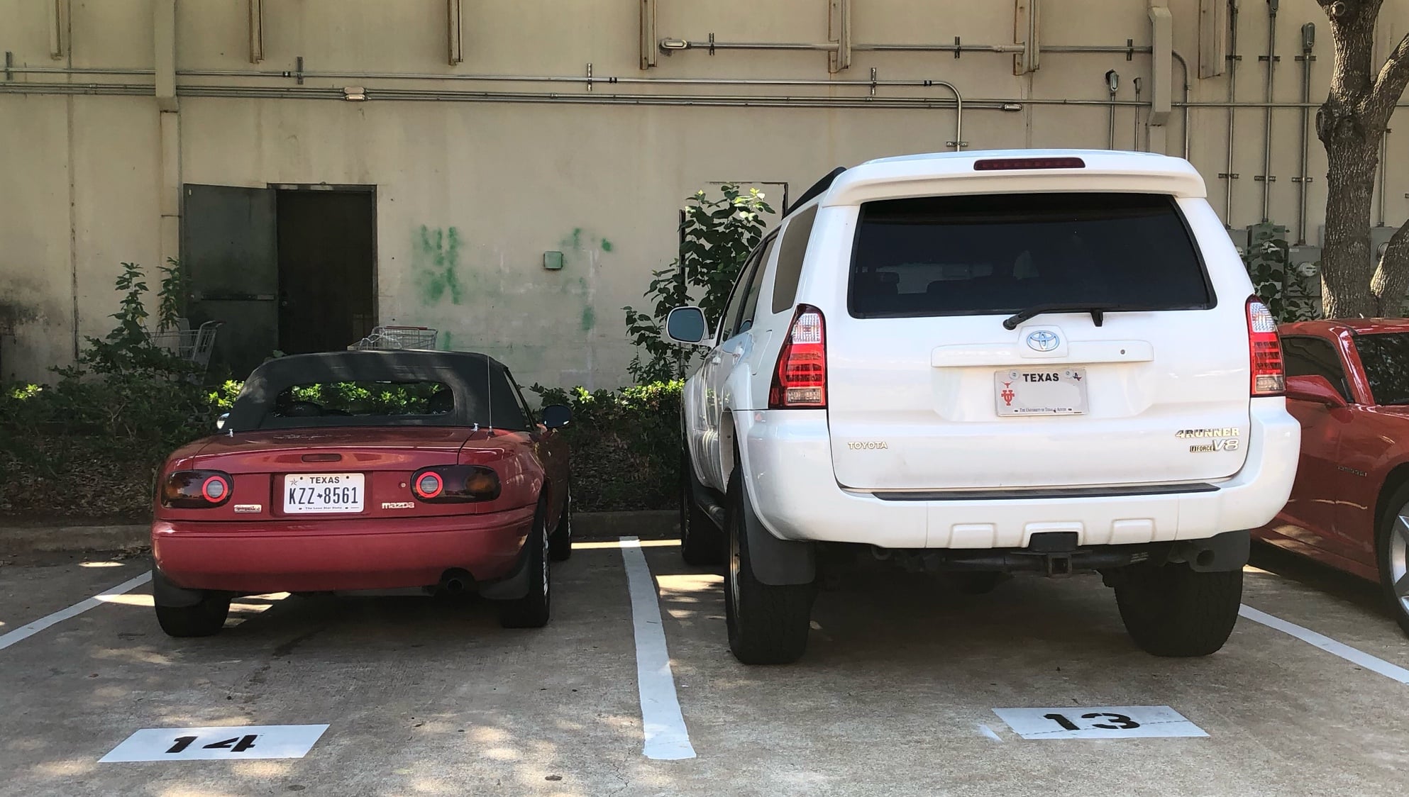

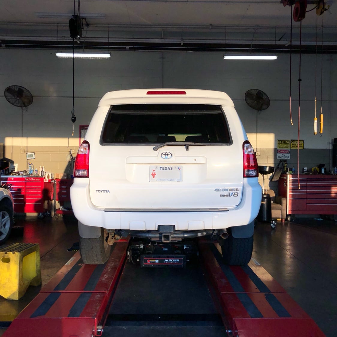

Might be hard to see but the driver lean is pretty real. Have half a tank of gas right now.
Better shot here where you can see it with the line running across the top. Should I put in a spacer? It’s off by about 3/4”?
I have some bilstien 5100s and I want to lift the front 2.5 " but I want to use the stock height perch on the shocks what springs would you recommend?. I'm also looking to add. 2" to rear will need shocks and springs
Thanks
Thanks
Hey man, I used to work in Dana Point!! My parents live right by there still.
For a V6, use C59-302 for 2.5", or for a V8 use C59-314 for 2.5", run the 5100's at the lowest clip height.
And on the rear, C59-325 will add 2".
I'd suggest you let it settle for about 500 miles and see how much different it is then once the coils are broken in, then you can add spacers accordingly to how much it is off.
The coils usually settle 1/4"
