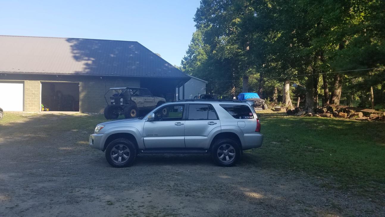

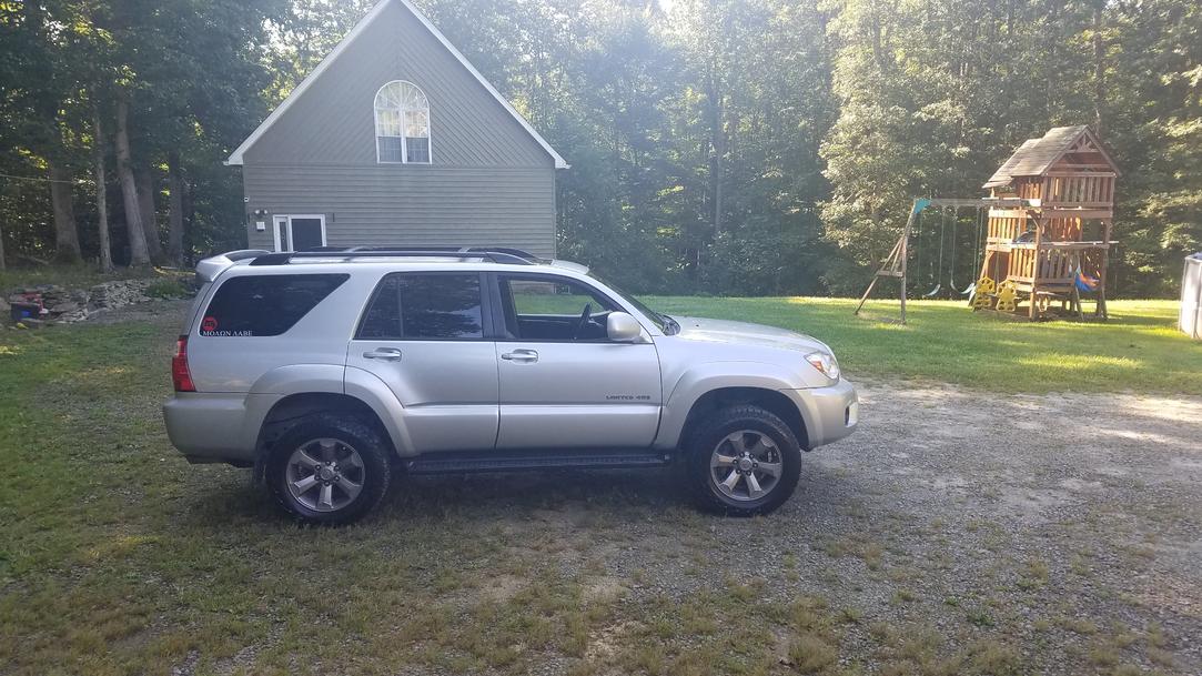

Might be hard to see but the driver lean is pretty real. Have half a tank of gas right now.
Better shot here where you can see it with the line running across the top. Should I put in a spacer? It’s off by about 3/4”?
I have FJ coils in my rear and had a really bad lean as well. I recently installed some 5100s in the rear and while doing so, I added a 1.5 Daystar spacer on the driver's rear. Now the rear end is completely level. Hope this helps ya.

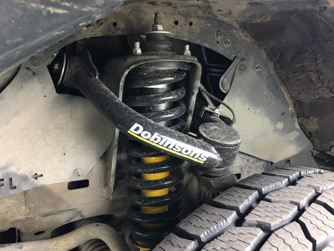

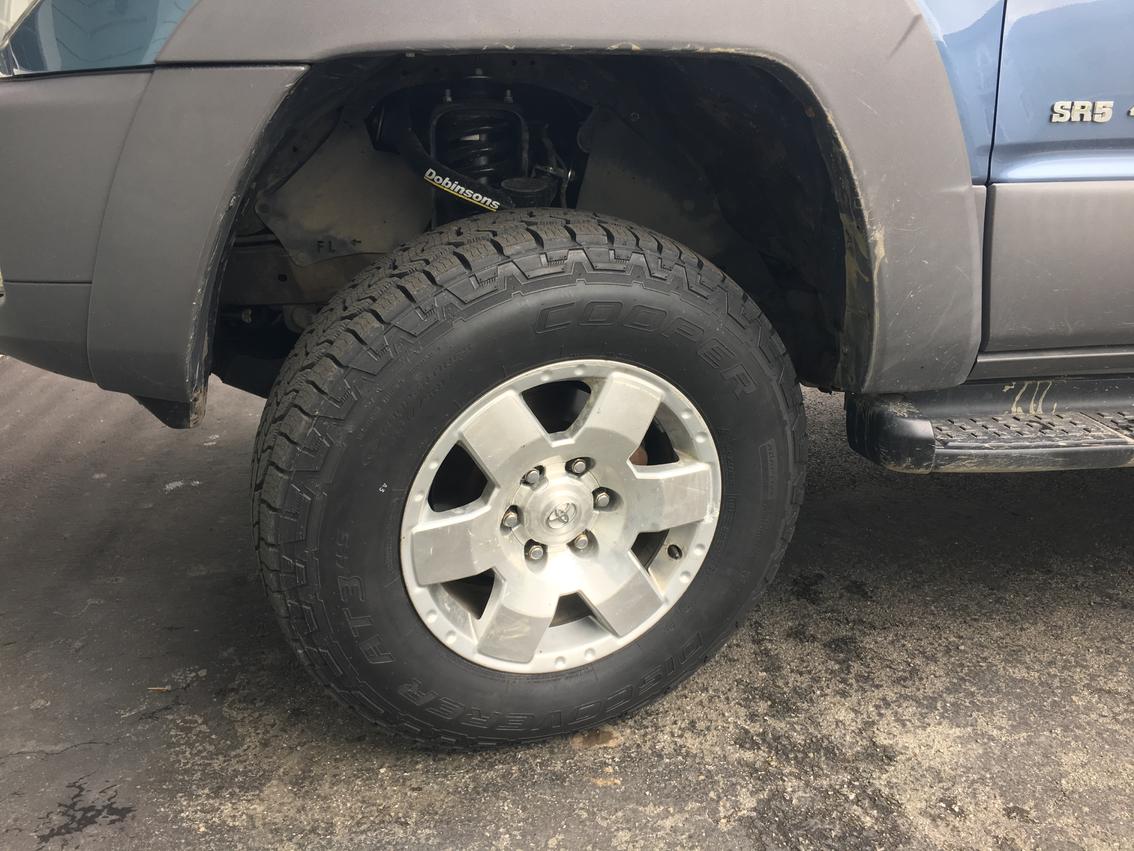

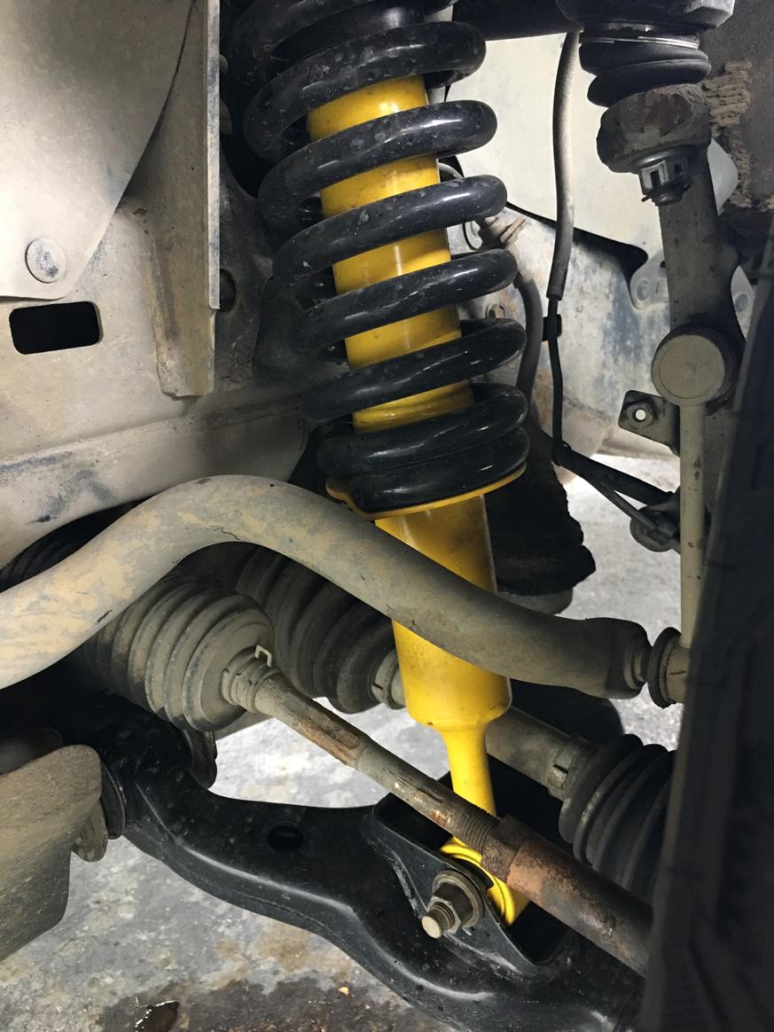

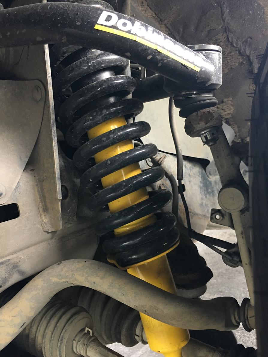

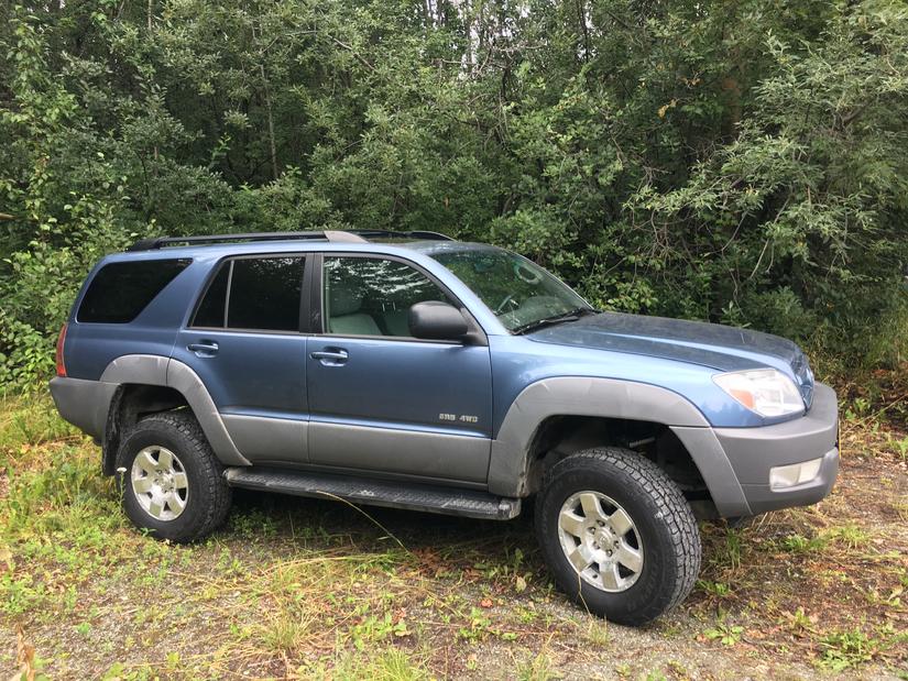

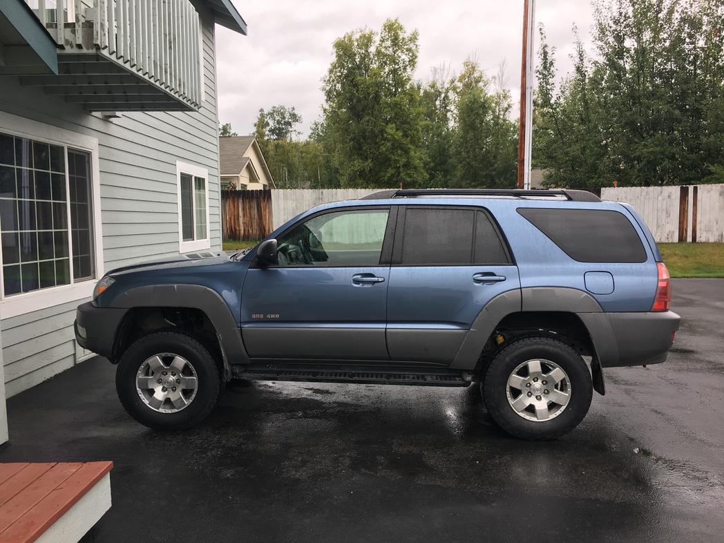

Finally got around to installing my Dobinsons setup from Mike. 314's up front, 505's in back, Dobinsons struts and shocks, Dobinsons Upper Control Arms. It turned out beautifully, and the alignment came in nicely, as I replaced the LCA's and the cam hardware while I was at it. Still settling in on the new wheels/tires OEM FJ Aluminum with 255/75R17 Cooper Discoverer AT3 4S. Thanks for all of your help Mike!

Adding a few more close-ups. Hopefully some better detail.

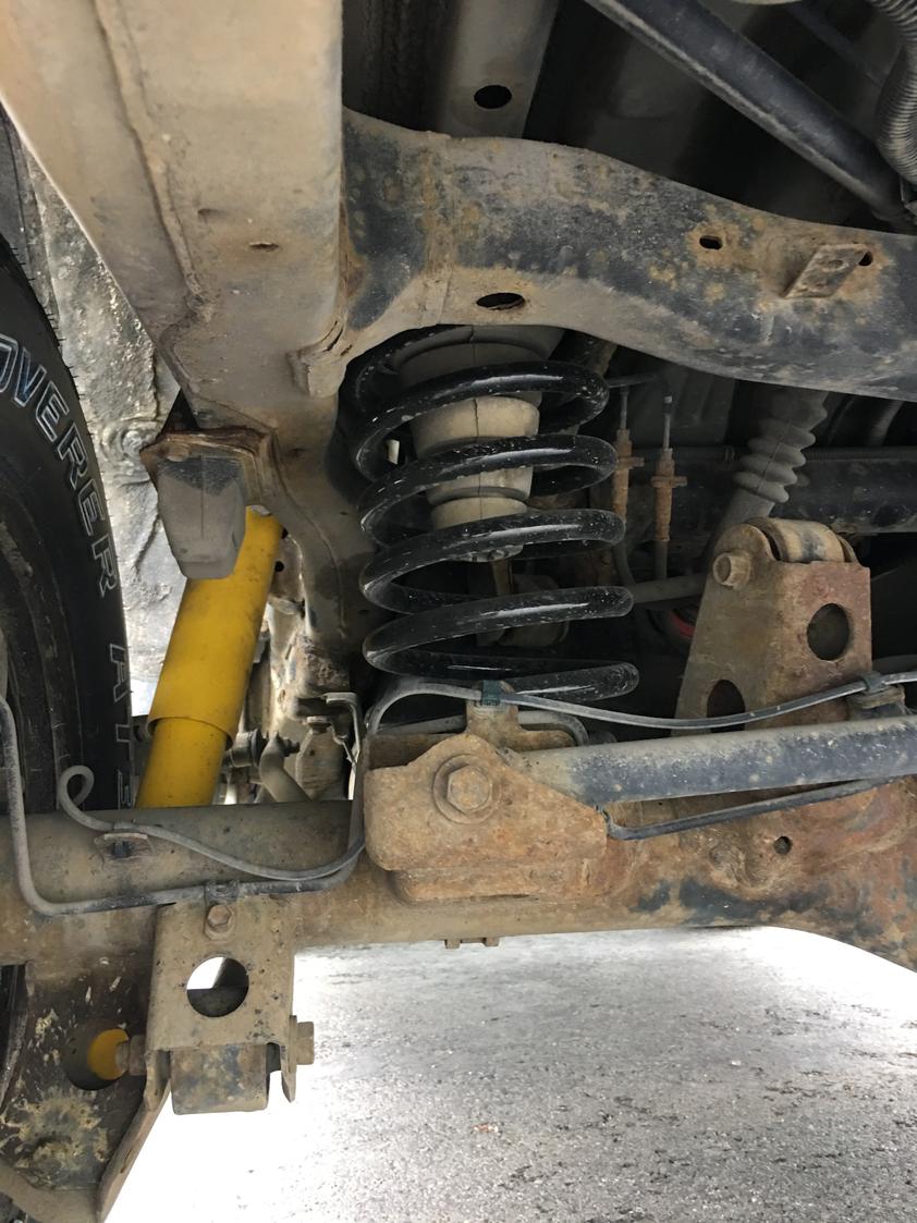

finally got my springs installed. dobinsons 300 front, 323 rear. i replaced moog fj fronts and moog stock replacement rears and its a huge improvement in ride. gained about an inch in the rear and probably an inch or so in the front over the fj springs.
