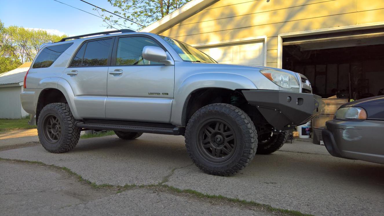

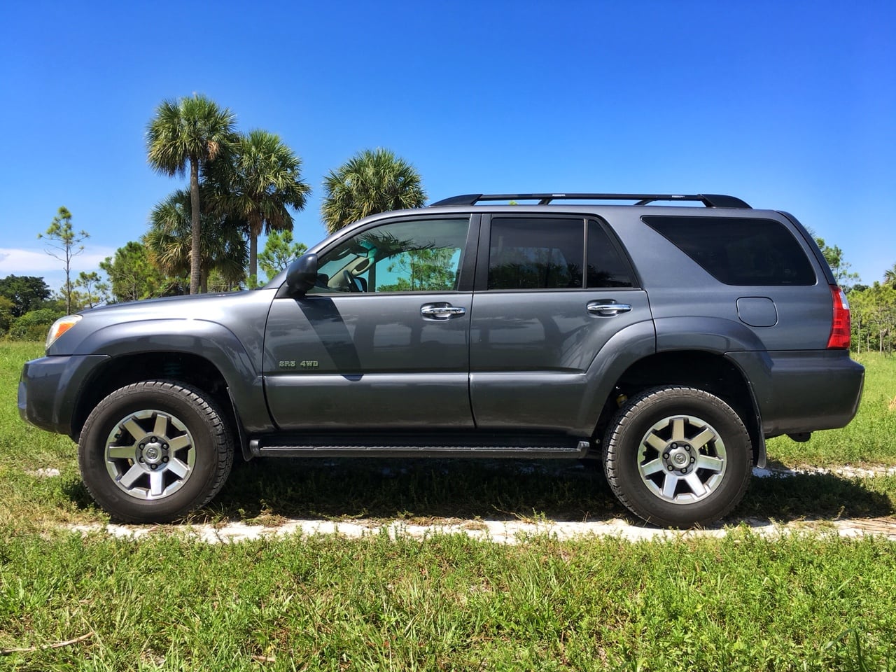

Just installed C59-300/GS59-221 up front and C59-505/GS59-705 in the back. Loving the look and feel of the suspension.
Before:
After:

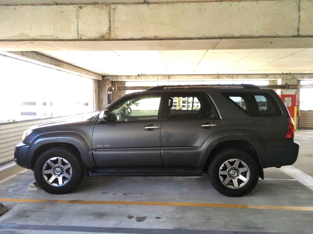

regarding C59-677V coils
Just installed these rear coils on my 09 4runner.
I have approximately 100lbs of cargo in the rear now, in addition to:
rock sliders: 120lbs
skid plates: 100lbs
roof rack: 60lbs
measurements are as follows (approximate as I was on a slope facing up it)
Front:
D: 39 1/8
P: 39 1/4
Rear:
D: 40
P: 40 1/4
love these coils!! Thanks Mike, they gave me the lift back after I added weight, and the superflex just couldn't keep up. Plus they ride VERY VERY VERY nice!! I was worried they'd be too tall, but they're not. Just hope they can hold the weight of a rear bumper when I eventually get it, without sagging more than 1".

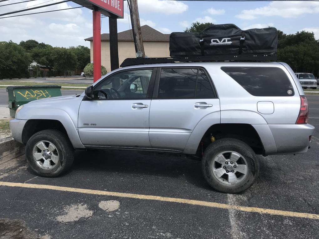

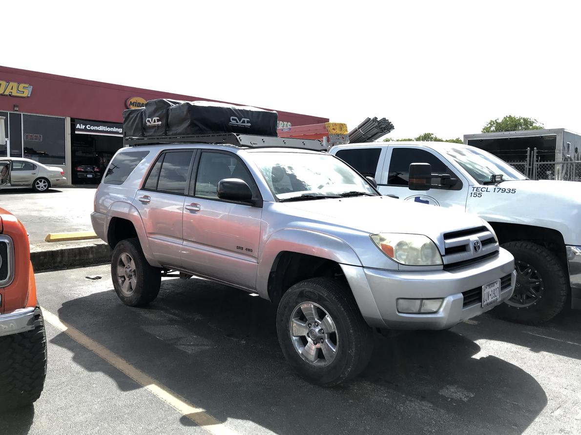

Mike, I installed the 300's on the taller front shocks for 3" front, and 677's in the rear. I also added a toytec 1/4" spacer in the drivers front, and OME trim spacer in the drivers rear for the drivers lean. BUT. I still have drivers side lean! The same amount as before!
With my RTT and rack, and tools in the rear, I got exactly 3.75" lift all the way around. I expected to get over 3" front and rear compared to previous measurements, I definitely had 200K worth of sag on the original springs. Also, ride is amazing, when loaded down in the rear with camping gear its even better. Love the setup, handle and ride is everything I wanted. I think I'll end up going up one more spring rate front and rear in another year or so once I start doing armor and bumpers but for now its awesome.
Also, for anybody who's interested, I lose exactly 1 inch in the rear on both sides from a weekend's worth of camping gear.
Drivers side lean is just driving me crazy. I can't figure out why I would still have exactly 1/2 inch of lean, AFTER the spacers were installed. Any thoughts? I'm considering adding a 3/4" spacer on the drivers side front, and moving the toytec spacer over to the passenger side to try to correct. That seems excessive though. Would love any suggestions.
