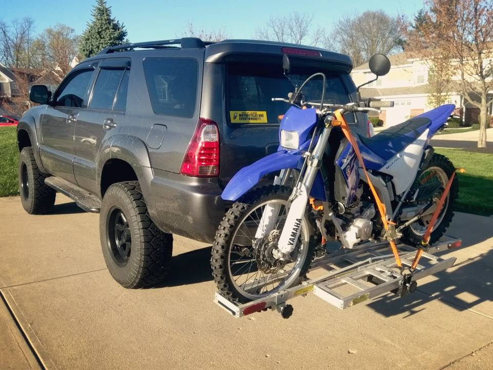

Fine fine fine. Got a good first test on these bad boys last weekend picking up a new project but this bike engine rebuild has got me too busy for more 4runner play time. 300lb of weight cantilevered off the back and only 5psi in the airbags (minimum just to keep them in place, normally I'd run 25-30psi with a bike on the hitch but wanted to test the springs) barely any sag and rode great, like there wasn't even a bike there. My old springs would have been dragging the hitch hauler backing out of this spot and handle like I was doing a wheelie the whole way home. So I'm keeping the Dobinsons! Can't wait to get them more off-road than my backyard.

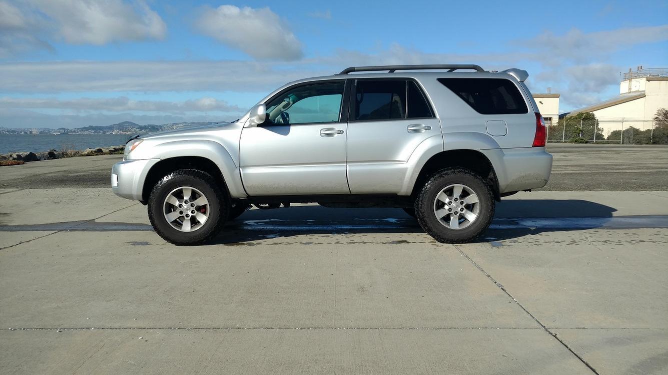

replacing the 180# OE Fj coils with the 59-599 @ 220# yielded me a bit like 1"+ lift wise but the ride is great paired with the icons. I have about 300 miles on um. Also in the pic theres no weight @ all in the back.

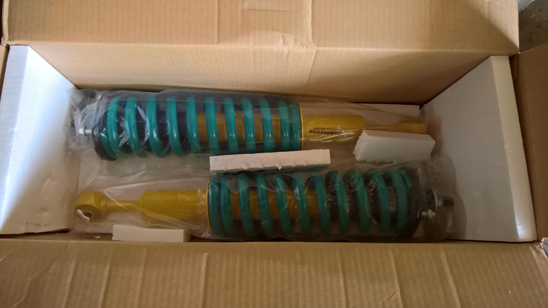

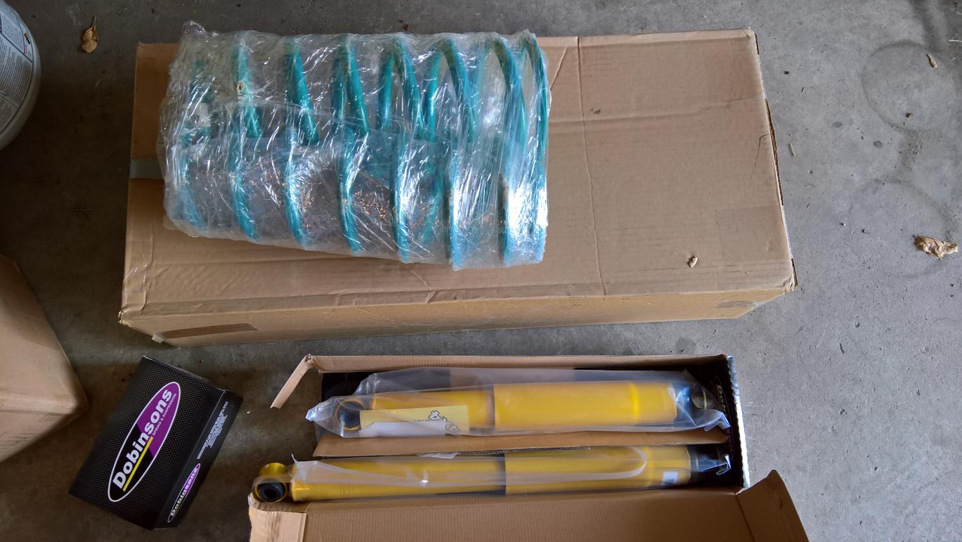

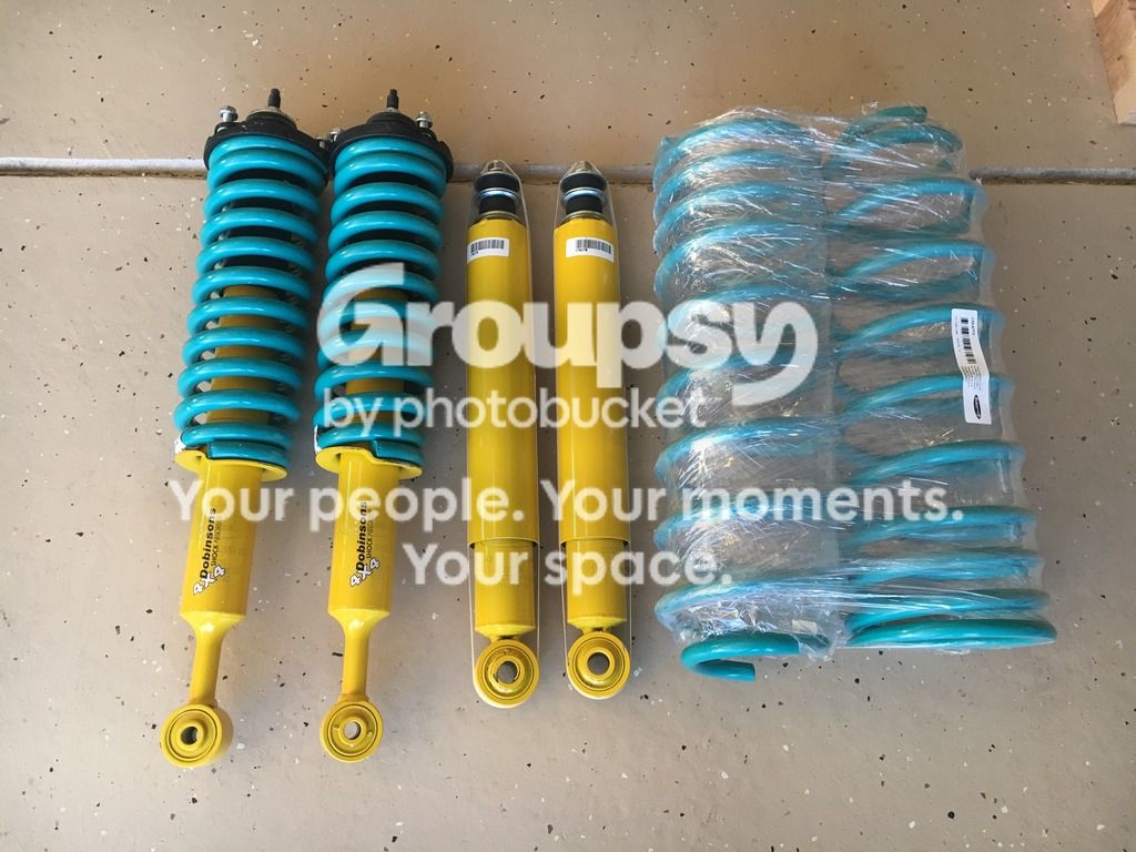

Just put in my order with Mike here. If anyone is on the fence Mike was a good resource in helping me figure out just what I wanted for my T4R, and answered all the questions I had promptly. Now the waiting game for UPS and finding a time to do an install.
Can't wait!
The specs:
Front: C59-302 coils / GS59-220 struts (~3" lift)
Rear: C59-677V coils / GS59-575 shocks (~3" lift)
Look what came in the mail today!
