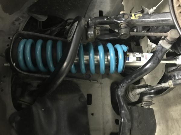

Installed the 675V medium variable rate coils yesterday on the Treaty Oak Offroad GX. The ride is definitely improved when paired with the MRR coilovers and shocks. The medium variable rate coils only provided about 1.75" of lift vs the 2.25" I had with the C59-314 linear coil, but with the improved ride I think i'm going to leave them. I need reduce a little preload up front by about 1/2" to get a little rake back.

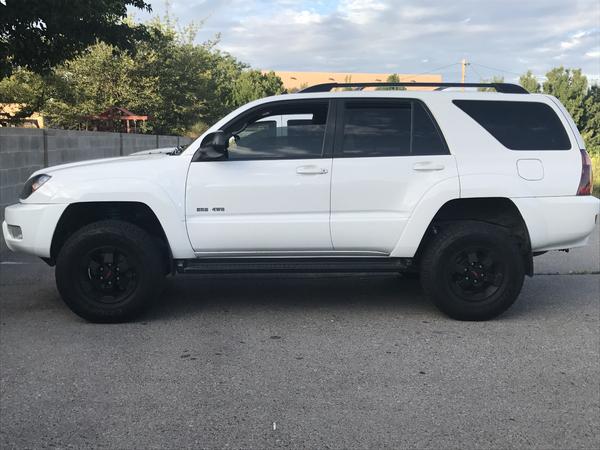

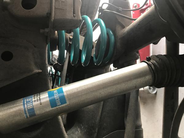

Installed my new Dobinsons springs. 300's in the front and 599's in the rear. Bilstein 5100 shocks all around with the front set to the lowest clip. Tires are 265/75-16 Cooper AT3's.
Fender to ground is 37" on both fronts, 38" on the left rear, 38.5" on the right rear. This is using an OME 10mm rear trim spacer on the driver's side.

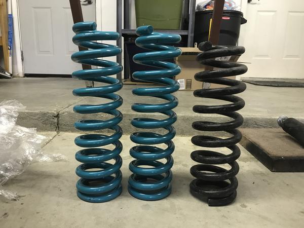

Some comparison pics to my old Moog Coils. Fronts were the V8 version, rears were the stock replacements. I previously had the Moog V8 coils with the 5100's set at the 3rd notch and now with the Dobinsons 300's up front with the 5100's at the lowest clip I am sitting 1" higher in the front. Also, I gained about 1.25" in the rear with the 599's vs. the Moogs.
boostedka-albums-dobinsons+suspension-picture47135-dobinsons-c59-300-vs-moog-v8-coils.jpg
boostedka-albums-dobinsons+suspension-picture47136-dobinsons-c59-599-vs-moog-stock-replacement-4runner-coils.jpg
The Dobinsons design seated much better in both the front and rear of the truck during the install.

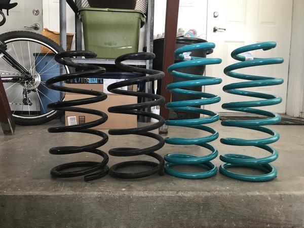

Good to hear man!! The stance from front to back looks really good.
