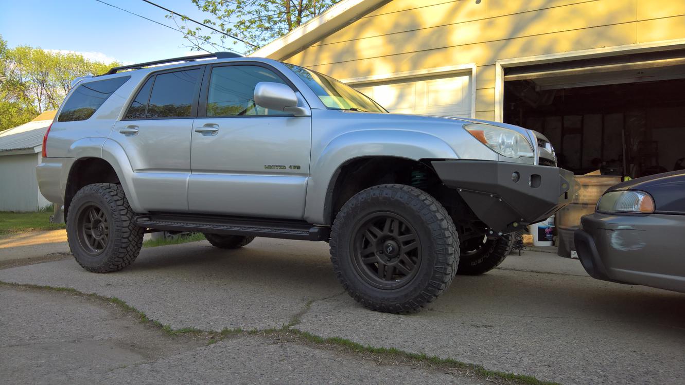

Got them installed last week. Here is the one pic I've taken so far. As you can see, Shrockworks front bumper. It's 24" from center of hub to bottom of fender front and back. The ride quality is awesome, though I was coming from a very tired 100k+ miles, stock suspension. Here is what Mike hooked me up with for those that are interested. Highly recommend Mike and Dobinson's, he was super helpful I basically just told him how I use my T4R and what other mods I have done and he will help configure what is just right for you.
C59-314
C59-325
GS59-221
GS59-637

Very cool!! The truck looks awesome. I just got back from Overland Expo West, and I used you as an example to several people out there. So many 4th Gen's at the event were sagging big time, so I was filling everyone in about all our coil options for these trucks to get them fixed back up and riding like they're supposed to.
