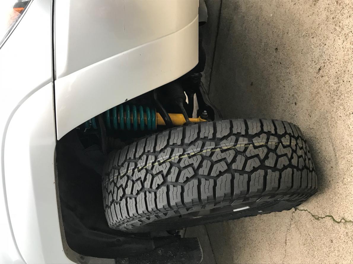

I have the 2.5”/1.5” lift setup with 255/80/17 on 5th gen trail wheels and did not have to do the bmc. I did get a lot of rubbing once I put 1.25” spacers on so I did the bmc after that. Stock wheels you should not have any problems.

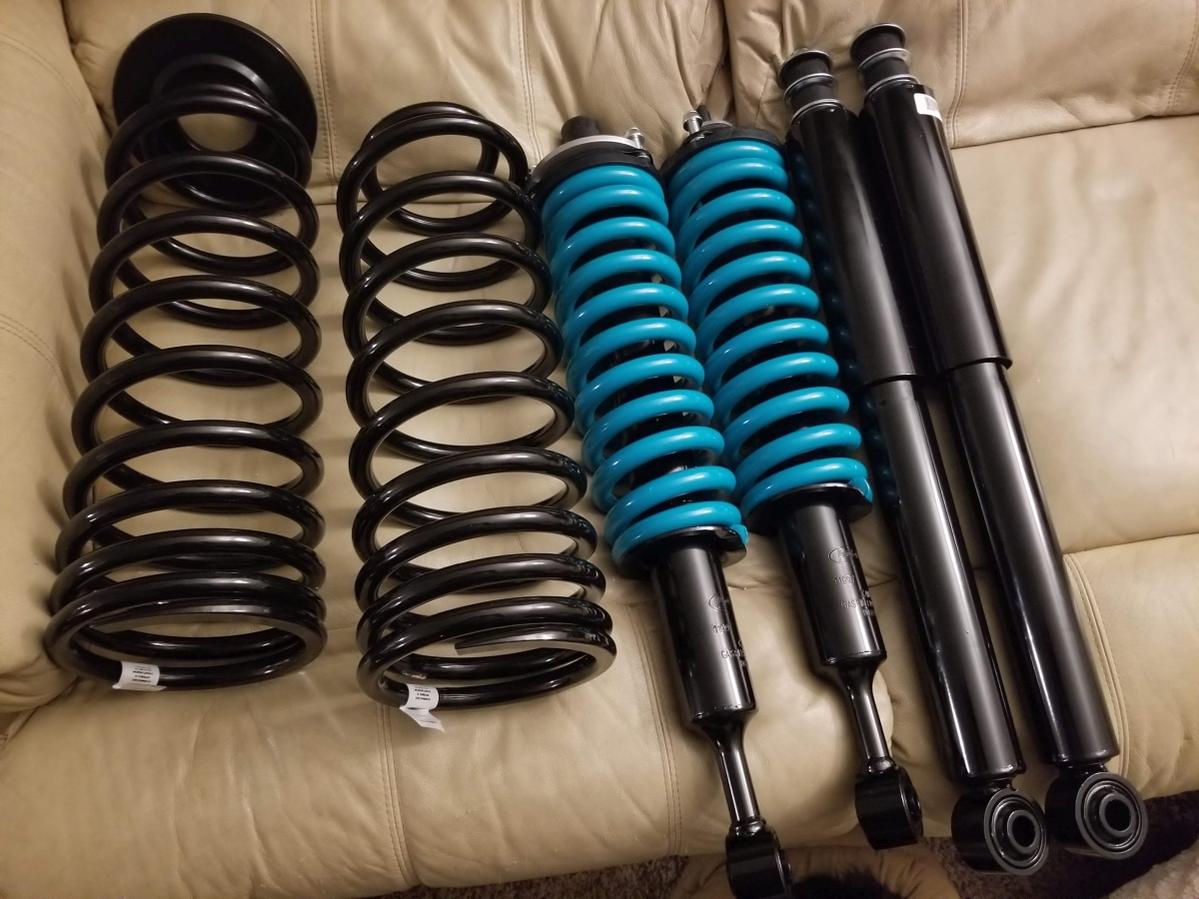

So hyped—Black Friday order came in today. Going to install in a few weeks with a friend; 300/221 front and 505/637 rear

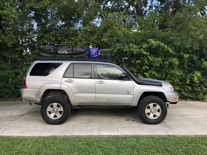

Soooo I've talked with mike multiple times about this. I have the following setup:
Front-300 springs on 1" lift struts
Rear-677 springs on 575 long travel shocks
I gained a net 3.75" rear and net 3.875" front lift (ground to fender), compared to my 200K stock suspension with sagging springs. This increased to net 5" rear and net 4.875 front after I added 255/80/17 tires. Rear net increased more than 1" because of the relocation of my heavier spare, pretty sure that evened out some of my drivers lean, giving me more net lift in the rear.
Rides great, but I've still got a solid 2" rake front to back. I know this will be reduced once I add a rear bumper, and a drawer system, but I'm also planning on long term removing the RTT and adding a trailer instead. Basically, the rake I currently have is driving my OCD a bit crazy, and I want to do something about it. I only seem to lose an inch at most when loaded down. My thought is I'd rather go from 1" rake to level, or even slightly reversed rake when loaded down, instead of 2" rake down to 1" rake. Most of the time I drive around empty, so most of the time I see it with the rake in the pic. Only thing I'm not sure about is how much rear height I could expect to lose after I've done a full dual swingout rear bumper.
1) What would be a good rear setup for me with the RTT, rack, tools, camping gear, and future rear bumper to lose 1" front to rear rake?
2) Anybody interested in trading out a 327 rear spring/shock combo for my 677's and long travel shocks? (Got about 5K miles on it currently)
3) Am I just being impatient, and should I just deal with the rake for another year until I get my rear bumper? Is it possible that the addition of a dual swingout rear bumper would completely fix all my problems, and give me the perfect setup with my existing springs?
At this point I'm figuring I can drop the rear an inch, then add a 1" body lift, I"ll get a little wheel well clearance, get the height I want, and not have to mess with my front suspension at all.
Note: I also talked with Mike about possibly just adding a small spacer in the front to bring the front up a bit. Given how much lift I already got from the suspension components, he was concerned about binding CV's at full droop. My CV's are great on the ground, and I don't have any binding issues right now, I really don't want to mess with that. So adding more suspension lift for the front is something I'm staying away from.
Rides great, but I've still got a solid 2" rake front to back. I know this will be reduced once I add a rear bumper, and a drawer system, but I'm also planning on long term removing the RTT and adding a trailer instead. Basically, I want to cut my front to rear rake about in half.
Pic for funsies. Also, as an aside, this is not an indication of a poor product! I literally LOVE my Dobinsons suspension. My 4runner rides better than a brand new one, even when its empty with those stiff rear springs. I think my problem is ultimately a combo of 1) me saying I wanted a 3" rear lift, not realizing how much rake that would create, and 2) me maybe overselling how much weight I was actually carrying most of the time.
Do you have new UCA's on the front? We could add more to it to help level it out.
Ultimately you have the correct rear coils for the weight you "will" add, but still haven't added it yet. That rear bumper will really lever the rear end down once it's added.
I do. Are you sure we could go higher on the front? Last discussion we had you weren't sure that was a good idea. I have wondered if the stock weight front springs I have are being compressed a bit lower because of all of the rack weight I have. I've calculated my roof weight at 315...and that's not JUST in the rear. That front tool box weighs close to 85 pounds.
If I ultimately have the correct rear coils for my ending weight, maybe I need to just hold off and keep my OCD in check for a while.

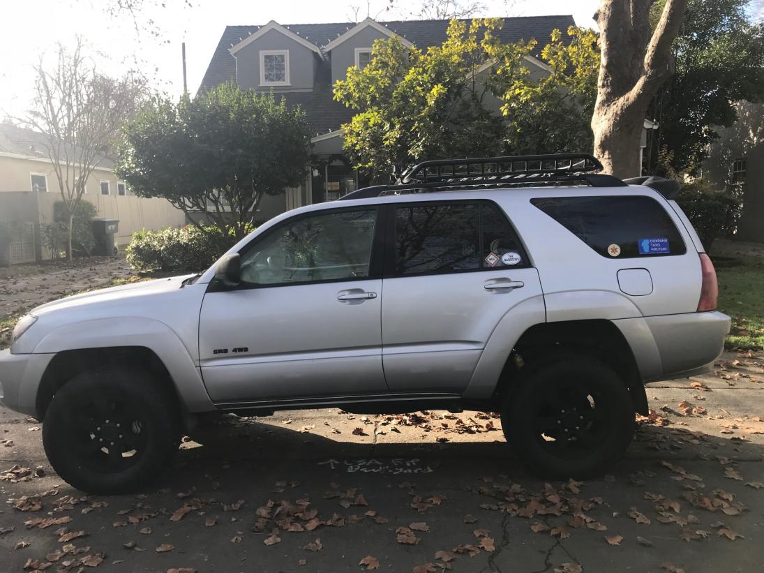

My setup came in two days ago. Teal on black looks really nice. Should be installing next Sunday.
If only the trees rained cash......then I wouldn't have this problem :cry2:
You're running the GS59-220 front struts, right?
Yeah, you could add more height. Looks like there is some weight transfer there. C59-302 is the next step up with 10mm more free height adding about 20mm height (just under 1") at the wheel.
Yep, that's what I'm running!
If you think that's a possibility, that would be way simpler. And I'm guessing if I added a hidden front winch and full rear bumper at the same time, it would still be roughly the same rake, just a tad bit lower and riding a tad bit softer from increased weight.

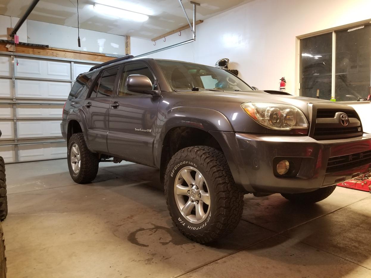

I ordered C59-314 front springs with GS59-221 shocks. For the rear I went with C59-325 springs with the GS59-637 shocks.4runner1.jpg

I ordered C59-314 front springs with GS59-221 shocks. For the rear I went with C59-325 springs with the GS59-637 shocks.View attachment 320936
Looks great. Mine are arriving tomorrow and going in next week. I was thinking about going bigger tires with more lift, but seeing yours I may just stay with 265/70-17. Any thoughts?
I am staying with these since the tires are almost new. They don't look bad but are on the smaller side of my acceptable range. The next set will be 255/80's or 2285's. I'm running rough country 1.5" wheel spacers so the 285 will fit. Plus I've done a BMC on two FJ's and it's not hard.

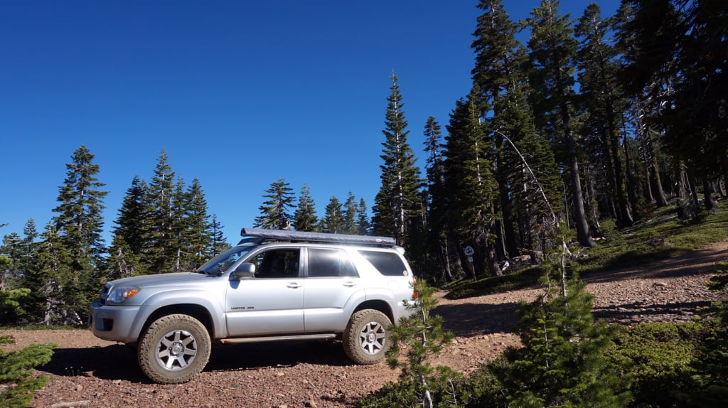

C59-300 - V6 - Stock front end load, 2" lift. 385/385mm, 17mm wire,
GS59-221
C59-505 - Stock rear end load, 1.5" lift. 405/405mm, 17mm wire,
GS59-637
