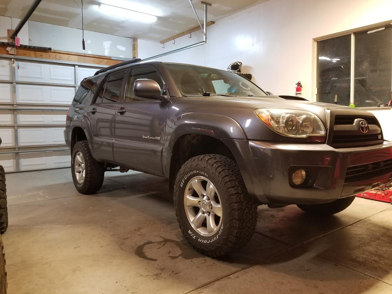

I have about 2k miles on my Dobinson's kit. It has started to settle and I am really happy with the results. I went with OME stuff on previous runner (3rd gen) and it was too harsh. The Dobinson stuff is slightly softer and just perfect in my opinion. Here is my 07 V8 sport on 265/70's.
I ordered C59-314 front springs with GS59-221 shocks. For the rear I went with C59-325 springs with the GS59-637 shocks.View attachment 320936

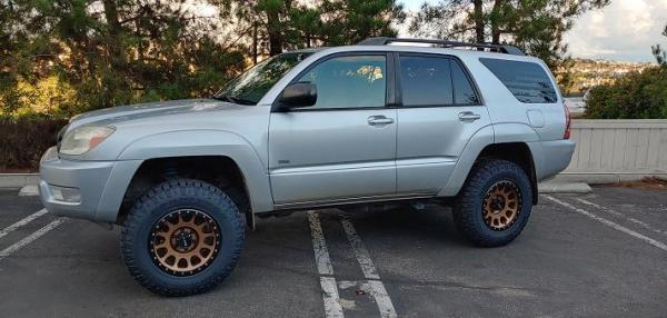

That looks pretty darn level in that shot - is it? I'm looking at this stuff now and was thinking about going with the c59-302 springs, gs59-221 shocks up front and the c59-505 springs, gs59-637 shocks out back, with the goal of having it leveled out. My goal is to run 255/75/17's, so don't really need that much lift...
I'll eventually probably do a budbuilt hidden mount winch, but that's probably the only weight I'll be adding to the front, but that might be a while off....
Based on my experience you may end up a little high in the rear.
Got mine in this week. In hindsight, I might have gone slightly lower in the rear. Have to see how it sits when I'm loaded for camping.

Thats some real Bro Rake right there, something doesn't seem right...
It has a little rake but not as much as it did from the factory. I do have about 60lbs of drawers and tools in the back. With my Yakima bike rack (40lbs) and my mtn bike hanging off the back it is perfect, just barely any rake.
If you are putting more weight in the front and don't want any rake I'd go one coil lighter in the rear.
How much was your "complete kit" and did you get UCA's or keep stock? I priced what you had at DobinsonsDirect and total came out to $1620 before tax and before adding the option of them building the front shocks so I don't kill myself with the coil compressor.

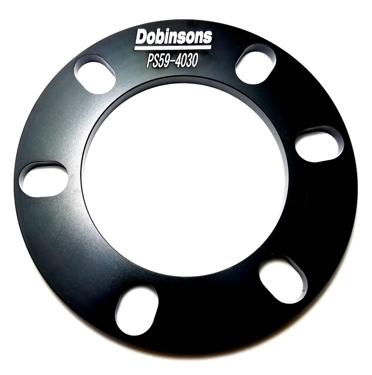

We finally received our Front Top Mount Strut Spacers into stock this week.
PS59-4030 - Single 1/4" machine alloy strut spacer, anodized black, suits almost all Toyota's from the 90's to current. Drilled with 2 bolt patterns to fit multiple vehicles. 4Runner 3rd, 4th, and 5th Gen. All Tacoma's 1998 to 2019. All GX470/460. All FJ Cruisers. Can be used to correct a vehicle lean if one exists, or to add one to both sides to add 1/2" lift.
$35 each
