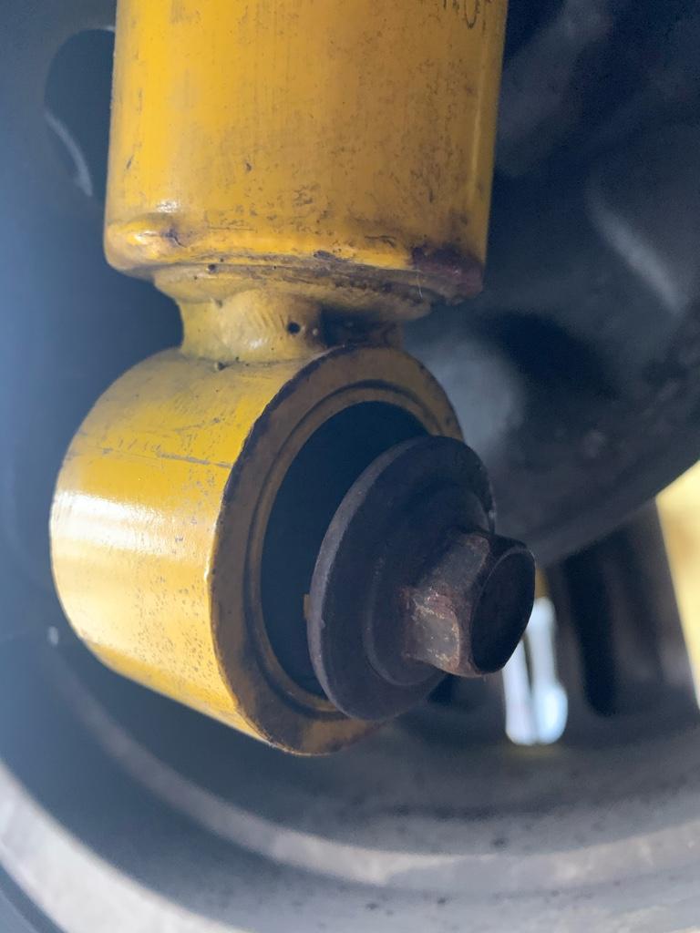

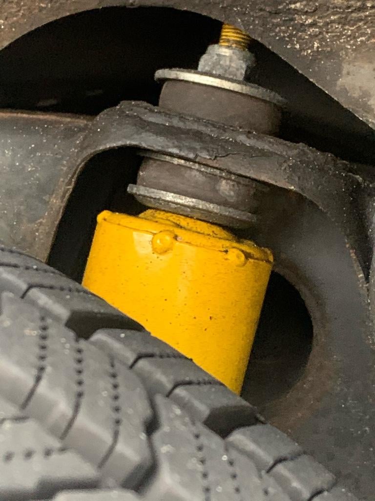

After listening to the noise a few times, it does sound like metal to metal high pitched squeaking. Going to do some maintenance this weekend so I’ll take a closer look on the lift. Just to make sure, is the rear shock installed correctly?
Bushing don't look compressed enough. It should meet the outer edge of the washer. If I had to guess. The stud of the shock is touching the metal mount
Thanks for the input! I’ll tighten them up more.
I'd suggest you take them off and lower the shock to inspect the shaft. It would be shiny metal if it was metal on metal contact. Then you can make sure the centering washer (with the lip) is facing upwards in the mount properly, then tighten it down.
Got it tightened up and the noise is gone! I was checking the rear shock lower mounts and noticed that the paint chipped off and saw some possible rust. Is that type of wear normal?

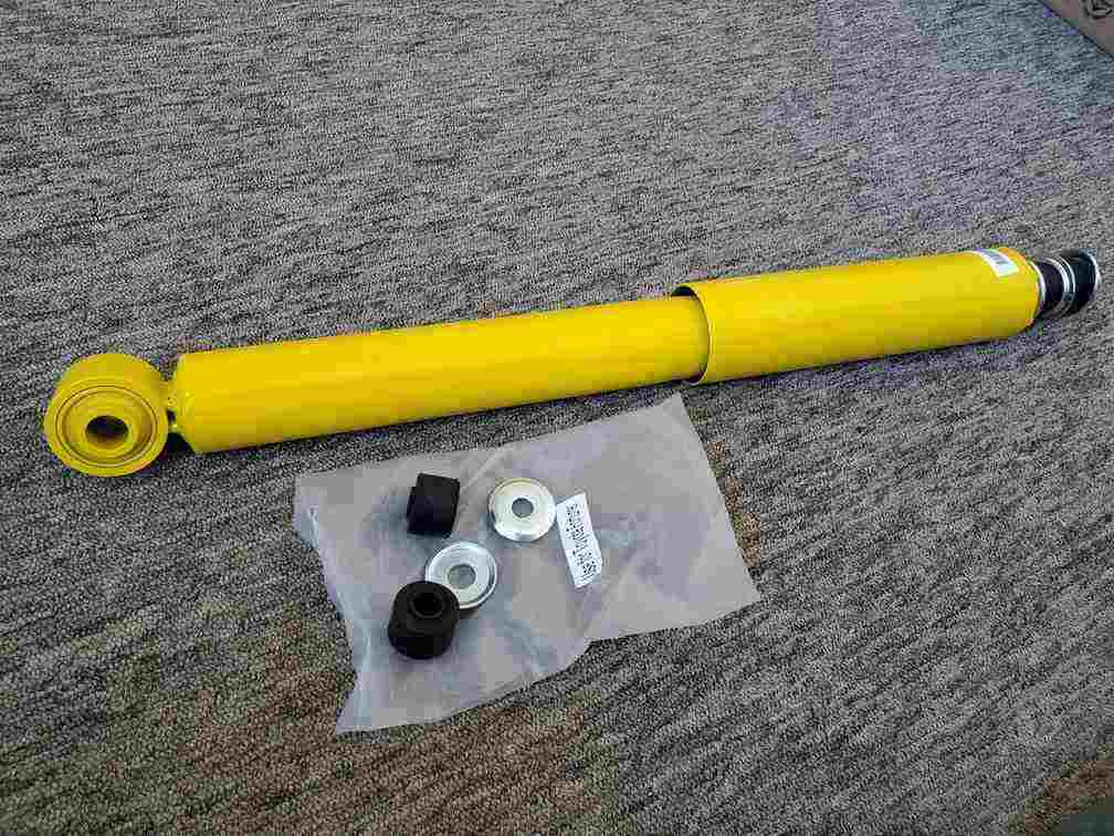

I'm probably gonna sound clueless, but just to be safe, in my box for my rear shocks for my 2007 4runner (GS59-705), I received two bags, each with a set of 2 bushings and washers marked, "for Toyota Fortuner." Just wanted to check and see if these are in fact to be put to use on my 4runner, or if they're only used on that other vehicle. All the top bushings and washers are already attached on the shock. I've attached a picture if that helps. Thanks!!
It's a good question. You will just use the bushings on the shocks. Match the bushing orientation to the way the original shocks are removed.
The Fortuner ones are for the Toyota Fortuner, a different smaller SUV sold overseas that uses different size bushings and washers.

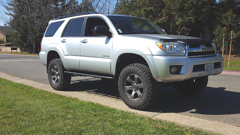

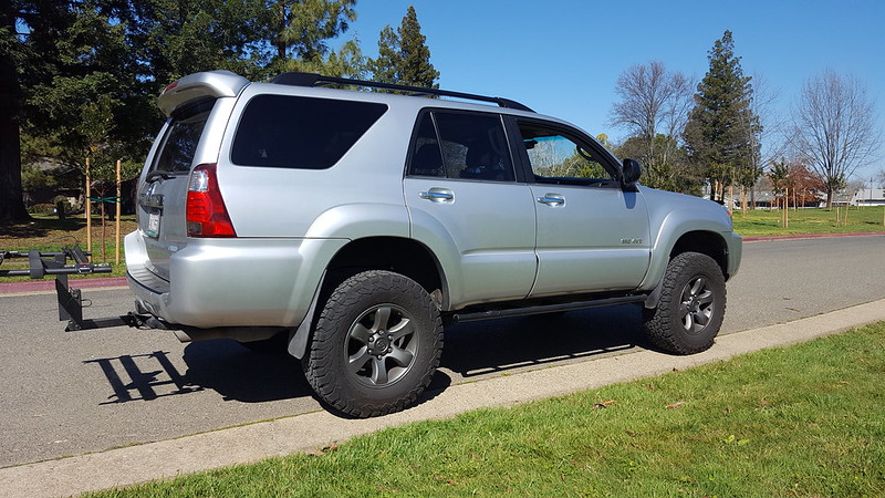

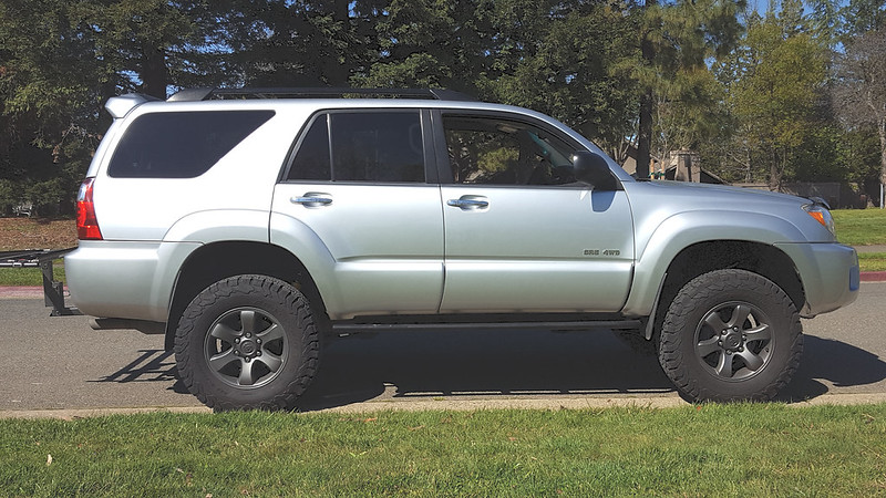

Got them installed last week. Here is the one pic I've taken so far. As you can see, Shrockworks front bumper. It's 24" from center of hub to bottom of fender front and back. The ride quality is awesome, though I was coming from a very tired 100k+ miles, stock suspension. Here is what Mike hooked me up with for those that are interested. Highly recommend Mike and Dobinson's, he was super helpful I basically just told him how I use my T4R and what other mods I have done and he will help configure what is just right for you.
C59-314
C59-325
GS59-221
GS59-637
Mr. Eeks, I like your suspension! I couldn't find your signature with the kind of 4runner you have. Is it a V6 or V8 ? I would like this same look but have a V8. How does it ride for you? How do you use this ride?
What ended up being the total lift front/back ? Thanks.
