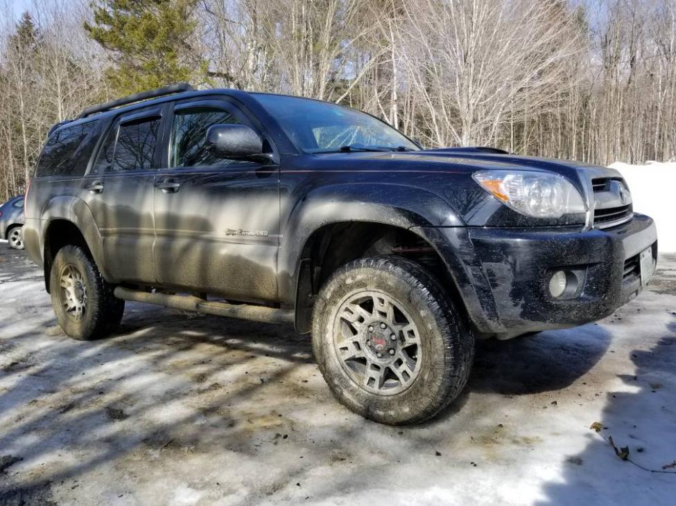

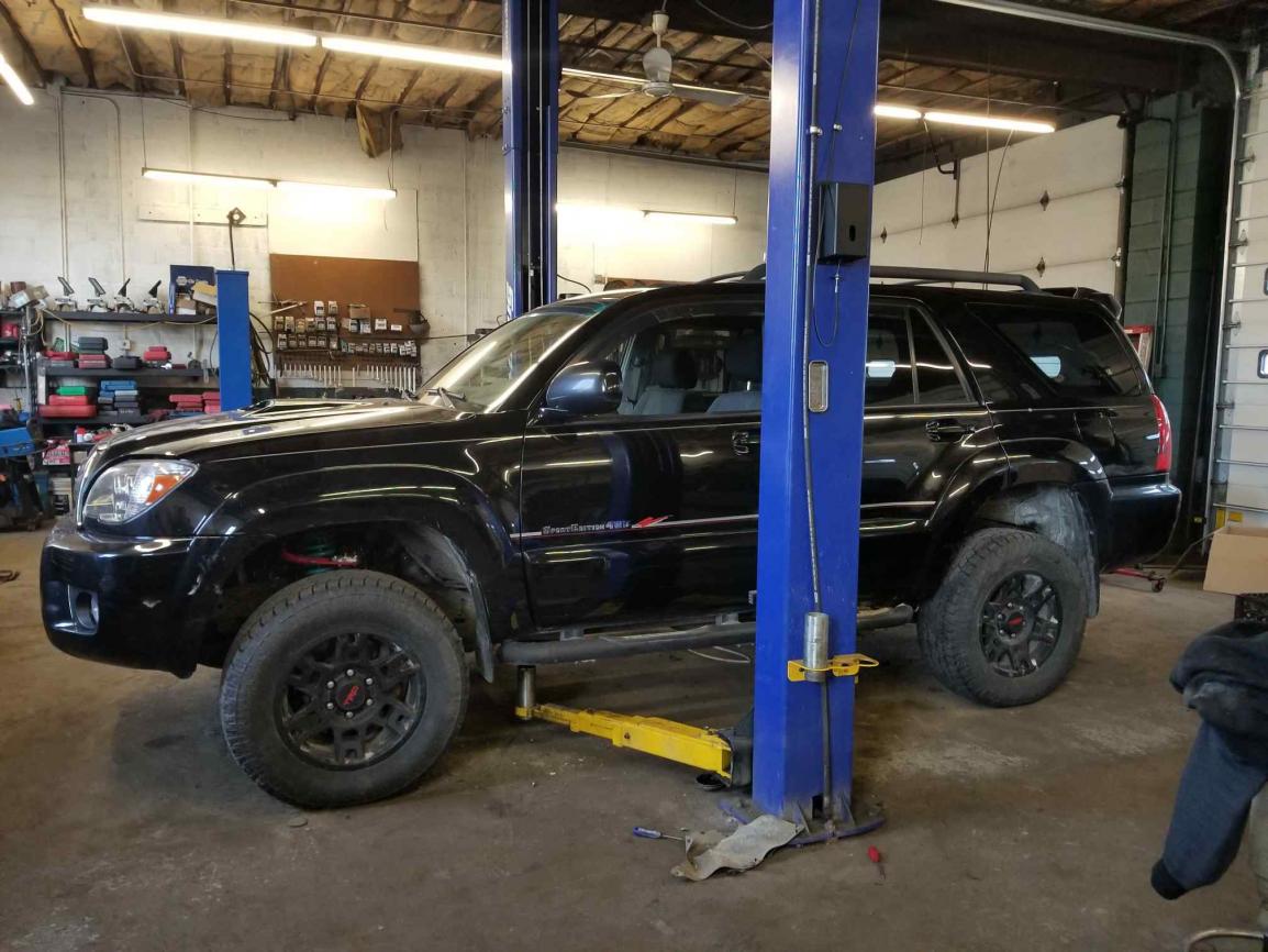

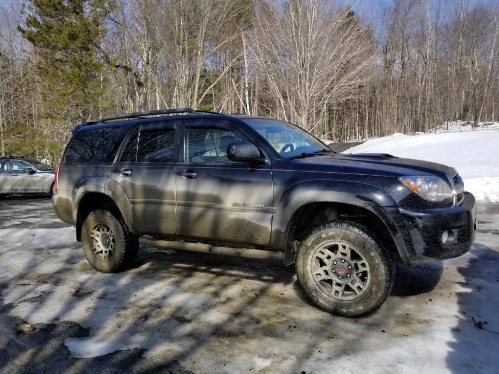

Got the lift installed today! Mike, thank you so much!
I went with what Mike suggested and it rides great! So much better than the bilstein 4600's that came off of it.
Cracked roads, frost heaves, potholes, irregularities and washboards have gone from jarring to a smooth bumpiness. The highway ride is also excellent. Along with the JBA UCA's I went with it feels incredibly planted.
Specs are as follows.
GC59-300
GS59-221
GC59-505
GS59-705
Also are the JBA UCA's
GC59-300
GS59-221
GC59-505
GS59-705

Looks good man, thanks for the pics. Almost looks taller in the front than other's who have posted pics with the 300's.
Any chance you could take a picture of one of the CV axles from the front? I'm curious how the CV angle compares to my suspension...this gives me a way to gauge how much lift this setup will give.
Also, what tire size are you running?
Thank you my man!
You know, I thought the same thing about the way it sits, but I'm not disapointed with it in any way at all. I am however kicking myself for not measuring before the install though.
I'm currently running stock size 265/65/17 Toyo Open country AT/2's. They look a little small now IMO, but I'm not going to change them for a while as the tires only have 14k miles on them. Eventually I will go up to either 265/70 or 275/70.
I'll post CV axle pics either later today or tomorrow, but the angles look just fine to me.

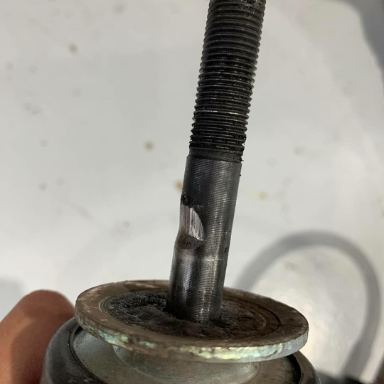

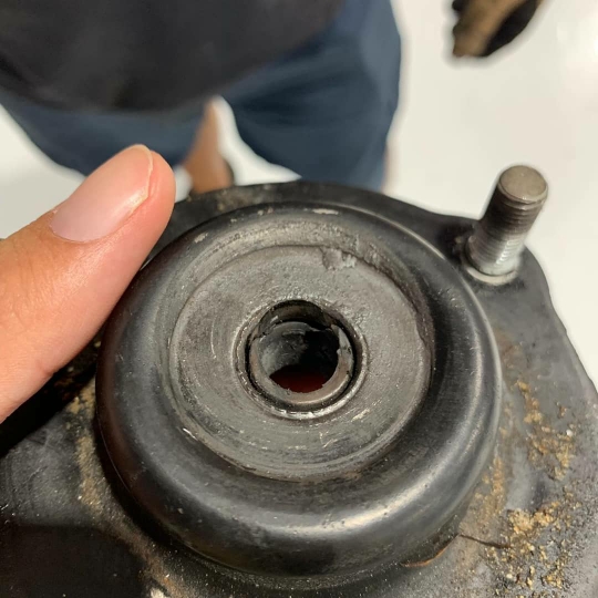

I installed the Dobinsons 2.5 lift on my 07 V8 about a year ago. I have since been chasing down a clunk on front passenger side. I have since replaced lower control arm, sway bar bushings, endlinks, sway bar relocator( thought it may have been hitting coil). Also JBA UCA. Clunk still present only over washboard type bumps and speed humps. Trucks rides and handles better than new. I'm starting to wonder if it's the shock making the noise. Any thoughts?
Front Springs:
C59-314 - V8 - Stock front end load, 2.5" lift. 405/405mm, 17mm wire, 586LB
Rear Springs:
C59-505 - Stock rear end load, 1.5" lift. , 220lbs.

Could check the dust boot/cover to make sure it didn't come loose. Put car in the air so the strut is at full extension and see if the boot moves. If it does, either the top mount isn't tightened down all the way, or maybe the boot got a bit sideways during assembly. A guy yesterday posted that exact issue in his own thread.
The shock can't really make a clunk. It would have to be blown and have no oil to do that so you would see oil everywhere.
I'll check that. It never crossed my mind because its such a solid clunk. Do you happen to have a link to that thread.
It is not loose. I've checked and double checked. That's why I'm wondering if its shock related I've covered the rest I think.
That's what happens when strut bushings are loose and it makes a clunk when the strut shaft hits the top mount due to excessive movement.
