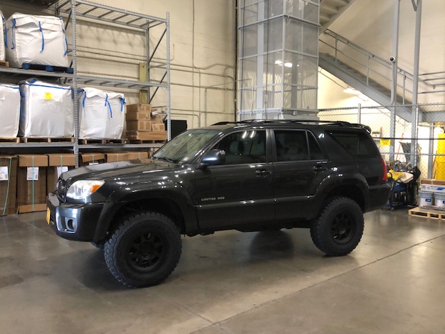

2007 V6 sport
C59-302 GS59-221
C59-325 GS59-701

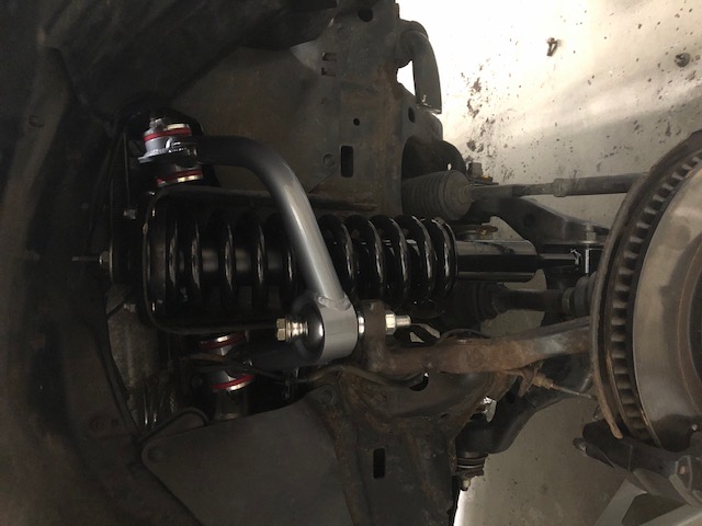

illustratedman-albums-2007-v6-sport-picture57221-7cb4939a-6523-4e69-9a78-020814f5108b.jpeg
illustratedman-albums-2007-v6-sport-picture57220-01458441-40c9-475c-adea-270069df50e3.jpeg
Huge thank you to [MENTION=148378]Crikeymike[/MENTION] for prompt email responses to my questions and the amazingly fast shipping. Put my order in Tuesday and shipped the same day, had it in hand Friday!!

Looks great man!!! And you're more than welcome!!

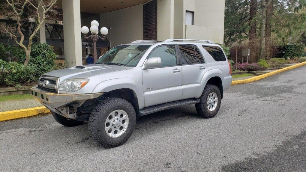

What rear coil shall I choose ?
I have a 2004 V8.
4WD
4,515 lbs curb weight

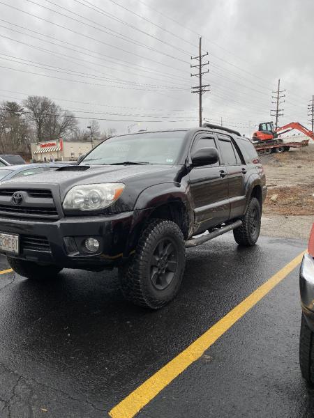

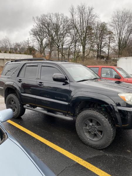

Hello! I have purchased a set from you guys a couple of months ago but I only got a chance to install it a month or so ago and wasnt driving the truck (07 v6 sport) until yesterday.
For the rear I got C59-677V + 559 long travel -- very happy with the way rear behaves.
For the front I went with C59-220 + C59-350 as per Mike's recommendation. I have installed the bumper (110 lbs) as of right now and the ride it terrible. It feels like I am riding a skateboard. The truck shakes on the speed bumps and I dont think I can live with that. The winch is going to be mounted soon (60 lbs?). Should I expect that it would make a difference? Is there a brake in period in which the springs would get softer? I am concerned how its going to ride of the pavement now.

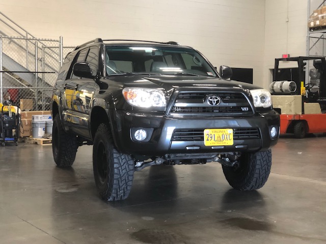

My 08 4runner
Thank You Mike, great working with you !!!!!
Suspension worked out perfect love the look and the ride. Went with all black super happy
Front: C59-314 w GS59-221 1/4" spacer on driver side, Total Chaos UCA's
Rear C59-325 w/GS59-701
Running 255 80 17 Toyo Open Country RT's on Method 701's

ALL BLACK EVERYTHING!!!! Looks great man!!

The C59-350 is a 730lb coil according to Mike... that's a hell of a beefy coil.
My buddy has OME 886 coils up front which is a 660lb coil and he's running a winch and ARB bumper. 730lb seems excessive for a CO bumper which is much lighter than a ARB.
