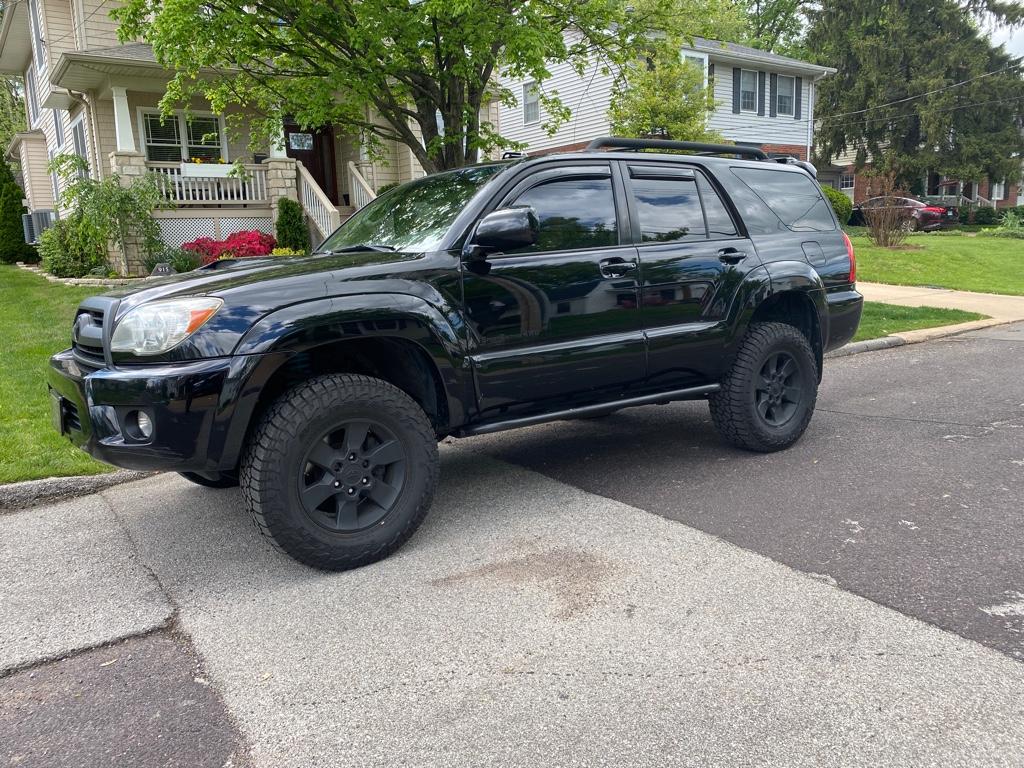

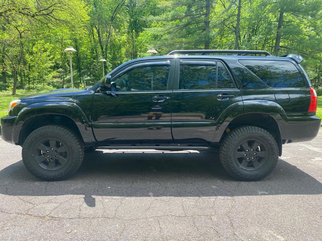

Suspension worked out perfect love the look and the ride. Went with all black super happy
Front: C59-314 w GS59-221 1/4" spacer on driver side, Total Chaos UCA's
Rear C59-325 w/GS59-701
Running 255 80 17 Toyo Open Country RT's on Method 701's
Dig your setup setup as I'm planning to go with the 255/80 pizza cutters and I have the V8. Did you need to do any trimming or a BMC to fit? Also any reason you choose TC UCA's as opposed to going with Dobinsons?

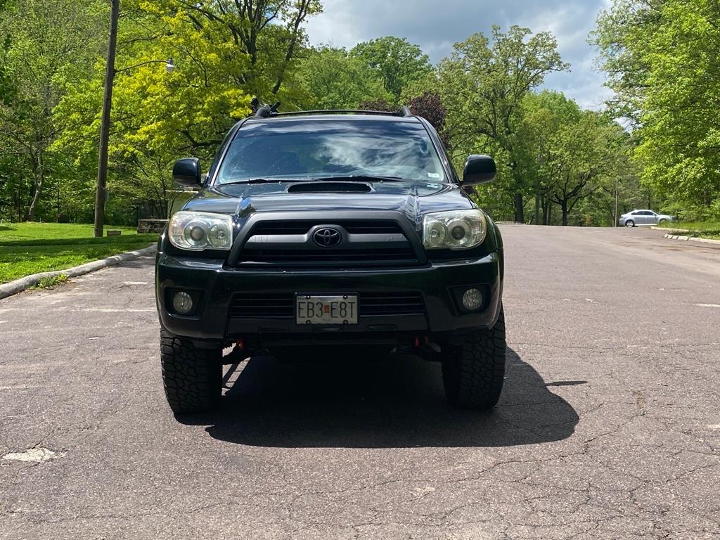

Here’s some updated pictures with a little weight and time to settle.
302-221 front
325-701 rear
RSG sliders about 125#
LFD front skid about 50#
Measurements from center hub to fender 22” driver front 22.5” passenger front
23.5” driver rear 24” passenger rear
Eventually I’ll put spacers in.

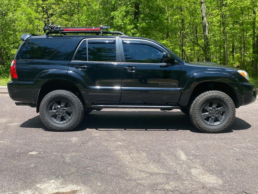

Finally put everything together and got a chance to take some photos.
Pretty happy with the rear setup so far, comparing to the 5100 with spacers. Extra flex is so much fun.
The front is a bit stiff yet, but I am hoping that a winch is going to fix that.
