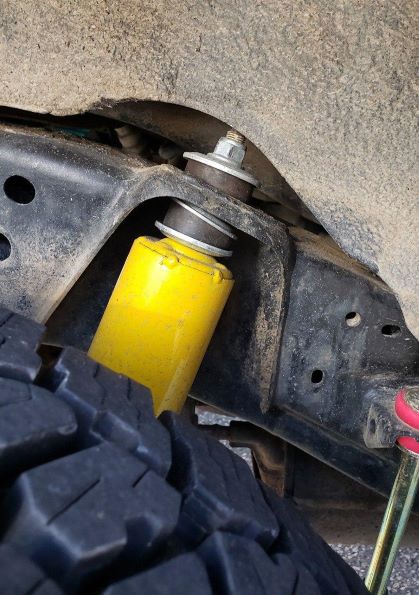

Does this look ok? Figured I'd ask here.
This is my third week since installing the lift (C59-314 / GS59-221 F, C59-505 / GS59-705 R). Seems great so far except there seems to be some harshness over things like speed bumps in the front. These came pre-assembled. Is there anything I can troubleshoot?
Struts look right.
Are the UCA's greased properly? And were they tightened down while the vehicle was on the ground under full vehicle weight?
If not, the bushings would be preloaded, causing harshness
Sent from my SM-G973U using Tapatalk
Struts look right.
Ok cool, was checking because the bushing doesn't look nearly as squished as other pics I've seen.
UCAs are nice and greased, wiped em all up each week as they started to seep. I could try tightening again - I think it was in the air iirc. I'm assuming you mean the UCA bushings? I also recently did my LCAs too shortly after the lift (frozen arms/bolts).
Now to find those UCA torque specs...
If Dobinsons assembled the struts, then they are correct. They look right to me.
The UCA bushings where the big long bolt goes thru. They need to be torqued on the ground.
Hmmm....the instructions on my UCAs had me torque them while off the ground and grease afterwards.
I can still try the UCA bolt (if I can get the torque wrench in there) - I'm pretty sure my new LCA cam bolts were loosened/re-tightened during the alignment (full weight on the rack) so that probably isn't it. Think it could be the sway bar?
Thanks heaps [MENTION=148378]Crikeymike[/MENTION] !
Is there a Dobinsons torque spec to the top nuts? They look all the way down and I've checked everything else - even took the sway bar off which helped a bit with the harsh rebound feel over speed bumps/steps. Maybe that's just the higher spring rate and I'm not used to it - that honestly might be it lol.
