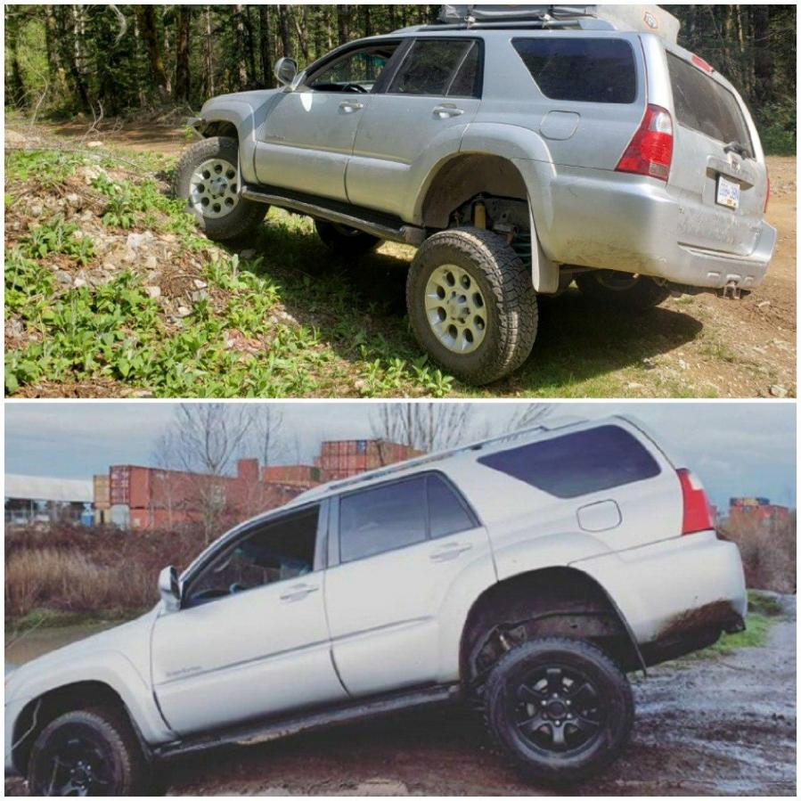

I didnt measure the travel, but I feel the difference when I am offroading, I hear atrac engaging less often. I have attached a photo comparing this setup (picture above) to the old one (5100 + 1.5 spacers + 30" tires). You can see how lower is the tire going judging by the top of the wheel and also can subtract another 1.5" due to the tire size difference.
I didnt remove the swaybars yet, for some reason I am not too comfortable with this idea for now, so I have put extended links in the front and in the rear.

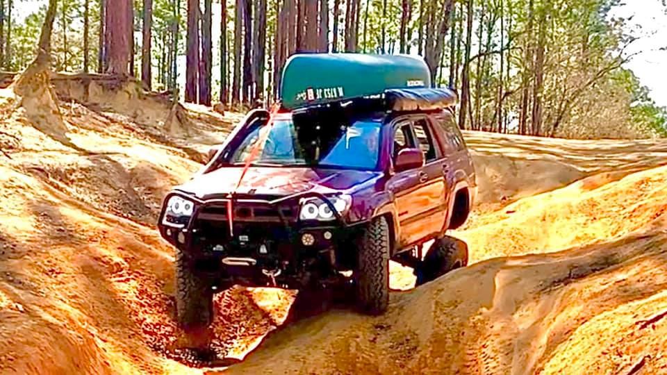

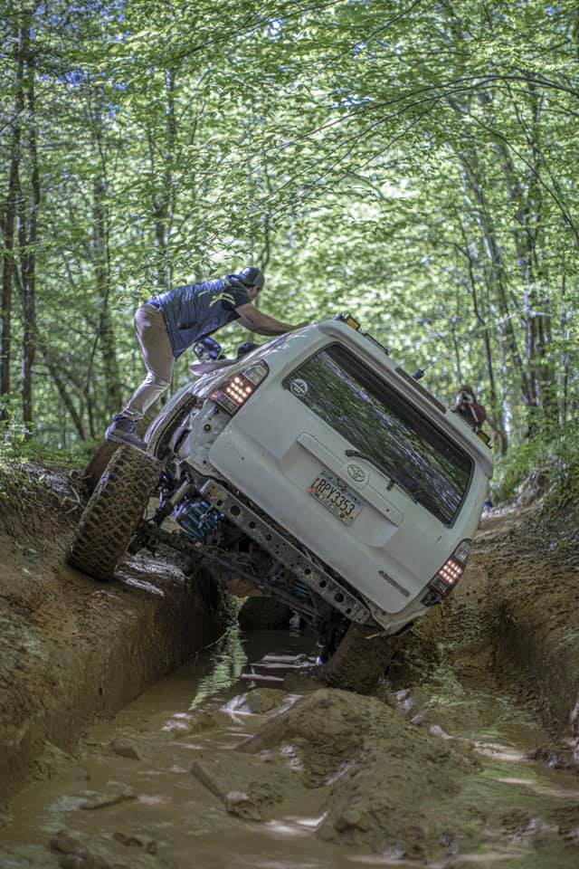

I am quite impressed with it as well but here are some pictures of what people can get without sway bars and that blows my mind %)

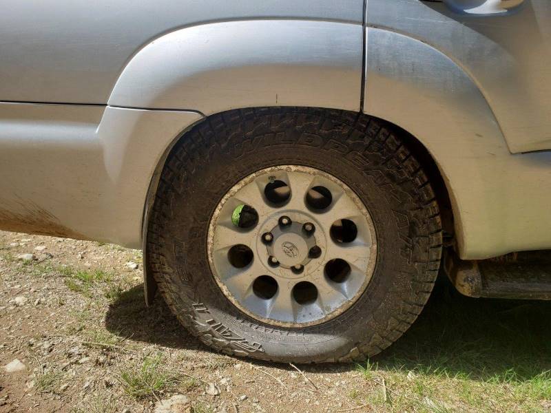

I will measure it later tonight. You dont have to get an aftermarket arms (although I got ICON rear links which are offset to gain a bit more flex) but you really HAVE to get extended brake lines and extended bump stops with this shocks. Even with the bump stop extensions my 33 are tucked pretty well I think but there is a thread on an fj forum that talks about doing LT without extending the stops. Google "flexy on cheap".
1 - photo of the tucked wheel
2 and 3 photo of some rad 4runners from fb page with same setup and no swaybars
