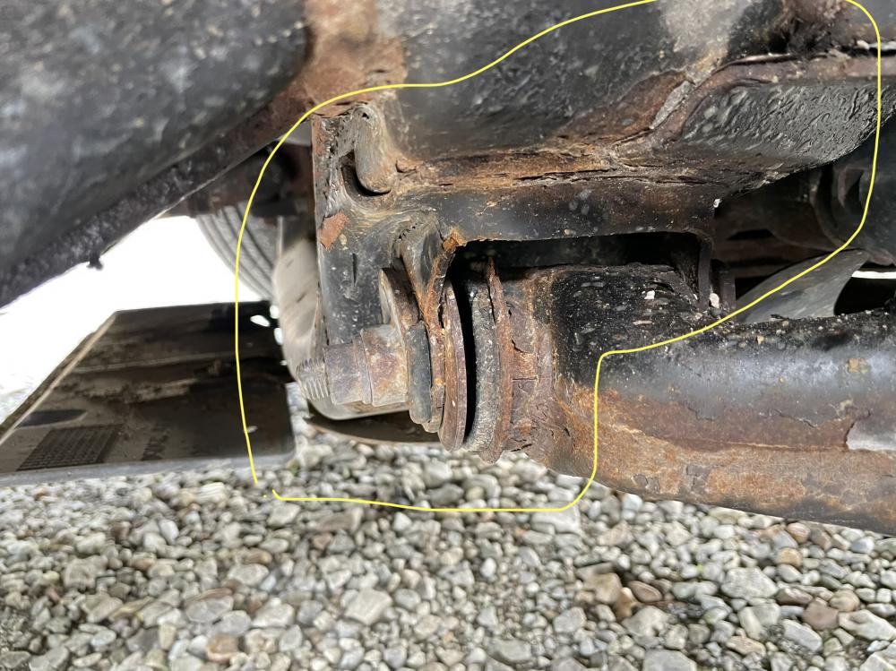

My Gfs ‘08 SR5 4th gen was a salvage we rebuilt. It was tracking weird and we found out frame/crossmember is tweaked. Looking for help identifying part. Hoping we can replace control arm/torsion bar bracket and straighten things out. Can anyone help me with what part number or name for this piece with the control arm clevis pin is attached to? Any help is greatly appreciated!

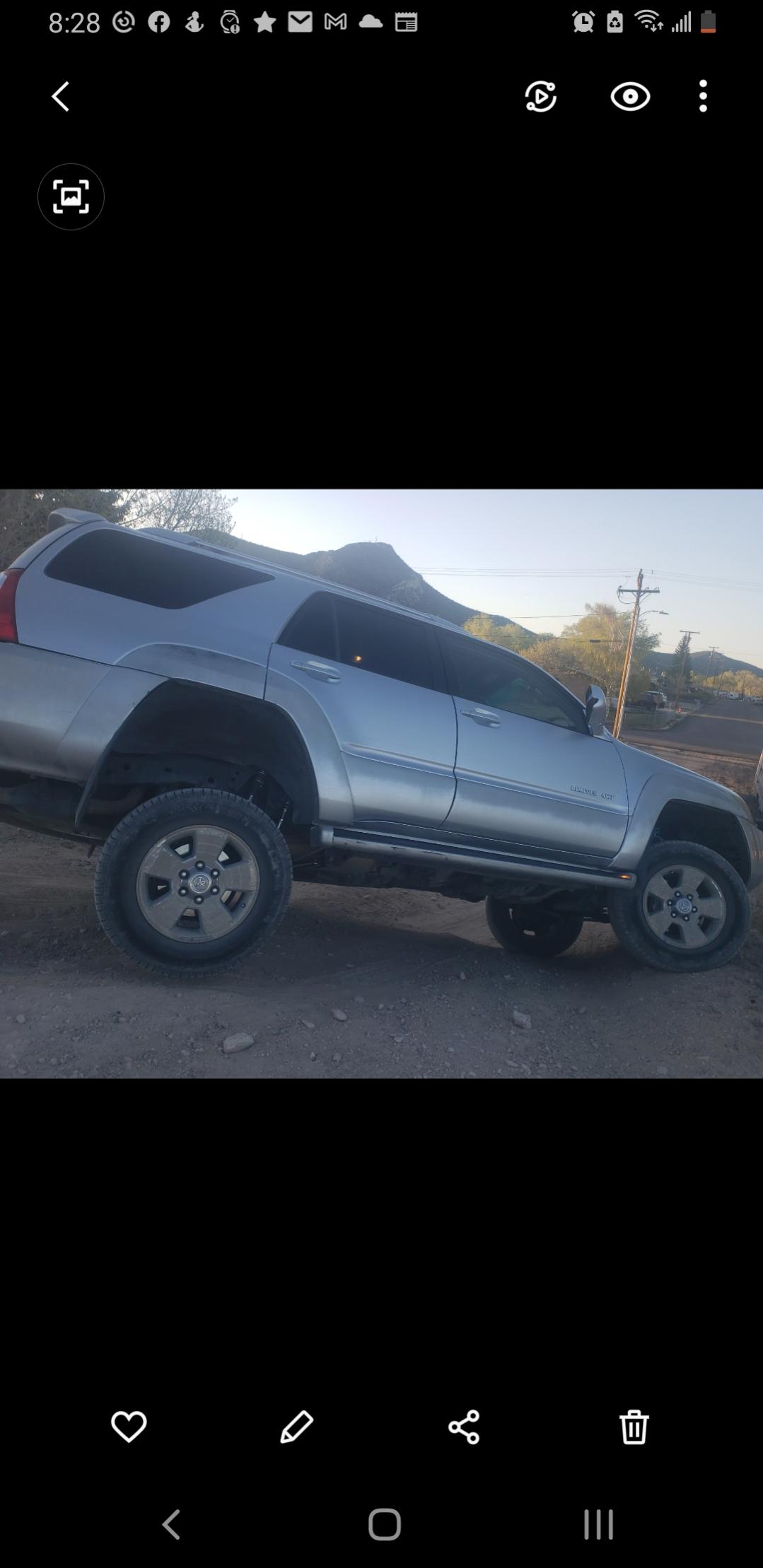

Hey Mike I just installed my lift Sunday and was wondering how much flex I should get. I don't seem to be getting much upward travel on the front end. I've tried posting a picture but it seems to be failing due to file size.
Spc uca
C59302
Ims50220
Rear
677v
Ims 50575
(Was told the rear set up will be the long travel set up)
I have rear link end set at 7.25"
Here's a picture on a slight hill. Rear tire off the ground not much droop or flex.

How much preload do you have on the front? If it's set for too much lift, that could be affecting your travel. And different obstacles will affect how the front flexes. The front can't flex like the rear since the coils are under so much pressure and rely on a lot of pressure to hit full compression.
The springs will also take a month and about 500 miles to break in and soften up too.
