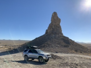

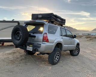

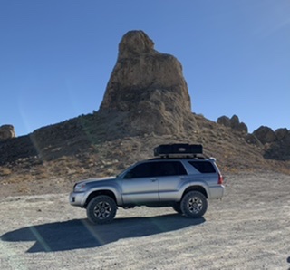

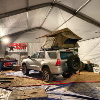

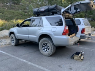

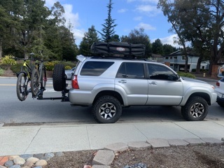

Finally got the time to get my new suspension on and test it out this weekend. Nothing but good things to say about the whole experience!
Front: GS59-220 with C59-296 springs, SPC UCA’s
Rear:IMS59-50575 LT shocks with C59-675V coils
285/70/17 tires
Great looking setup! Any chance you have any more pics? Especially of the truck sitting flat?
Finally installed!
Huge thanks to Mike for all the help with choosing the right set up for me. The customer service was great and shipping times were perfect as well. Was extremely knowledgeable and helpful with everything I needed and was even able to change my order on the fly. Can't thank you enough for helping me get my Truck looking just how I wanted it!
<blockquote class="imgur-embed-pub" lang="en" data-id="a/liyTgXH" data-context="false" ><a href="//imgur.com/a/liyTgXH"></a></blockquote><script async src="//s.imgur.com/min/embed.js" charset="utf-8"></script>
Thank you! Here are the best pics I could find, I have since built a spare tire carrier, the weight hasn’t changed the ride height much though. Sorry to flood the thread with my lame pics lol.
