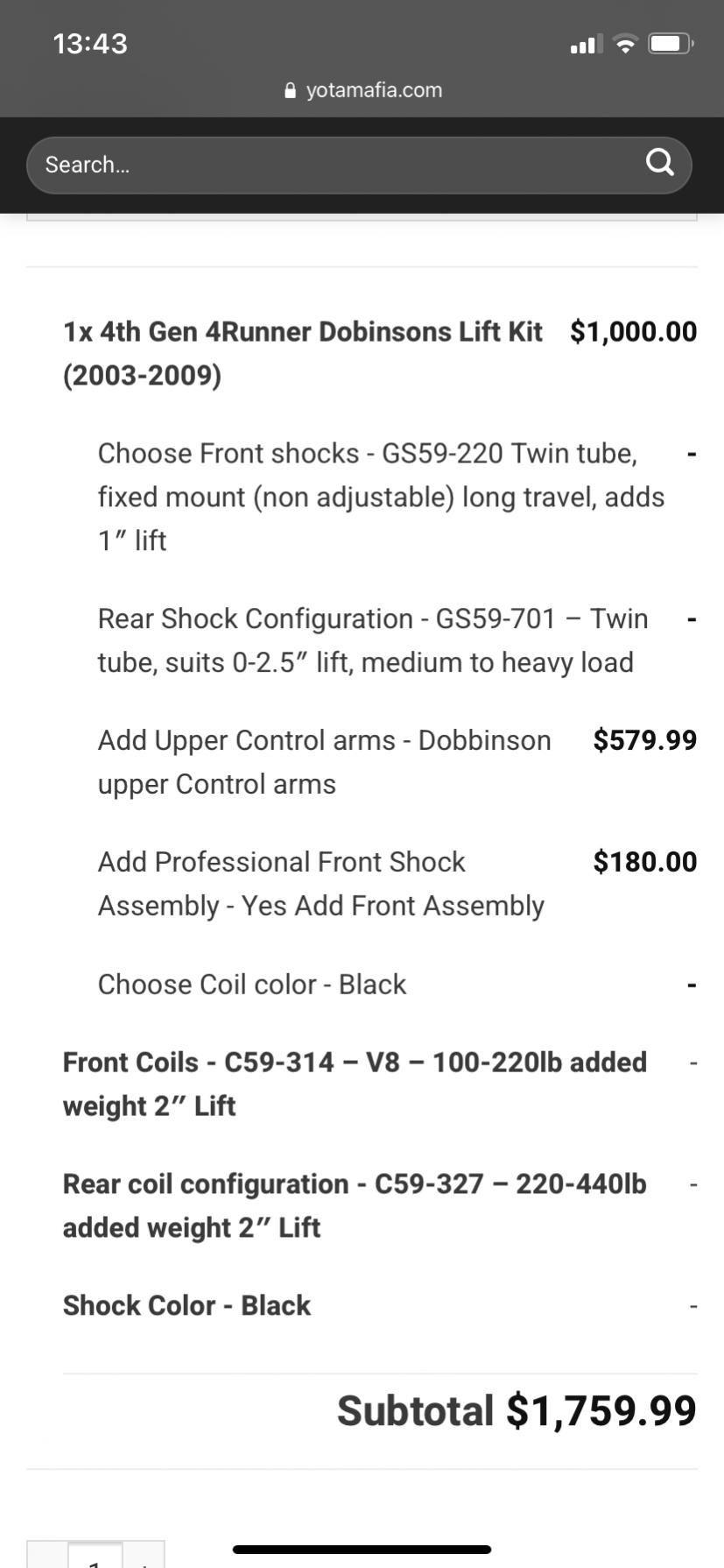

Hello, I'm looking to purchase a kit from someone who bought the kit directly from Exit Offroad and I'm hoping that you can help me confirm that these are the right part #s for my 2006 4Runner v8.
Here is what he has:
C59-302R
GS59-701B
GS59-220B
C59-327R
Any info that you can provide would be greatly appreciated! Also, would it be necessary for me to upgrade the upper control arms with this setup?
Post #1 of this thread will show you what those part numbers will give you, but to summarize, Yes, all of that will work. It will be 3" up front (yes, UCA's are needed) and those are the heavier rate rear coils, 2" of lift with 200-400lbs of weight, otherwise they'll give 2.5" of rear lift with stock weight.
The durobumps would actually work better to protect the shocks from bottoming out, so if you haven't bought any yet, those 4.25" would be ideal.
Or the Timbren's also cover it for the LT shocks and don't let the shocks bottom out.
sweet! Timbrens look awesome but way more exp. The duros dont compress so much that they will still bottom out the rear shocks?
Don't know, I don't sell Duro's so I don't know what their compressed length is. you'll have to ask them.
I talked with Durobump and they said that that 4.25" stops won't work with the Dob LT rear setup. They recommended the 5.25" stops which is new and not fully available yet. They sold me a pair directly so I will report back once I get everything installed.

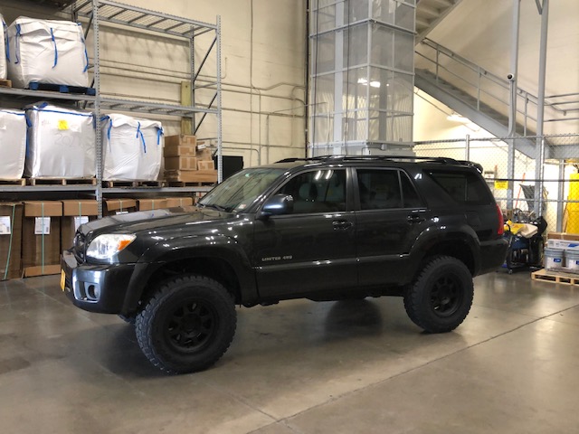

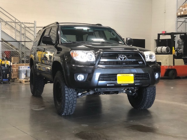

Here you go man, this is 2.5" front and 2" rear, right after install so it would have settled a little bit.
He's running these parts:
C59-314
GS59-221
C59-325
GS59-705
And here's where all of the options are broken down: Dobinsons 1" to 3.5" Lift Kit for Toyota 4Runner 4x4 2003-2009 (all options)
