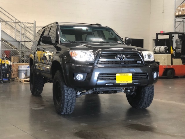

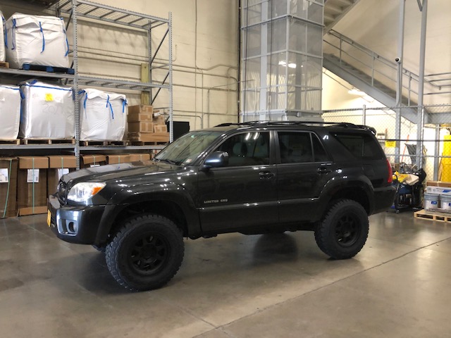

Here you go man, this is 2.5" front and 2" rear, right after install so it would have settled a little bit.
He's running these parts:
C59-314
GS59-221
C59-325
GS59-705
385062d1626964069-dobinsons-suspension-4th-gen-options-v8-314-221-325-701-255-80-17-d-jpg
385061d1626964058-dobinsons-suspension-4th-gen-options-v8-314-221-325-701-255-80-17-c-jpg
And here's where all of the options are broken down: Dobinsons 1" to 3.5" Lift Kit for Toyota 4Runner 4x4 2003-2009 (all options)

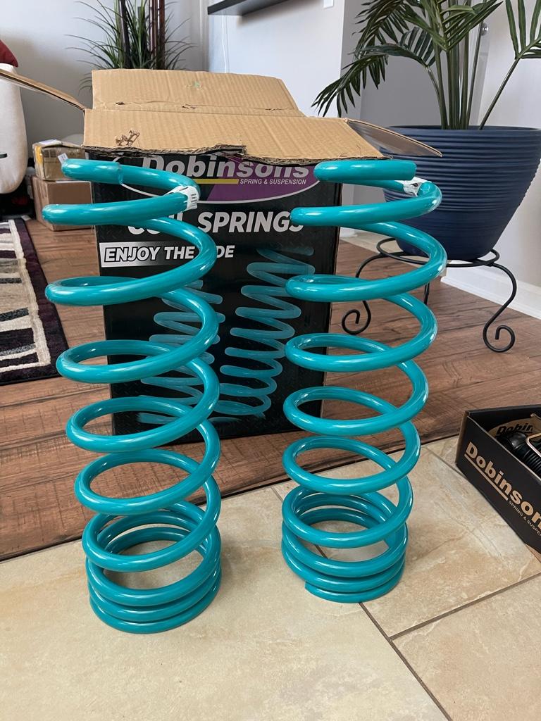

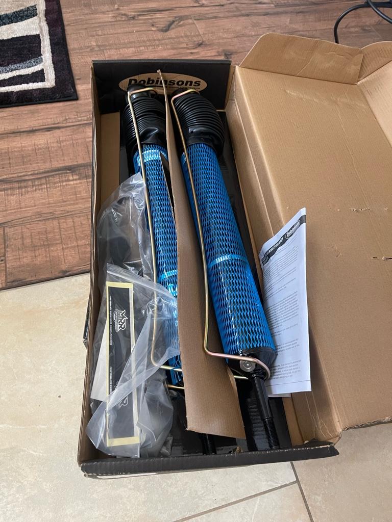

After reading through some of this thread I decided to dive right in and go with a set of Dobinsons IMS59-50575 long travel shocks for the rear along with the C59-749V extreme springs. I'm running a drawer system that is probably close to 300lbs, along with a costal off-road, dual swing out bumper, 35" spare, roof rack with a 250lbs hardshell tent pretty much full time so I would say if anyone is carrying 700-800 lbs added weight it would be me lol.
Now the only question is are both of these part numbers actually in stock and ready to ship ?? :) :) Because I certainly can't wait to get these on and see what kind of added travel I can attain :)
Oh yeah, you'd need those heavy springs for sure!!
The shocks are in stock:
Dobinsons IMS59-50575 IFP LT Rear Shocks 4Runner FJ Cruiser GX470
The 749V's are only in stock in red right now:
Dobinsons C59-749V Rear Extremely HD Long Travel Coil Springs
No ETA for black, teals are coming in February.
Don't forget sway bar links, brake lines, and bump stops too at a minimum to run those shocks.
Ah, glad I asked then! :) The website did show some items as out of stock under certain colors but the spring color for these didn't trigger any messages so I just left it as teal. I certainly don't care for any color over the other so if red is the only in stock, red is what I'll take haha. I just sent an email with my order number attached seeing if I can get it switched over to whatever color spring is available.
thanks for the response on this, definitely looking to getting this on the rig!
Dobinsons really outdid themselves.. the shocks and springs are already delivered and on the car as of an hour ago. Everything went on smooth and fast, and first impression is really good. Now to put it through some flex testing

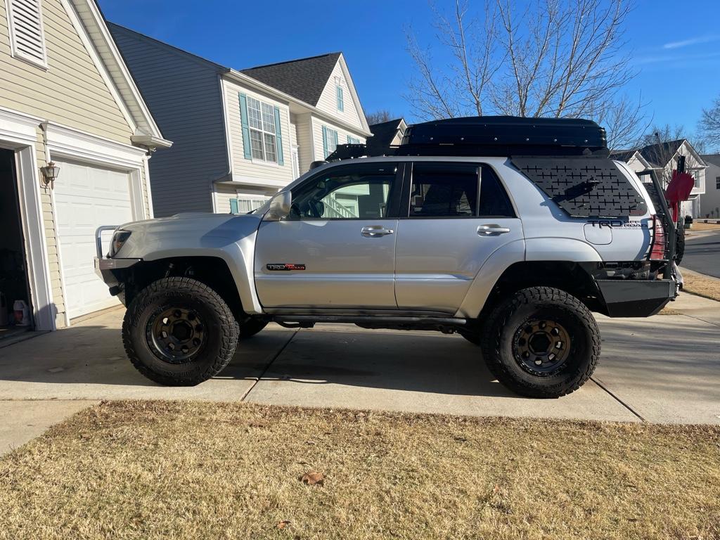

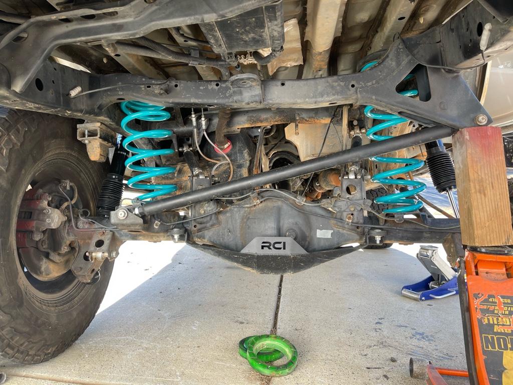

In case anyone else needs some Long Travel inspiration for the rear :) easily picked up at least 2 inches of down travel and an inch of up travel over my last setup. Now to sort out my bump stop situation and I’ll be good to go.
Just curious.. is there a measurement of how much shock tube should be exposed at full bump ? My bump stops won’t work since I have my axle slid back almost 2 inches so I have to weld new mounts and wanted to make sure I get them as close to full compression as possible without bottoming out the shock but also not losing any up travel
Awesome flex!!!
The bump should start contacting with about 1" of shock shaft remaining, but it depends how soft the bumps are and how much they compress under load. You'd almost have to remove the coils and bottom it out to see when the shocks bottom out, and then put in the bumps to see how much they compress under the full weight of the vehicle to try and get a baseline. All of that isn't quick to do though.
