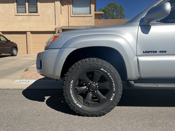

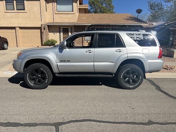

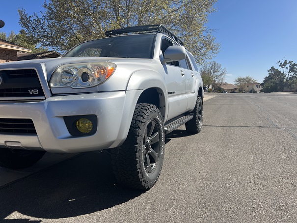

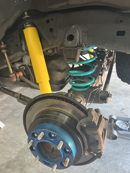

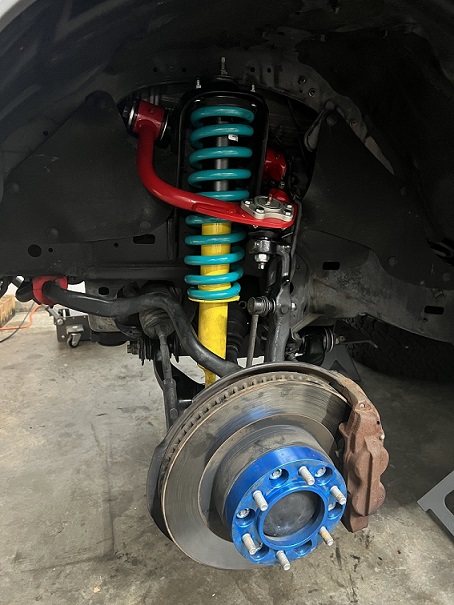

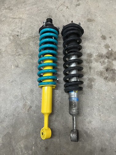

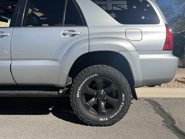

I received everything from Exit Offroad early last week (fast shipping!!) and was able to install everything at home this weekend. The pics and measurements below are after about 30 miles of driving so things could still settle a bit. Here is the list of goodies:
FRONT:
GS59-220 struts (1" lift)
C59-300 springs (1.5" lift)
1/4" spacer installed on left front
REAR:
GS59-705 shocks
C59-505 springs (1.5" lift)
Measurements:
Left Front = 22.5" (with a spacer....the lean is REAL people!)
Right Front = 22.75"
Left Rear = 22.75"
Right Rear = 22.75"
The ride is ridiculously good and a huge improvement over my tired old setup of Bilstein/OME/Toytec bits that have been on for about 6 years. The small, sharp bumps that used to kill my kidneys are still noticeable but nowhere near as harsh. Everything feels very solid and planted. Cornering has improved with a noticeable decrease in body roll.
I was hoping the rear was going to be a bit higher (my Toytec Superflex's measured at 23" so it came down a bit with the 505 springs) so if it settles much more, I think I will be installing Dobinson's 15mm spacers on both sides. I think the rear spacers would put me between 23" and 23.5" depending on settling.

That looks great!! You wasted no time in getting it installed!!
