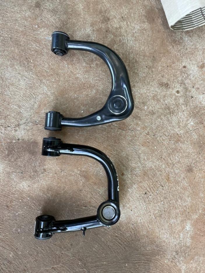

Mike, how much more clearance from the tire do I get with the tubular or billet UCAs vs OEM. Can you get me a measurement from the center of the ball joint to the edge of the UCA? I’m thinking only a 2-2.5” lift so I don’t need a lot of caster. Wondering if the billet ones could be dialed in for just an extra degree and not 3?
I measured them earlier in the year and the 2 Dobinsons arms are almost the same. The wall thickness of the tubular arm is 5mm beyond the edge of the ball joint. I think the billets were about 7mm.
I think the factory thickness is like 1/2" or more from memory.
Here's a photo comparing factory to the tubular arms.
