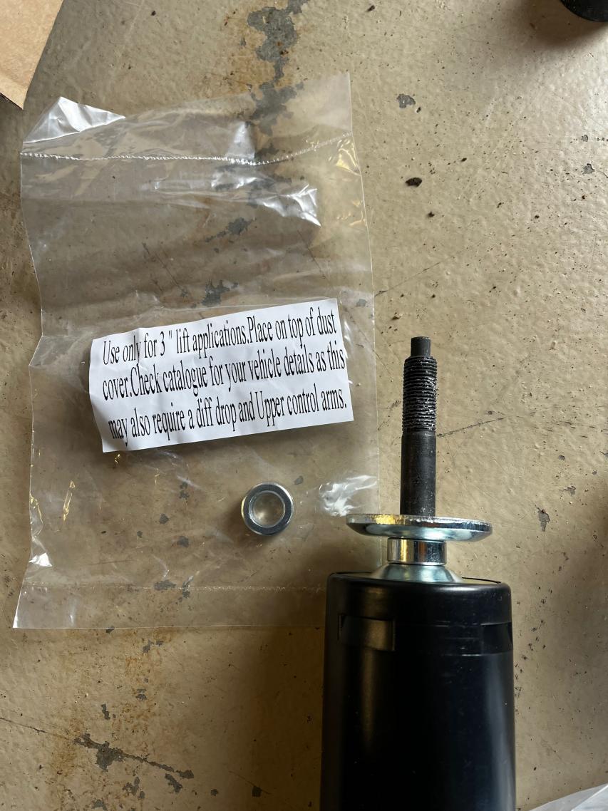

Is anyone running the GS-220 long travel front struts? If so I could use your help (especially if you assembled them yourself).
I'm currently assembling them myself and saw that in the box they came with a little extra spacer in a plastic bag that said to place on top of the dust boot if you want 3" of lift or more (I don't). My goal is 2.5", 1" from LT struts and 1.5" from coils.
However, when prepping for assembly I noticed that there is one already on top of the dust boot (see pic).
My concern is that I don't want the extra lift from that spacer. So was that spacer already installed from the factory by mistake? Should I leave it on or take it off to get the desired 2.5" lift?
Thanks for the help as I'm halfway through the install already!
That's a droop spacer, adds more droop/down travel. You don't have to install it, just take it off.

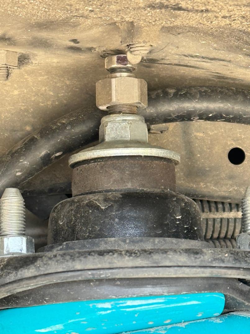

Calling all Dobinsons gurus… ( [MENTION=148378]Crikeymike[/MENTION] )
Just had MRRs installed and am thinking maybe they need to be tightened more? The top hat bushing seems relatively uncompressed and the rebound adjuster is practically making contact with the wheel well. Any input based on this image? Can provide more pictures but am having technical issues with the site at the moment so getting one up is a win.

Yeah, those top bushings are not tightened down far enough. It will gain more top clearance once those are properly tight.

Is there a torque spec and procedure or just crank them down?
I leave with the family on a long road trip tomorrow and will not be able to get back to the shop that did the install as they are out of town a bit.

You can try turning the lower nut in that photo, but most likely the shaft will spin. The top adjuster has to come off so that an allen key can go in there. The shop really had no clue what they were doing, plus they came with manuals showing all that.
