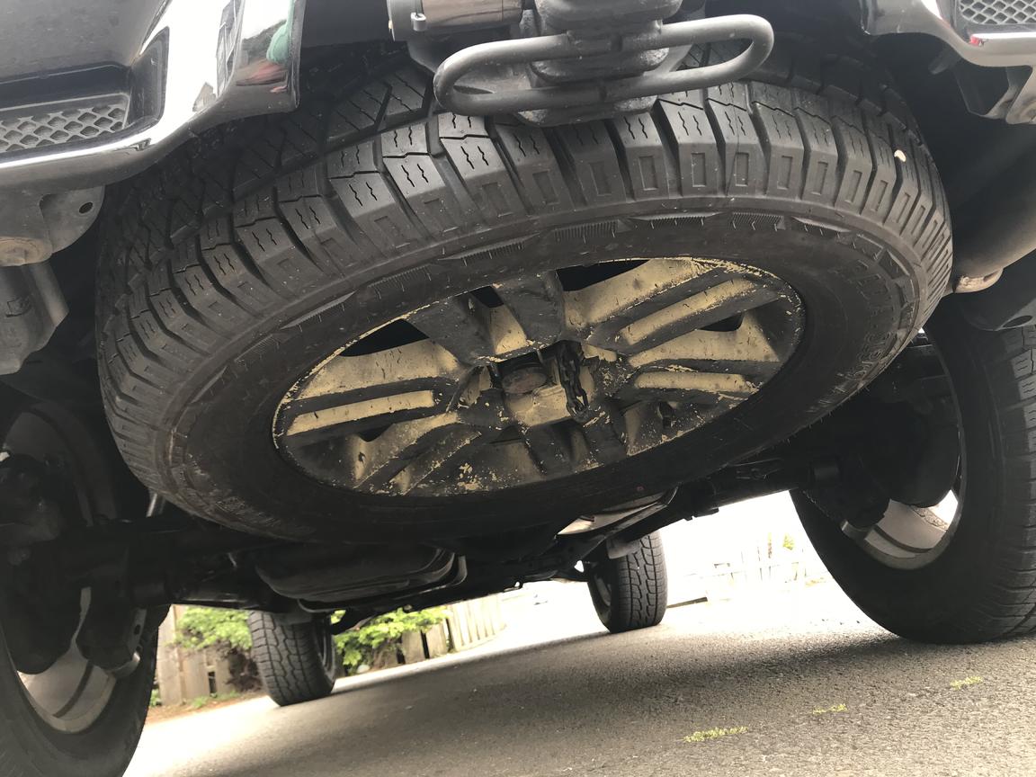

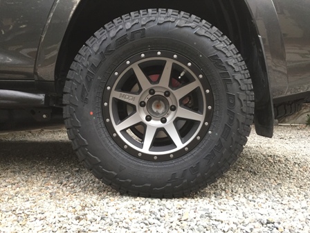

I put Falken AT/3W LT285/70R17 on 17x8.5" ICON Rebound rims and the spare wheel and tire fit below in the spare tire location. It hangs down about 2 or 3 inches below the trailer hitch right in front of it.
I think I need a thin plate, maybe 1/8" thick steel to guard the spare from scraping. I've scraped the trailer hitch a few times on the trails. I may get a large square piece of steel and put a few bolt holes in it and then bolt the plate to the rim through the lug nut holes before lifting the spare up.
I just finished a 2" to 3" lift so it's off the ground more, but I'll probably still scrape the back side once in a while.

You can see my new full size spare tire in my post above. I wasn't trying to photograph the spare, but it's there.
Yes it will fit. I cleared a 285 Cooper STT Pro in the stock location and I have KDSS. Wasn't a ton of room but I cleared the sway bar. Had it mounted on the factory steel wheel.
I'm getting cooper STT pro's as well. Going this route for spare wheel too. Was trying to find someone with the same setup. Thanks for the info!
I know that this is an older thread, but I wanted to chime in and say that my 285/70/17 Nitto Terra Grappler G2 fit in the spare spot.
It is pretty important to make sure you have a spare on the vehicle that is the same height as the tires on your other wheels (especially on the drive wheels, and since we are often in need of a spare offroad, we need to make sure that they all match). Thankfully, if you go 285/70 you can still fit! It sticks down a bit more than the stocker, but not too bad.

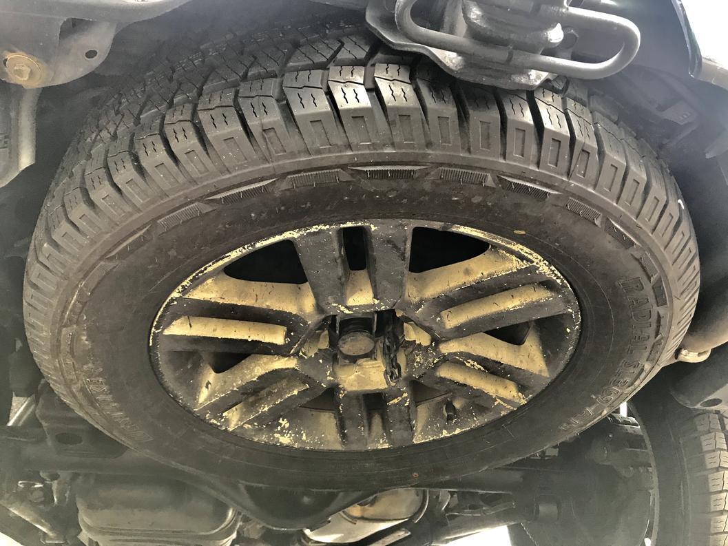

Can you post more pics of your spare and the ground clearance you have? I have SCS Ray 10’s 17x8.5 and Falken AT3W 285 70/17 tires and I am debating between another month of eating Ramen so I can get the CBI bumper or just through the full size spare under the rig...
I have the 6112/5160 with 2” rear icon springs so I should have the same clearance as you do.
The size you are asking is only .4” wider and .3” smaller diameter than the 275/60r20 on my le and it fits fine, I won’t be doing much hard wheeling so striking rocks/objects is not a issue for me. I’m on TRD Pro suspension with taller/stiffer front springs only
